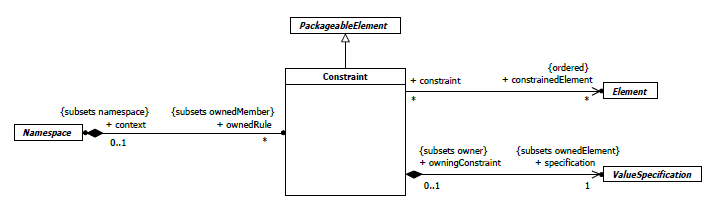

Figure 7.6.2 in [UML 2.5] defines the syntactic element Constraint as follows:
index.php/fa/29302/0/
  1. constrainedElement: the ordered set of elements referenced by this constraint.
  2. specification: a condition that must be true when evaluated.
  3. context: specifies the namespace that owns the constraint.
The association A_ownedRule_context (see section 7.9.22 in [UML 2.5]) ends both subset ends of the association A_ownedMember_namespace (see section 7.9.19 in [UML 2.5]).

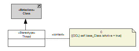

The interest of the association A_ownedRule_context seems to enable the designer to explicitly define "the Namespace for interpreting names used in the specification (for example, in OCL self is used to refer the context element)" see section 7.6.3 in [UML 2.5]. Based on this, in Papyrus self always evaluates on the specified context.
index.php/fa/29303/0/
For instance, in the above figure, C has Thread for context (which means that Thread owns the constraint C) and Thread is referenced in the list of constrained element. In such configuration, the constraint C specified with OCL evaluates to true.
Now if we change the context (e.g., to store our constraints in a Constraints package) then C is owned by that package while still constraining Thread. At this point the validation of the constraint fails due to the update of the context. While the evaluation of self to the context (i.e., the Constraints package) conforms to what UML specifies, it does not look to be the correct behavior to the final user since the constrained element did not change.
