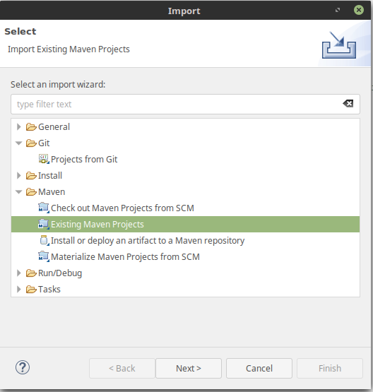

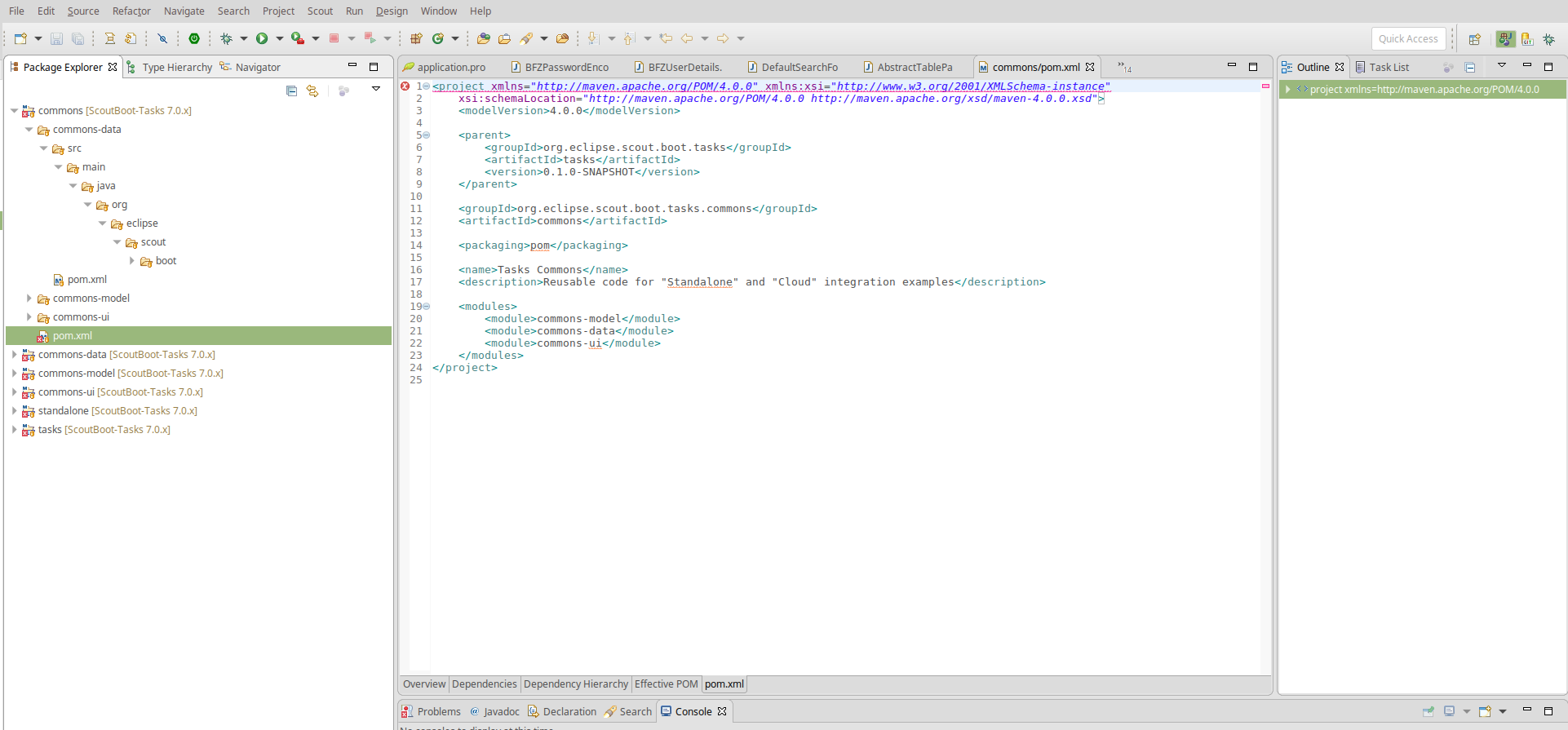

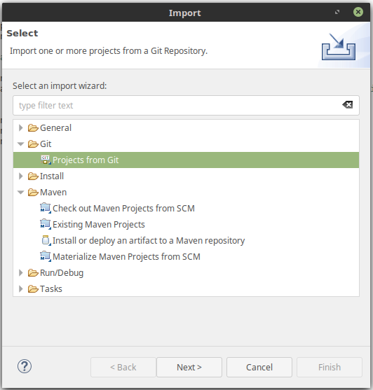

Hi there,
I did try the same. But I didn't manage to import the projects correctly I guess, since the structure in my Package Explorer view doesn't not look like, if these projects are registered as Java/Maven/Scout projects:
index.php/fa/29027/0/
First I tried to import it with:
index.php/fa/29028/0/
Then it says, that there are no projects found.
In my next try it did this:
index.php/fa/29029/0/
There I chose the root directory "ScoutBoot-Tasks" and imported everything, which then led me to my project layout above.
Furthermore I always get the error message
Project build error: Non-resolvable parent POM for org.eclipse.scout.boot.tasks:tasks:0.1.0-SNAPSHOT: Could not find artifact org.eclipse.scout.boot:scout-boot:pom:7.0.0-SNAPSHOT
 and 'parent.relativePath' points at wrong local POM
What did I do wrong?

Re: ScoutBoot-Task: How do I start from Eclipse IDE [message #1759534 is a reply to message #1759473] Wed, 12 April 2017 11:34 Go to previous messageGo to next message
Yes this is exactly what I meant with "I had to set and modify the Eclipse metadata manually". I think that the Eclipse Importer is somehow broken with this project. I had to modify the ".project" and some of the ".classpath" manually. I have also added some ressouces filter to avoid duplicate display of the subfolders that are also projects.
I will try to push all the metadata you need in as a commit (in the main repository or on a fork). Probably tomorrow.
