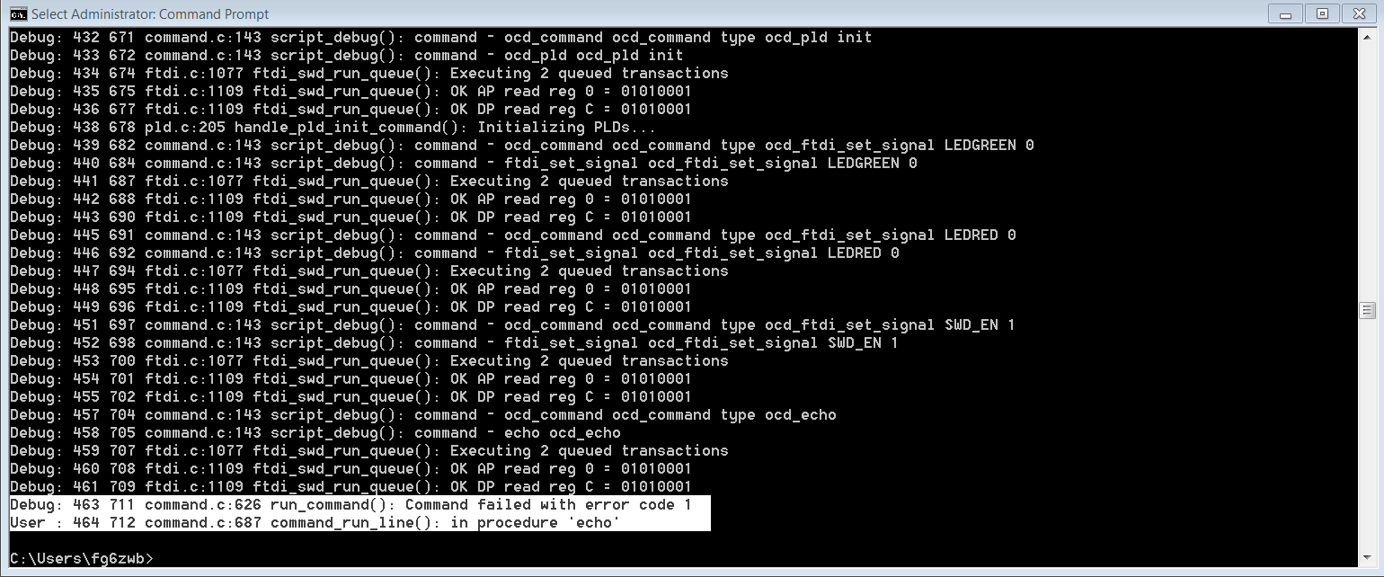

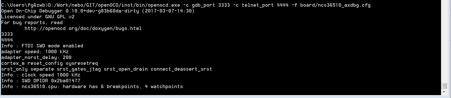

I have setup openOCD debugging plugin from GNU ARM eclipse website. I have made all the necessary changes in the openOCD Debug configuration. My project builds fine using a makefile. I have a problem launching the debug configuration.
The error says "openOCD failed with code (-1073741515)". Error log displays the command which was run in the debug configuration. When I copy and paste the command used in debug configuration on a Windows command prompt, it throws an error saying "error in procedure echo".
When I remove the part of command "-c echo "Started by GNU ARM Eclipse"" on the command prompt, I am able to run openOCD and debug the application using command line.
However, I would like to use eclipse to debug the application, and it looks as if the "echo" option is the one causing the problem.
Can you please tell me how I can remove the echo command in the debug configuration launch file?
Here are the snapshots of the errors.

-1073741515 is the decimal representation of Windows error 0xC0000135 (STATUS_DLL_NOT_FOUND).
It means that a DLL couldn't be found.
https://msdn.microsoft.com/en-us/library/cc704588.aspx
Don't use openOCD myself but that should get you started.
