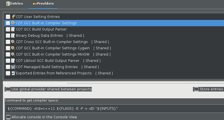

http://help.eclipse.org/neon/index.jsp?topic=%2Forg.eclipse.cdt.doc.user%2Freference%2Fcdt_u_prop_general_sd_entries.htm
These are the providers I normally use.
It may not be obvious but only the first three are checked. I've selected the builtins provider to show its parameters.
Selecting a GCC provider will automatically use GCC as the compiler.
index.php/fa/28558/0/

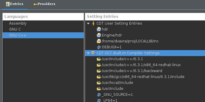

Here is a partial of how they look on the Entries tab:
index.php/fa/28559/0/

I'm a little closer again. Found out that $COMMAND was empty.
Therefore GCC Built-in Compiler Settings was empty on the Entries tab unlike in your picture.
I wrote
${COMMAND} mpicxx -std=c++11 ${FLAGS} -E -P -v -dD "${INPUTS}"
instead.
Now most functions are recognized.
What should "COMMAND" actually be and where to set it?

Since GCC Builtins Settings was selected it will be something appropriate to gcc.
You can override it (by replacing the $(COMMAND)) but whatever is used has to provide output similar to gcc's.
I guess it should be something appropriate but in my imported project its empty. Which leads to the following error:
