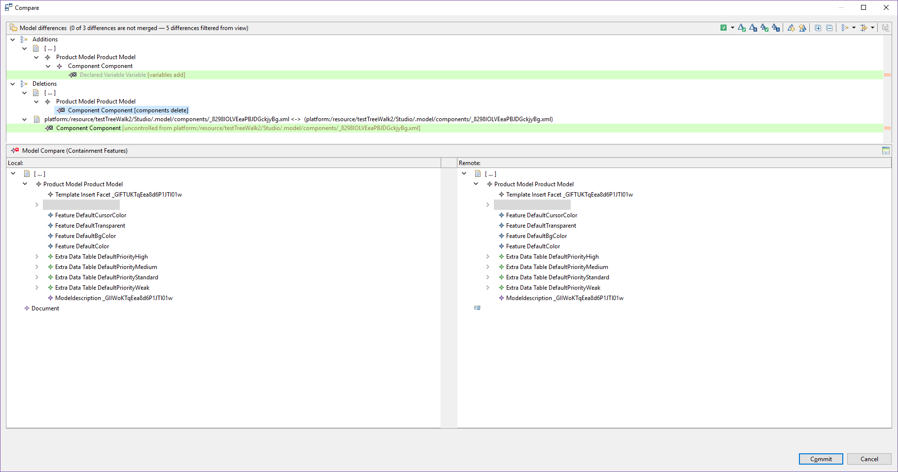

I am using EMF Compare to handle model merging in my own EMF-based application and I have encountered a problem in the UI when merging conflicts.
In the picture below you can see the conflicts I'm looking at:
index.php/fa/28366/0/
What basically happened, in this case, is the following:
1. On the remote, a Component has been deleted;
2. Locally, a Variable has been added to the same Component which was deleted remotely. (in our ecore model, Variables are contained in a Component)
This, of course, resulted in a conflict.
What I don't understand is how are the relations between these 3 differences shown as conflicts created?
In the background, the difference selected in the picture above only has the ResourceAttachmentChange in the implies list but its acceptance also seems to influence the addition difference. Why is that and where could that relation come from?
Moreover, even though the UI shows that accepting the currently selected difference will accept the 2 others as well, what happens in the background is that both the Addition and the ResourceAttachmentChange are rejected.

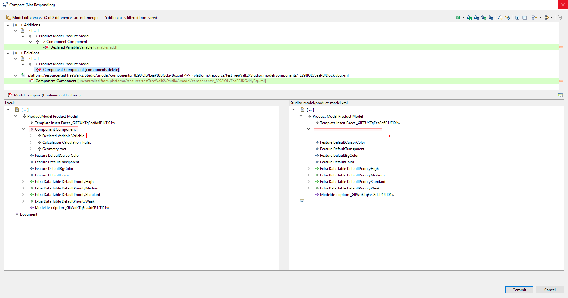

Last but not least, even after accepting the selected difference, the UI shows the reject 'x' sign on all differences, see the picture below:
index.php/fa/28365/0/
So it seems like the UI and input are somehow not in sync?

Hi Monica,
You have three differences
  • Left: variables add
  • Right: components delete, "uncontrol" of component
The conflict is between left variables add and right components delete
There is a relationship between right components delete and right "uncontrol" of component, because the deletion of the component entails the "uncontrol", if the component is a root element in its resource. I don't know by heart, but I guess, the resource attachment change should show up in the requiredBy list of the reference change. As a background info, the requirement-relationships are defined by the org.eclipse.emf.compare.req.DefaultReqEngine.
If you now accept the components delete, you'll automatically accept all its requirements and reject all its conflicting diffs on the opposite side (which is the addition of the variable in this case).
Yeah, I'm pretty sure there is a bug that the colors of the consequences are wrong. It'd be great if you could post your (or a simplified) model comparison scenario (the three models), to reproduce the wrong colors of the consequences. Conflicting diffs should show up with a red background color and not a green one.
I'm afraid, this is a bug too. But at least it is known and there is already a patch on its way (see https://git.eclipse.org/r/#/c/90181/).
Hope that helps,
Philip

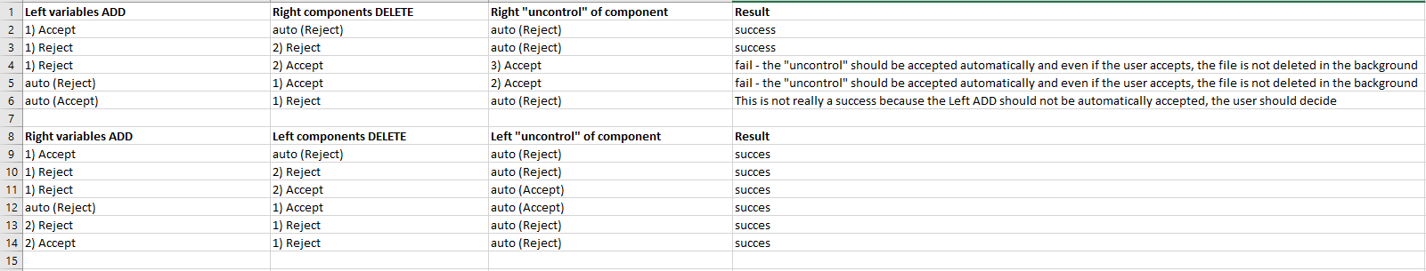

I tried to explain all the tests I made and the behavior I experienced in the table below.
-the numbers show the order of the actions performed by the user
-auto means a difference was accepted/rejected due to a user action
