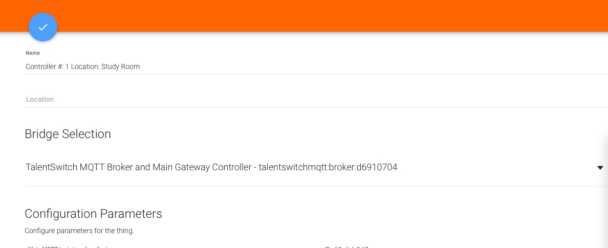

I am building my own binding and able to display all the discovered things in Paper UI inbox. It seems that in recent builds, there is a location field.
Anyone has any idea how to populate this field programitcally via custom binding? Following is the code that i use in my custom binding:
uid = new ThingUID(THING_TYPE_UID_TOPIC_THING, "device_" + strControllerId);
properties.put("topic", "device");
properties.put("deviceId", Integer.parseInt(strControllerId));
properties.put("location", strLocation);
discoveryResult = DiscoveryResultBuilder.create(uid).withProperties(properties)
.withRepresentationProperty("device_" + strControllerId)
.withLabel("Controller #: " + strControllerId + " Location: " + strLocation)
.withBridge(bridgeHandler.getThing().getUID()).build();
thingDiscovered(discoveryResult);

AFAIK there is no mechanism to propagate the location to the discovery result.
The location could be set on the thing later.
