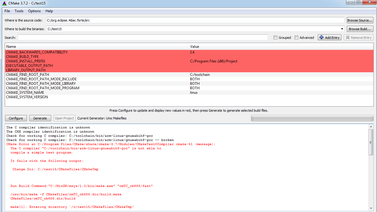

I am trying to build forte for Raspberry SPS. I followed as in the tutorial but still am getting errors. What could be the problem?

this is strange. It looks as there is some issue with your cross compiler. Could you be so kind and post the full output of CMake into a text file and attach it here?
BTW. I just saw that you selected the wrong directory for the "Where is the source code" it should be the main FORTE directory. In your case C:/org.eclipse.4diac.forte.

I suspect that it is some kind of compatibility problem, but unfortunately I was not able to fix it.
I have 64bit Windows and have used following Linaro toolchain:
https://releases.linaro.org/components/toolchain/binaries/latest/arm-linux-gnueabihf/
gcc-linaro-6.2.1-2016.11-x86_64_arm-linux-gnueabihf.tar.xz

hi, as far as i can see, you're trying to run linux compiler on windows. please, download the mingw32 toolchain from https://releases.linaro.org/components/toolchain/binaries/6.1-2016.08/arm-linux-gnueabihf/gcc-linaro-6.1.1-2016.08-i686-mingw32_arm-linux-gnueabihf.tar.xz
the other issue might be that you should unpack the archive as administrator, otherwise it might prevent creation of symbolic links.
hope, this will work for you.

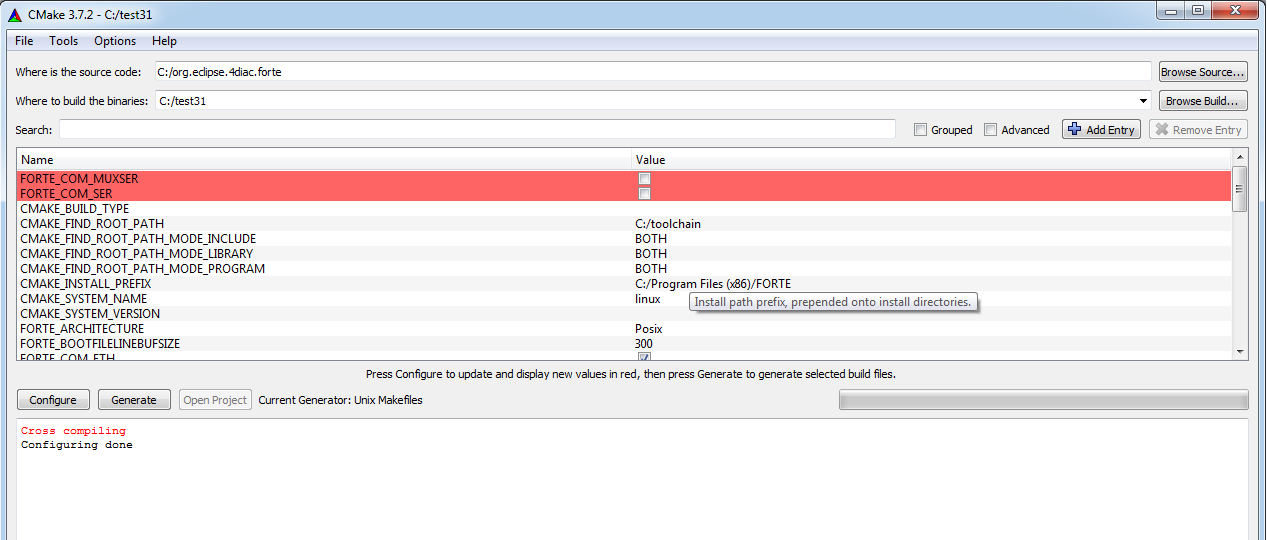

Thank you for reply. It helped a lot.
The one thing also to mention is to run all programs as adminstrator (cmake, gcc, g++).
During configuring in cmake I got two red lines. In tutorial it says that there shouldn't be any of them, but if I check them some errors appear during make. I left them unchecked and it worked well, I hope it will run properly in Raspberry SPS as well.

The read lines are perfectly ok. They are coming as with checking some modules or architectures it can be that new options are getting available. Therefore you can find in the documentation that you should hit configure as long as you don't get new red lines and then finally generate.
