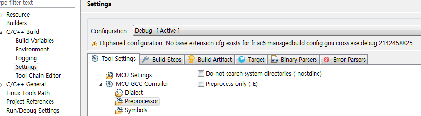

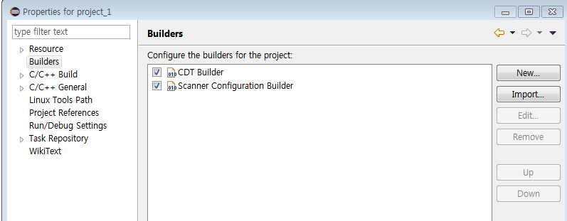

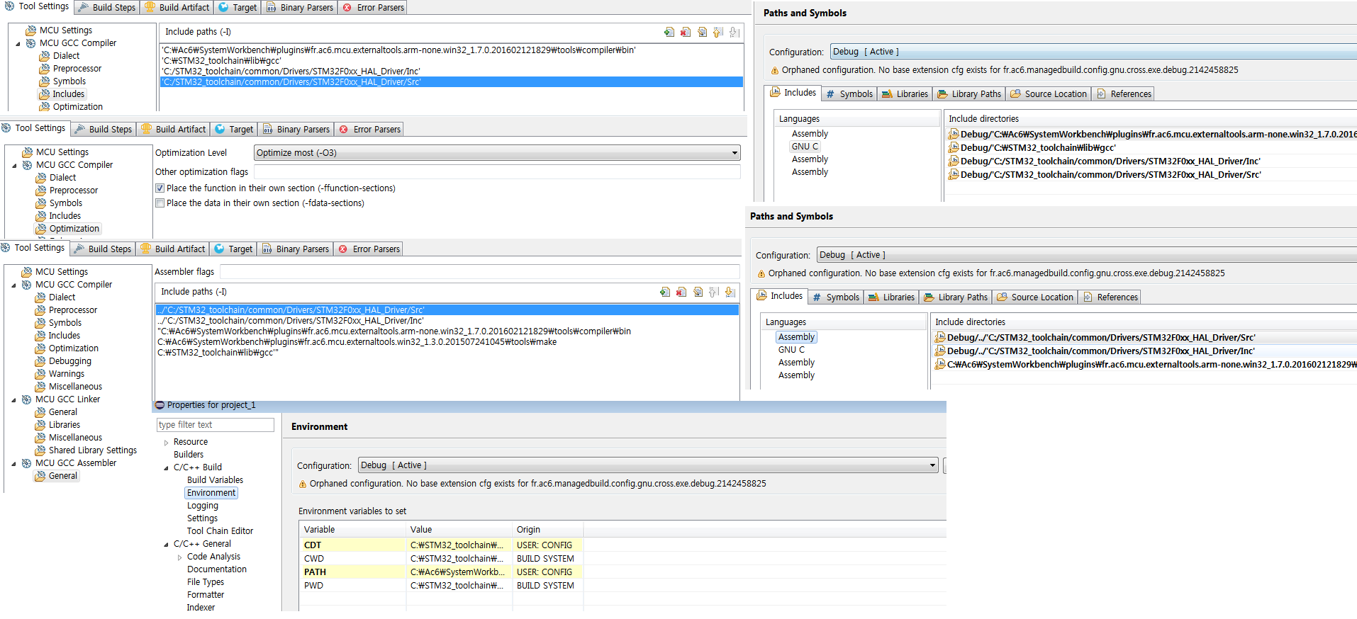

For the project properties setting, kindly take a look on my image file.http://

Not 100% sure based on info you have provided, but besides the bad rendering of characters in the settings (which I assume is a display issue, please file a bug https://bugs.eclipse.org/bugs/enter_bug.cgi?product=CDT) it is hard to see the problem.
It says that stm32f0xx_ll_utils.h is not found, but is it in any of the directories supplied?
C:\\Ac6\\SystemWorkbench\\plugins\\fr.ac6.mcu.externaltools.arm-none.win32_1.7.0.201602121829\\tools\\compiler\\bin
C:\\STM32_toolchain\\lib\\gcc
C:/STM32_toolchain/common/Drivers/STM32F0xx_HAL_Driver/Inc
C:/STM32_toolchain/common/Drivers/STM32F0xx_HAL_Driver/Src
Additionally, as you appear to be using a commercial third-party set of tools, you should also consider contacting them for support: http://www.ac6-tools.com/

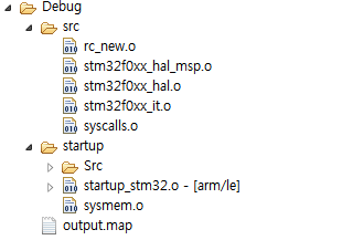

Do you want me to delete these files,
http://

In Debug folder all output files are exists, the question is does the logfile changes rightly after clean the project at C:\STM32_toolchain\Workspace\.metadata\.plugins\org.eclipse.cdt.ui\project_1.build.log/

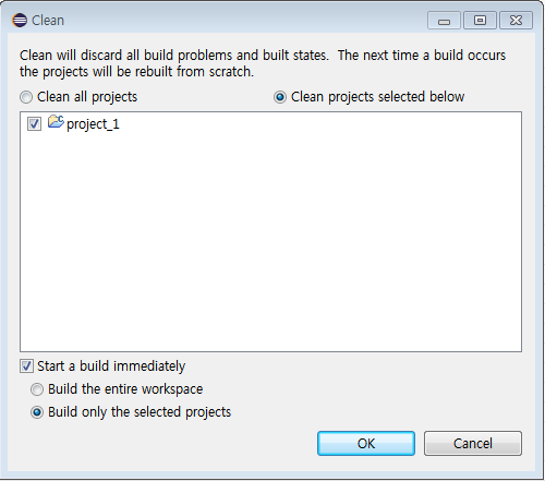

Re: Can you recognize the actual errors [message #1749772 is a reply to message #1749661] Sun, 11 December 2016 23:23 Go to previous messageGo to next message
]Dear Sir Vavra,
After deleting the debug folder I did clean the project in this way,
Project>clean ...the window came ,

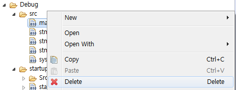

Then delete the object files by hand. In fact, you should be able to delete the entire Debug folder as Jonah suggested. It will be recreated at the next build.

Re: Can you recognize the actual errors [message #1749774 is a reply to message #1749773] Mon, 12 December 2016 00:45 Go to previous messageGo to next message
Thank you sir.
Do you want me to delete these files?
index.php/fa/27832/0/
After this folder the startup folder also contain object files.
Do you mean delete each file in this way?
index.php/fa/27831/0/
In project properties builder is having in this condition,
index.php/fa/27833/0/
[Updated on: Mon, 12 December 2016 01:10] by Moderator
Re: Can you recognize the actual errors [message #1749776 is a reply to message #1749774] Mon, 12 December 2016 01:18 Go to previous messageGo to next message
Dear Sir Vavra,
After delete by hand the build log changes.
Take a look this attachment in form of text file.
Hasan
  • Attachment: build_log.txt
    (Size: 53.48KB, Downloaded 249 times)
Re: Can you recognize the actual errors [message #1749792 is a reply to message #1749776] Mon, 12 December 2016 06:00 Go to previous messageGo to next message
No object files are being produced because you have the -E option in the compile command line.
This option says to output only the preprocessor results.
The output files have a *.o extent but are actually text files instead of object files.
https://gcc.gnu.org/onlinedocs/gcc-4.1.0/gcc/Preprocessor-Options.html#Preprocessor-Options
Remove this option.
You have -IC:/STM32_toolchain/Workspace/.metadata/.plugins/org.eclipse.cdt.ui/project_1.build.log
which doesn't actually hurt anything but is completely unnecessary.
You are also redefining some macros to null text
e.g., #define KEY_SW1_Pin GPIO_PIN_5 ==> #define KEY_SW1_Pin
I can't say if this will cause problems.
If you really meant to do this you should use #undef <macro> instead.

Re: Can you recognize the actual errors [message #1749830 is a reply to message #1749792] Mon, 12 December 2016 21:01 Go to previous messageGo to next message
Dear Sir,
No object files are being produced because you have the -E option in the compile command line.This option says to output only the preprocessor results.
I have removed -E options, keep is this way.
index.php/fa/27845/0/
Yes , I will.
You will need to do this once again after you have removed the -E option
Kindly take a look log file after removing -E , deleting obj files from debug folder .
