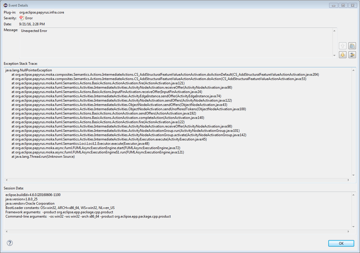

I was following along but I got a Java NullPointerException when pressing debug in the "Starting an execution with a launch configuration" section.
I have attached an image of the event details.

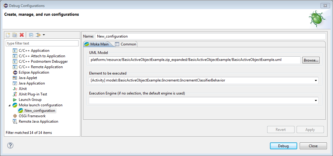

I noticed one difference from the tutorial and that is that the New_Configuration window has an extra field. I have also attached an image of that window.

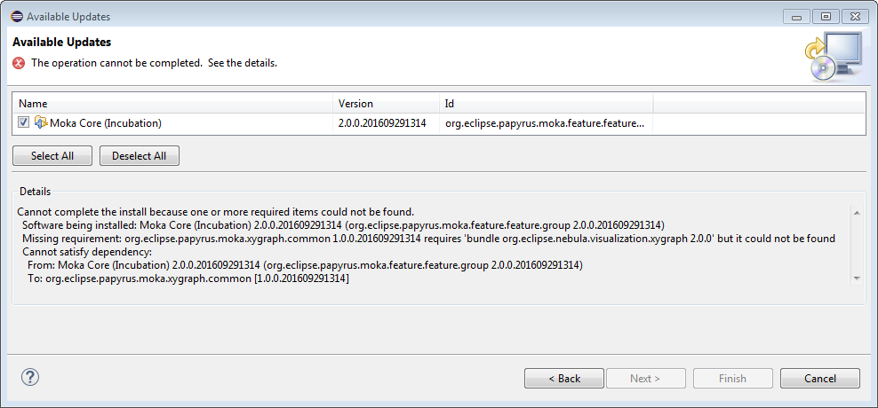

I ran a "Check for Updates" this morning (Sep 30, 9:30am EDT) and got this Moka error:
index.php/fa/27265/0/
Is this related to this issue?

Re: Exception running Moka example [message #1744858 is a reply to message #1744820] Fri, 30 September 2016 16:26 Go to previous messageGo to next message
I tried to reproduce the above issue, but ran into https://bugs.eclipse.org/bugs/show_bug.cgi?id=502968

Re: Exception running Moka example [message #1744950 is a reply to message #1744051] Mon, 03 October 2016 05:29 Go to previous messageGo to next message
Hi Stephen,
Meanwhile Benoit fixed the bug, and I found the cause of your problem.
In the screenshot below, you forgot to set (actually modify) the 'element to be executed' to the generated factory, iso. the classifierbehaviour.
Still, it is at least very 'user-unfriendly' to generate an un-understandable exception if the wrong element is selected, especially since the field is filled by default, so I'll re-open the bug.

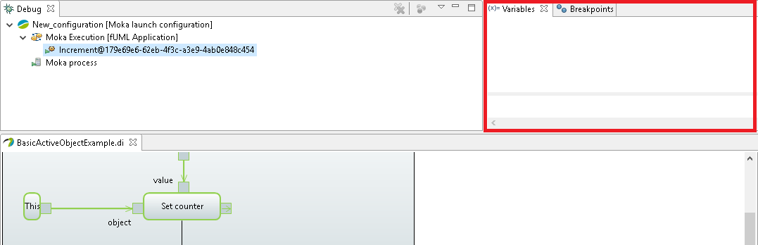

However, I still can't see the variables in the variables panel. Could you guys see the variables and value of the count property change?
Re: Exception running Moka example [message #1747996 is a reply to message #1746913] Thu, 17 November 2016 09:20 Go to previous messageGo to next message
Hi Bruno,
To see the variables in the panel, the execution has to be suspended. This can be done by pressing the "pause" button, or by putting a breakpoint on a node or vertex in the activity.
