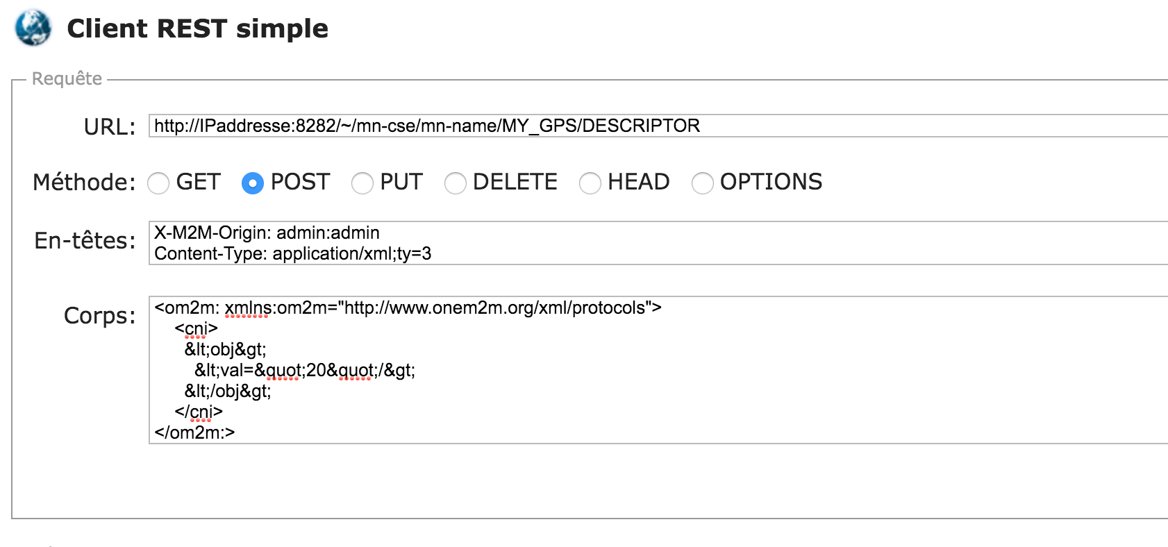

Hey guys,
I hava a very stupide question. Sad
Can I use REST client to change the attribute of Container?
If yes, how can i edit the POST request body?

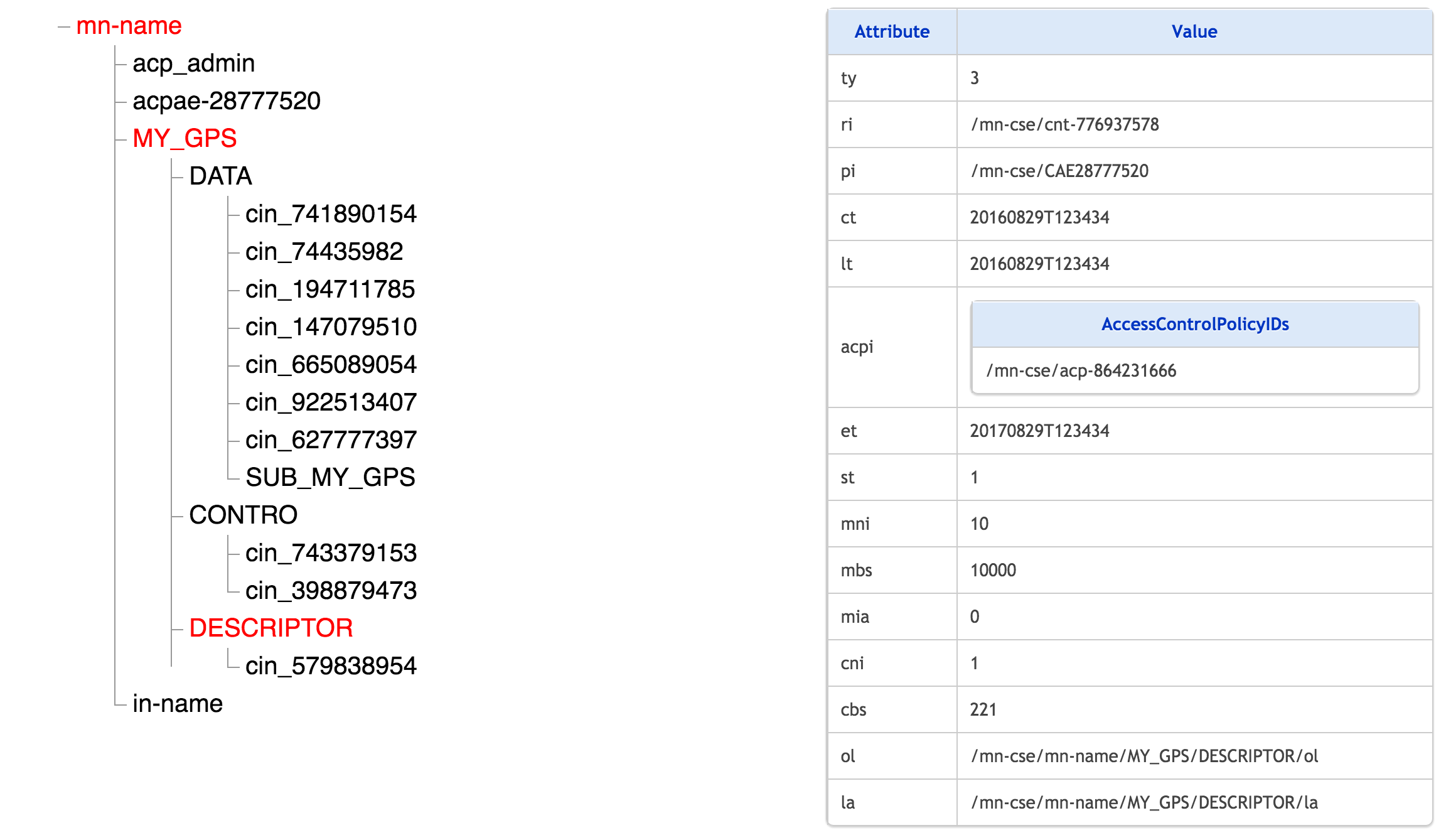

For example this is my interface and my DESCRIPTOR Container,
If i want to change the attirbute "mia" from 0 to 1.
index.php/fa/26908/0/
And how to edit de REST POST request body?
index.php/fa/26909/0/
Thanks in advance !

I am not sure I understood really well what you were trying to do with your example request, but if you want to change the value of mia to 1 using the REST API, you could do something like that:
URL: http://IPaddresse:8282/~/mn-cse/mn-name/MY_GPS/DESCRIPTOR
Method: PUT
Headers: X-M2M-Origin: admin:admin
Body:
<m2m:csr xmlns:m2m="http://www.onem2m.org/xml/protocols">
<mia>1</mia>
</m2m:csr>
Hope it helps !
Dorian
Re: Use REST client to change the attribute of Container [message #1741901 is a reply to message #1741897] Tue, 30 August 2016 10:06 Go to previous message
Hi Can,
To update a resource you have to make a PUT http operation targeting the resource you want to update.
The payload has to be the representation of the attributes you want to change.
In your case, to update the "mia" attribute of a container, the request is:
PUT /~/in-cse/in-name/{YOUR_CONTAINER_LOCATION} HTTP/1.1
Host: localhost:8080
Content-Type: application/xml
X-M2M-RI: 123456
<m2m:cnt xmlns:m2m="http://www.onem2m.org/xml/protocols" >
   <mia>1</mia>
</m2m:cnt>
