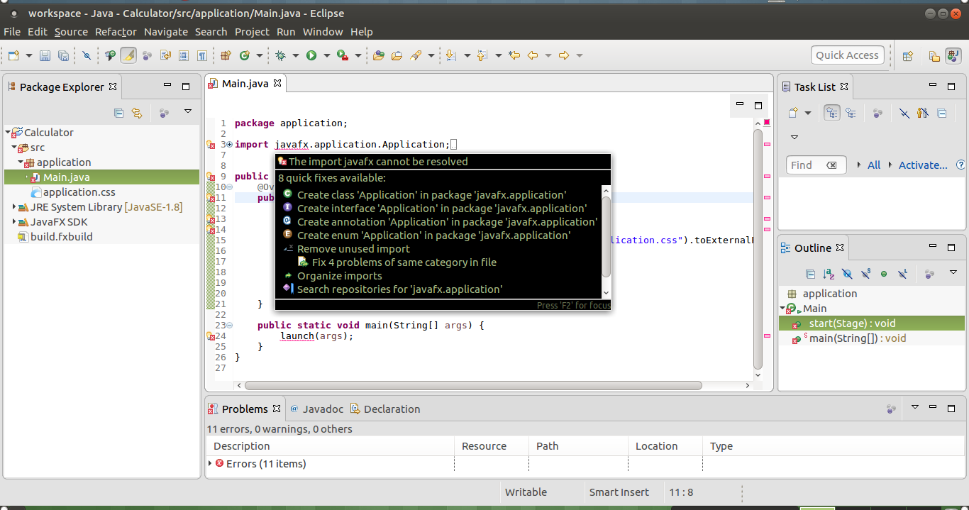

I am new with Linux and Java, on my Windows 10 all is working fine. I just installed Ubunutu Mate 16.04 yesterday, all updated. Today I installed latest Eclipse 4.6.0 and installed e(fx)clipse 2.3.0
But as Soon as I create a New JavaFX project, (no editing yet) it gives Error in picture above

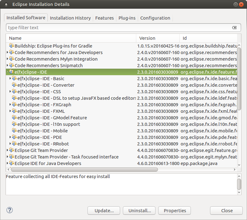

just to be sure that I have e(fx)clipse installed:
https://www.eclipse.org/forums/index.php/fa/26714/0/

Most likely the Java you have installed (OpenJDK) does not contain
JavaFX. You need to install OracleJDK.

Thanks a lot for the reply Tom, I did had openjdk installed as default in Ubuntu, now I have Installed Oracle JDK8 latest
Now,
java -version
Output
java version "1.8.0_101"
Java(TM) SE Runtime Environment (build 1.8.0_101-b13)
Java HotSpot(TM) 64-Bit Server VM (build 25.101-b13, mixed mode)
I can say that it was useful to install oracle jdk because my compiled .jar projects from Windows were not running in Linux, now they are.
But in Eclipse, nothing is changed, I started Eclipse, same errors
I deleted the Project, since it was still a blank project so to say, and created a new Javafx project...and same errors.
Maybe I have to change something in Eclipse now to work with new Jdk from oracle, but I don't know how or where to do that.

You most likely have to configure the new JDK in your eclipse install
Tom
