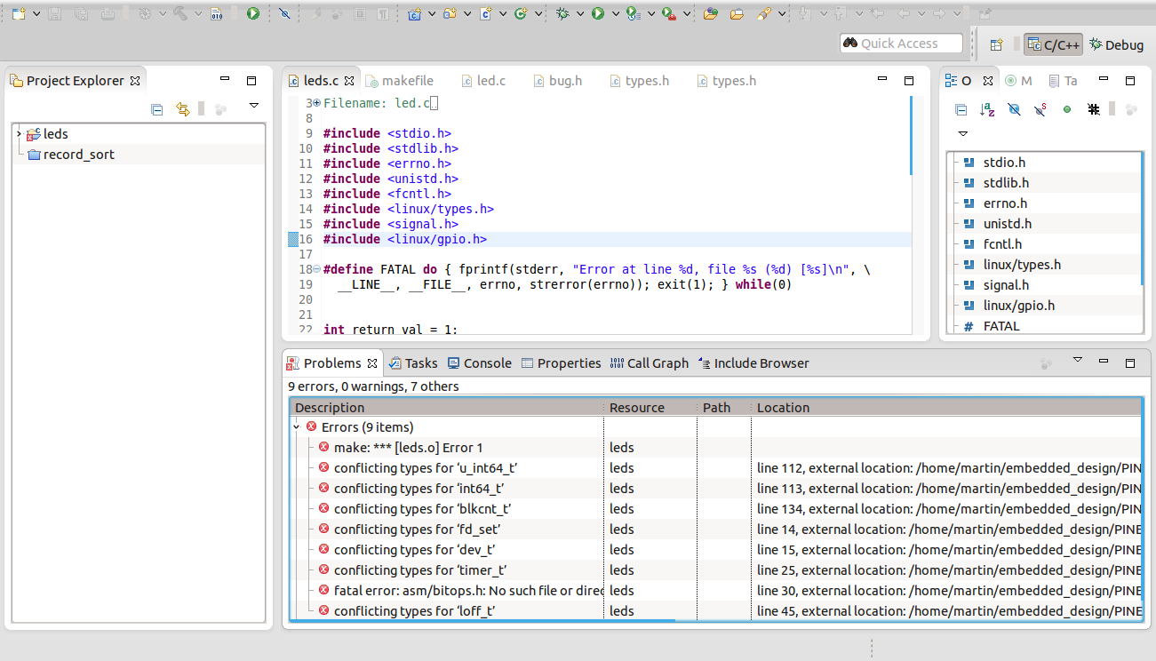

When I compile the code I get these errors: for example "conflicting types for u_int64_t" with info that "previous declaration of u_int64_t was here ... <path to declaration> (see pic below)

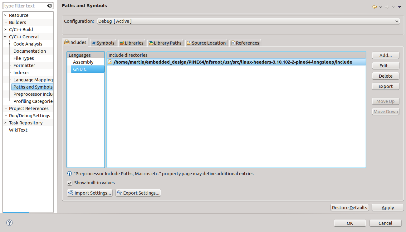

As I want to work with GPIOs, I have to include "gpio.h" file from rootfs for dedicated board PINE64, as include paths (chosen default by CDT according to aarch64-linux-gnu-cpp) do not contain this header file. Thus, I add the path to directory containing this file "gpio.h" in my project in eclipse (see pic below)
index.php/fa/26658/0/
However, as in this included directory is also same named file "types.h" (most of conflicts are from types from this header file), however with different definition as in default include directories (included by CDT according to aarch64-linux-gnu-cpp). Thus I am sure this can cause errors.
Hence, my question sounds. How can I include directory from different location (in this case root fs for my board) and not to experience these include conflicts? Either, how can I remove them?
