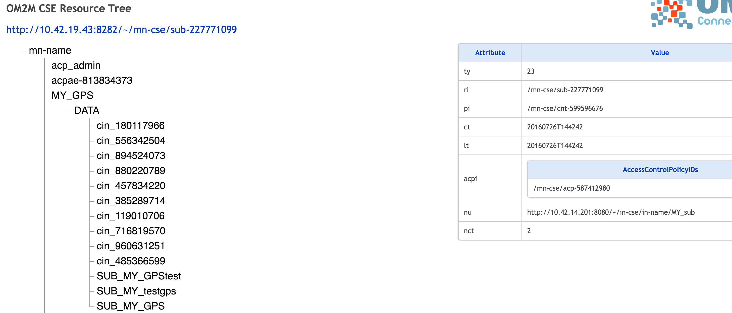

IN-AE MY_subtesting subscript to MN-AE DATA source.(like shows in the picture)
index.php/fa/26574/0/
It subscripts with the nu = IN-AE resource.

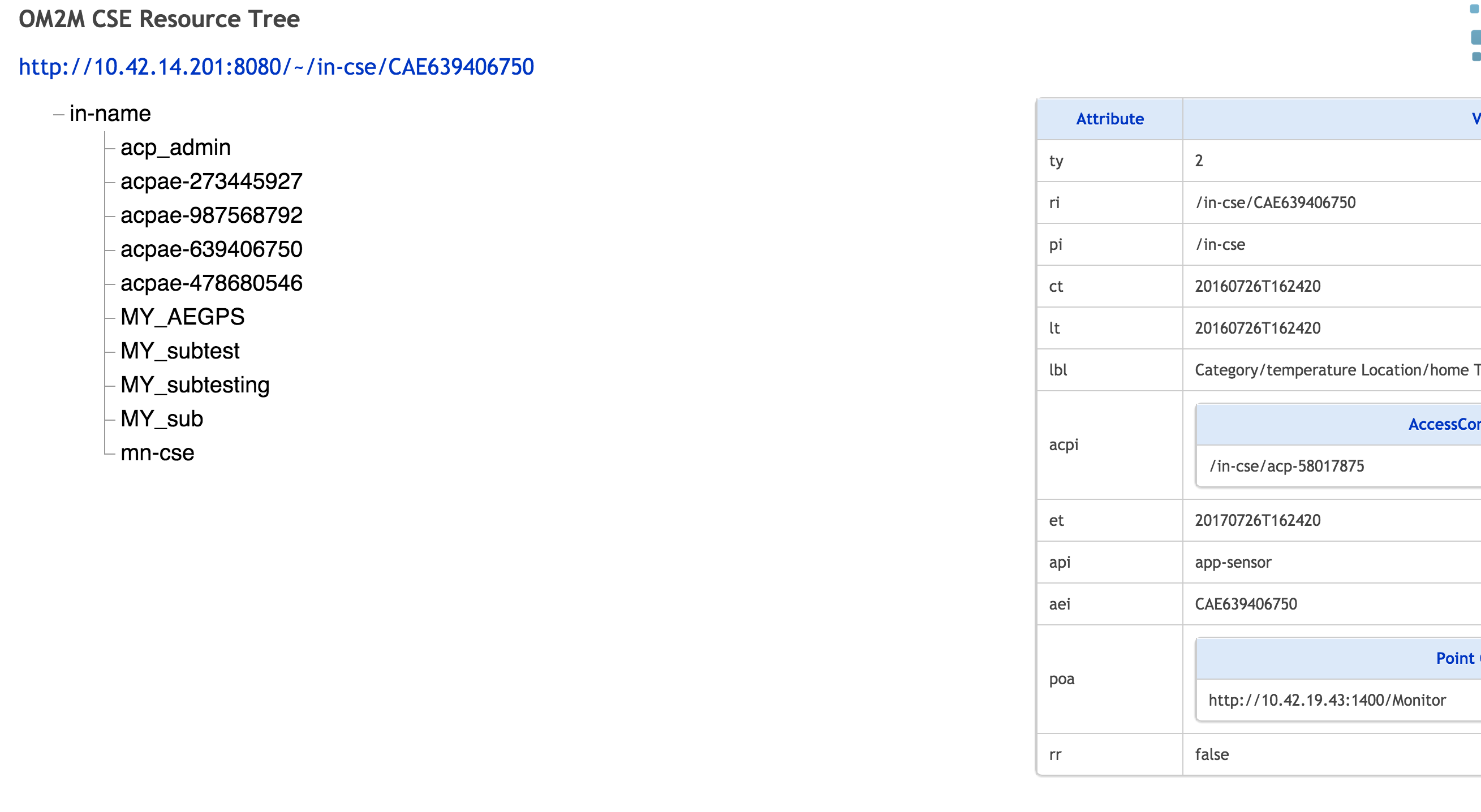

At the IN side, i add a POA value to finally to notify my application in this subscripted IN-AE. (like show in the picture)

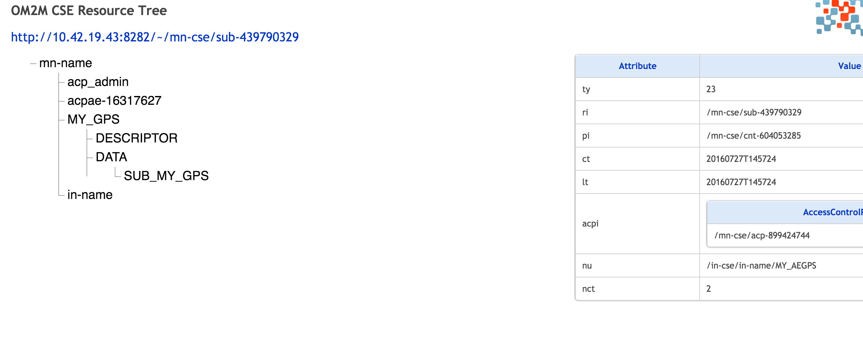

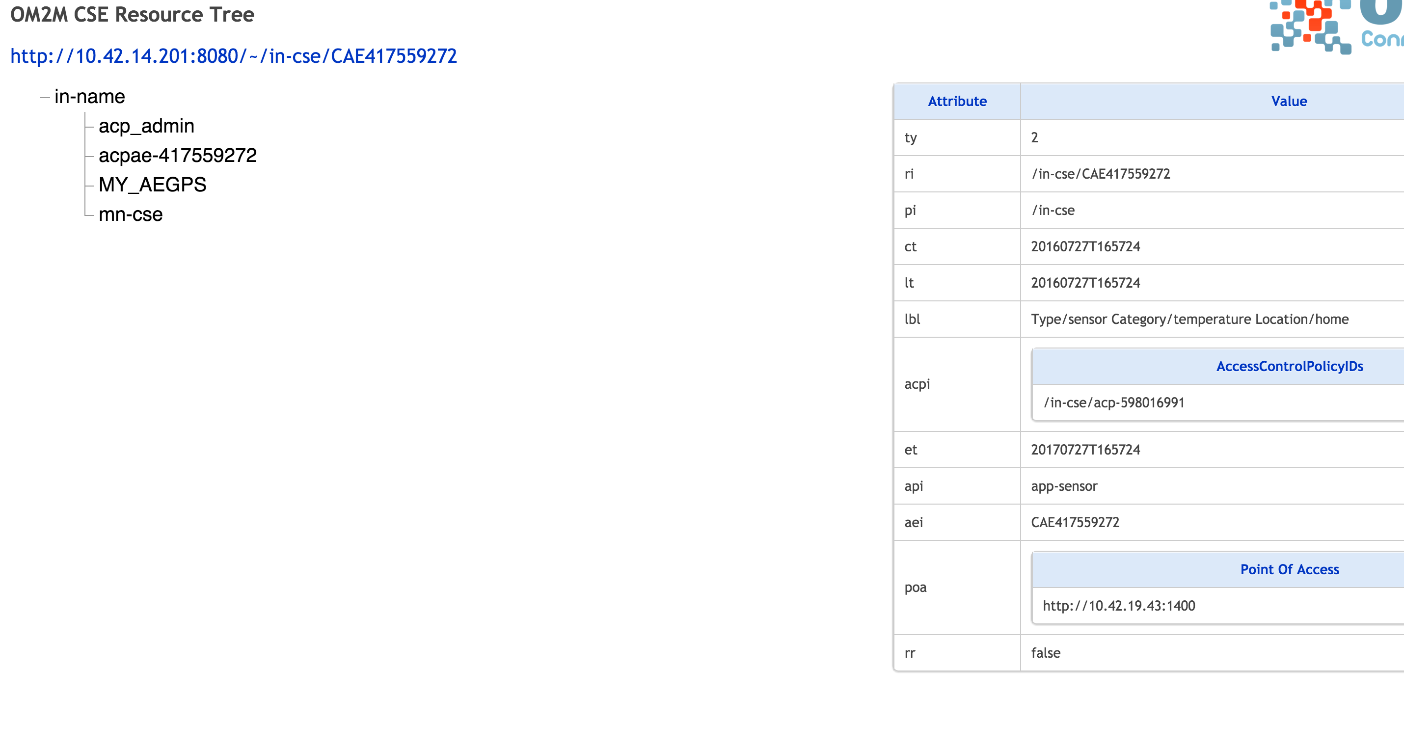

I've changed the nu to "/in-cse/in-name/MY_AEGPS" but it still not working.
In order to look cleaner, I just keep the IN-AE(MY_AEGPS) and one subscription (sub_MY_GPS).

Re: responseStatusCode=4103 (Unknown or unauthorized originator) when notify to AE resource [message #1739114 is a reply to message #1739107] Wed, 27 July 2016 11:07 Go to previous messageGo to next message
Hi madhi,
Yes, I started from the zero.
There is one IN-AE named MY_AEGPS and there is one subscription named SUB_MY_GPS which has a "nu = /in-cse/in-name/MY_AEGPS "
Please see from the picture:
index.php/fa/26583/0/
index.php/fa/26584/0/
And this is the log informations:

You need to set the reachability of your AE to true Wink
Check the rr attribute.

Hi Madhi,
Sorry for the late reply!
That's great! I think that the notification succeed pass to AE-IN.
I gave AE-IN a poa with (http://10.42.19.43:1400/Monitor) which is the IP adresse of my IN itself. But it shows 5103 (Target is not reachable: http://10.42.19.43:1400/Monitor,)

Do you have some idea of this error. FYI, Monitor is a function in my AE-IN programme which listen the port 1400 to catch the notification.

does your listener returns a response after receiving the notification something like 200 Ok?
Try to open http://10.42.19.43:1400/Monitor in your browser, what do you see ?

Hi madhi,
It works!!! cool ! I gave the wrong Ip address to the POA, after change, it works!!
Thank you so much about all of this!! Really

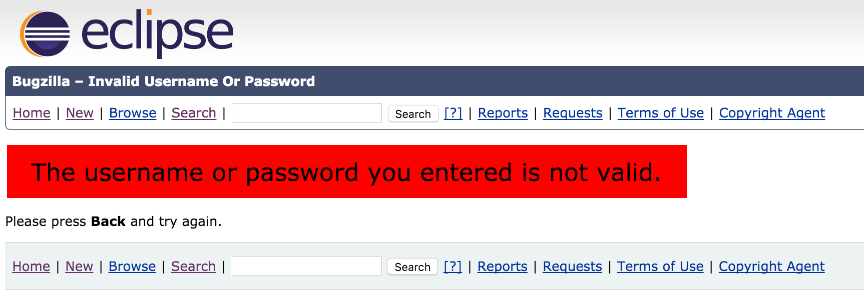

I really want to open the bug, but i couldn't log in at bugzilla.
It always told me that my account doesn't exist!!
Re: responseStatusCode=4103 (Unknown or unauthorized originator) when notify to AE resource [message #1739219 is a reply to message #1739215] Thu, 28 July 2016 08:35 Go to previous messageGo to next message
Did you tried "forget your password" link in Bugzilla ?
Re: responseStatusCode=4103 (Unknown or unauthorized originator) when notify to AE resource [message #1739220 is a reply to message #1739219] Thu, 28 July 2016 08:48 Go to previous messageGo to next message
Yes i tried.
still the same and i am sure that my account name and password are correct.
You can solve all kinds of problem Smile)))))

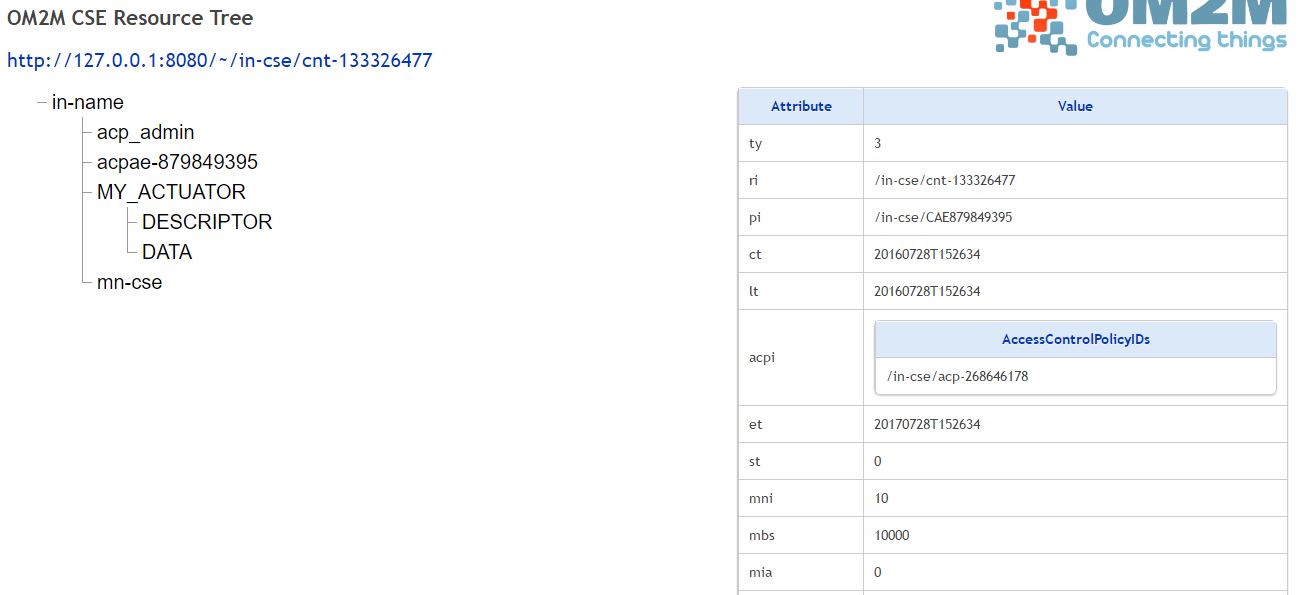

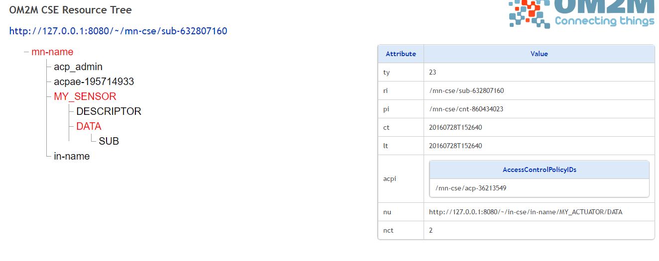

I'm trying to do the Subscribe/Notify Scenario like Can LIU do and I also have problems with receiving the Notify message. I subscribe MY_ACTUATOR/DATA in IN-CSE to MY_SENSOR/DATA resource in MN-CSE. The suscription code is created as follow in Monitor class of Sensor plug-in project:
String addr = "/" + CSE_ID + "/" + CSE_NAME + "/" + sensorId + "/" + DATA;
targetId = "http://127.0.0.1:8080/~/in-cse/in-name/MY_ACTUATOR/DATA";
Subscription sub = new Subscription();
sub.getNotificationURI().add(targetId);
sub.setNotificationContentType(BigInteger.valueOf(2));
RequestSender.createSubscription(addr,SUB,sub);
In RequestSender Class, the code is:
public static ResponsePrimitive createSubscription(String targetId, String name, Subscription resource){
return createResource(targetId, name, resource, ResourceType.SUBSCRIPTION);
However, when I run both Application, the error 4004 the AE resource in /in-cse/cnt-610909448 not found.

The notification URI (nu attribute) could be:
1) a full URI of a listener, something like: http://192.168.0.10:1400/abcde. This suppose that such address is directly accessible from the CSE node.
2) or, an AE ID like /in-cse/in-name/MY_Actuator. In this case the AE resource MY_Actuator shall contain a PoA (Point of access) attribute containing "http://192.168.0.10:1400/abcde" and the RR (Reachability) attribute set to true.
Re: responseStatusCode=4103 (Unknown or unauthorized originator) when notify to AE resource [message #1739233 is a reply to message #1739224] Thu, 28 July 2016 11:14 Go to previous messageGo to next message

Re: responseStatusCode=4103 (Unknown or unauthorized originator) when notify to AE resource [message #1739350 is a reply to message #1739233] Sat, 30 July 2016 07:37 Go to previous messageGo to next message
Hi Mahdi,
if I understand correctly your answer that I need to set the PoA of my AE resource MY_ACTUATOR to be something like the URI where the notification message to be sent to. Is it right? I tried this by setting the PoA of MY_ACTUATOR to be:
ae.setRequestReachability(true);
ae.getPointOfAccess().add("http://127.0.0.1:8080/~/in-cse/in-name/MY_ACTUATOR");
but it also didnt work. Do you have any idea, Mahdi?
Son
Re: responseStatusCode=4103 (Unknown or unauthorized originator) when notify to AE resource [message #1739351 is a reply to message #1739350] Sat, 30 July 2016 09:02 Go to previous messageGo to next message
Dear Son
You should put a URI of a listener, like a simple http server.
Check the "Subscribe to MY_SENSOR data" of our REST API tutorial: http://wiki.eclipse.org/OM2M/one/REST_API
Download the "monitor.jar" file and run it by following the instructions. Byd efault, your server will start listening on port=1400 and context=/monitor.
You then use the following address as PoA for your AE: http://127.0.0.1:1400/monitor
All events will be sent to this listener and processed according to your need.
Re: responseStatusCode=4103 (Unknown or unauthorized originator) when notify to AE resource [message #1739357 is a reply to message #1739351] Sat, 30 July 2016 10:09 Go to previous messageGo to next message
Hi Mahdi,
I already tried with this http server and it worked fine, now i would like to change the listener to the MY_ACTUATOR so that the notification will be sent to MY_ACTUATOR in IN_CSE. It this not possible?
And in my last tried with the http server Monitor, I didnt set the poa address, instead i set only the nu address to be something like http://127.0.0.1:1400/Monitor but it still received the notification. Can you explain me why I didnt set the poa address but it still worked?
Thank you!
Son

Re: responseStatusCode=4103 (Unknown or unauthorized originator) when notify to AE resource [message #1739361 is a reply to message #1739357] Sat, 30 July 2016 11:15 Go to previous messageGo to next message
Hello Son
1) What do you mean by "sending the notification to MY_ACTUATOR":
a) storing the notification as content instances in th resource tree under the MY_ACTUATOR resource?
b) or making the CSE re-targeting the notification to the PoA of MY_ACTUATOR ? So here you need a listener which is technically a piece software implementing a listener but functionally part of your AE.
2) The Bug 498911 - Error in Access Right verification for PoA notification (https://bugs.eclipse.org/bugs/show_bug.cgi?id=498911) impacts only the PoA permission verification.
So, when you define your http listener address directly as NU in your subscription then you bypass the PoA verification and it will works however if you chose to define AE-ID as NU and configure your http listener address as PoA then you will get an error.
I pushed a patch to master branch and uploaded the corresponding binaries on our Wiki.
You can download OM2M-DEV-30072016 from https://wiki.eclipse.org/OM2M/Download

Hi Mahdi,
both of your 1a) and 1b) are what I mean when "sending the notification to MY_ACTUATOR" Smile. So,
1a) is this case possible that the notification will be stored under MY_ACTUATOR resource, maybe under MY_ACTUATOR/DATA? I think I have misunderstood this case for a long time, what I thought before is OM2M supports subscription/notification method so I thought that when MY_SENSOR in mn-cse sends the notification to MY_ACTUATOR in in-cse, I just need to put the nu address of MY_ACTUATOR in the subscription resource and when the notification is received, it will automatically created a contentInstance under MY_ACTUATOR to store the notification message. Now I believe that I am totally wrong when thinking like that.
1b) So if I want to re-target the notification to MY_ACTUATOR, i need to "integrate" the http server monitor into the MY_ACTUATOR AE. Is it right? So that means OM2M support sub/noti method by sending the notification message but I always need a http server to listen for the notification, my AE MY_ACTUATOR can not listen its self.
2) I think the bug you mentioned was already deleted.
Son
