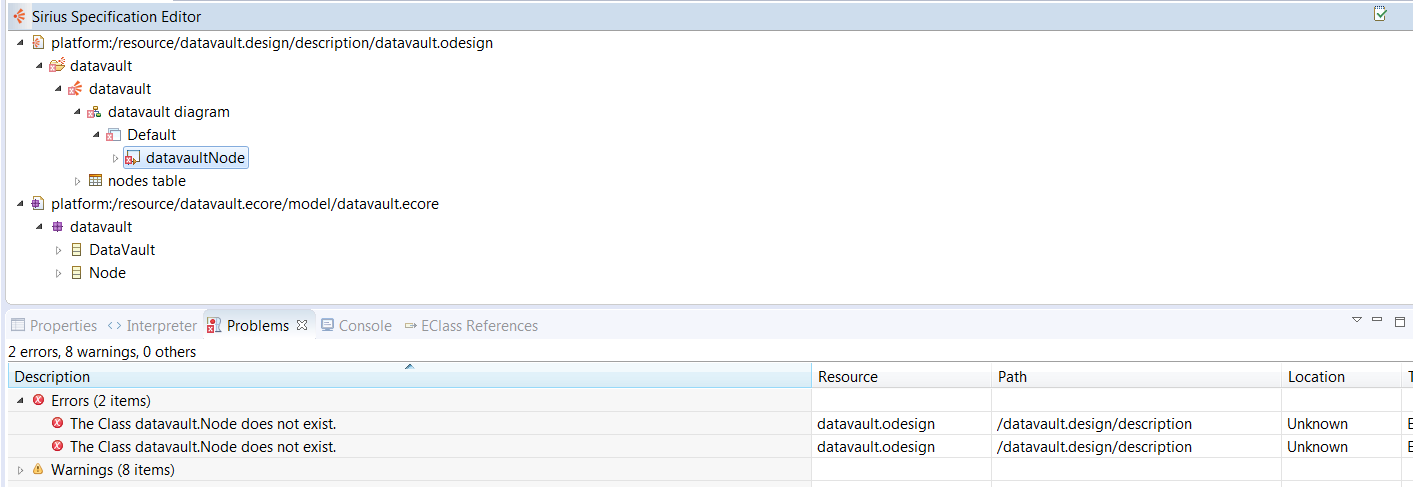

My question was meant as "how to start working with sirius". I do have a ecore modell. All my tries to get Sirius working were futile. I always end up either at the point where classes from my modell are not found (see Screenshot) or when it seems to be working I get only a empty list to select a semantic element from (see second screenshot).
I've cross checked everything that came to mind with the basicfamily example which works just fine. There seems to be nothing important different.
I'm really out of ideas and would like to have a fool proof description on how to get from an ecore modell to a working graphical diagram and editor in sirius.

In your odesign, on the Viewpoint element "datavault" (child of the root
element), did you fill the "Model File Extension" with the extension of
your models ("datavault" I guess)?
On the Diagram description named datavault diagram, there is a tab
metamodels in the properties view. Is your metamodel registered?
On your node mapping named datavaultNode, the domain class is set as
"datavault.Node"?
Is your metamodel deployed or is it a project in the same Eclipse as
your Viewpoint Specification Project?
Steve

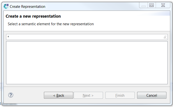

This time it validates (for now), but then if I create a modelling project and an example file, even with the correct extension, the "Viewpoints Selection" won't show my viewpoint.
I've now spent another two hours trying to work around this. Trying various clues from this forum. To no avail.

How did you create the example file? Were you able to create it via the
New/Example... wizard? In the Model Explorer view, do you see the
semantic model icon with the "M" decorator and are you able to see to
model element if you expand the tree under the file?
Steve
