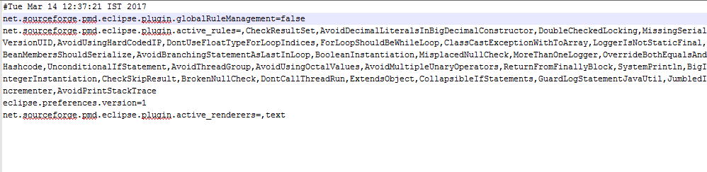

2) I do few changes in the preferences for PMD (by recording the preferences )and put it to the product.setup file. It works for Mars but it is not working for Neon.
Below are the preference task for PMD which is not working(please see attached pmd.png).

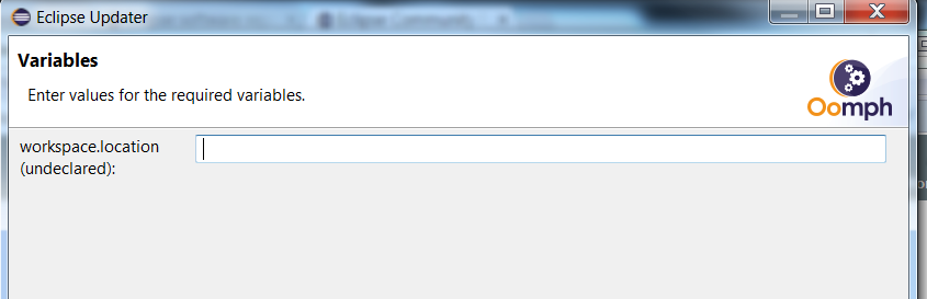

3) I get a probelm when I switch the workspace where it ask me to enter the workspace location again(see the attachment workspace.png). Why?
I tried a solution provided by you in a different thread.
<setupTask
xsi:type="setup:VariableTask"
excludedTriggers="STARTUP MANUAL"
name="workspace.location"
defaultValue="${osgi.instance.area|trimTrailingSlashes}"
storageURI="scope://Workspace"/>
But, If I put this in the product.setup file, While installing It doesn't take the workspace.location variable(in the variable page of the installer) automatically and it asks us to provide it manually.
There is one more probelm which I get by using the above solution for the workspace location is while resource creation,, I get the following error(I think the path gets corrupted).
Are they restricted to perform only in the IDE? I.e.,
excludedTriggers="BOOTSTRAP"
> <setupTask
It seems bogus in any case to put this in the product because the
instance area property is the instance area of the installer itself. No
workspace is known at the time you're creating purely an installation.
If you're using a project setup as well, it's not needed because that
variable is declared by the workspace task in the project catalog. So I
don't know how this can ever work. Also the value of
osgi.instance.area is a URI but the workspace.location is generally
assumed to be a OS file system path.
Avneesh: No. but,even If I do that It is not working for Neon and works very well with mars.
> <setupTask
Avneesh: What should be the solution for this as I do not want user to be asked for the "workspace location" variable everytime when they switch the workspace. ?
>> Why?
>> <setupTask
> No workspace is known at the time you're creating purely an
> installation. If you're using a project setup as well, it's not needed
> because that variable is declared by the workspace task in the project
> catalog. So I don't know how this can ever work. Also the value of
${osgi.instance.area|trimTrailingSlashes|file}" should convert the URI
It's not clear to me what about the above particular values isn't working.
Avneesh: I will explain you the case here. I am using PMD plugins and I have to do some automatic preferences settings in eclipse. So, I record the preferences and put it to my product setup file.
It works as expected if I use the same preferences task for mars installation but it does not work for neon.
<setupTask
xsi:type="setup:PreferenceTask"
key="/instance/net.sourceforge.pmd.eclipse.plugin/net.sourceforge.pmd.eclipse.plugin.active_rules"
value=",CheckResultSet,AvoidDecimalLiteralsInBigDecimalConstructor,DoubleCheckedLocking,MissingSerialVersionUID,AvoidUsingHardCodedIP,DontUseFloatTypeForLoopIndices,ForLoopShouldBeWhileLoop,ClassCastExceptionWithToArray,LoggerIsNotStaticFinal,BeanMembersShouldSerialize,AvoidBranchingStatementAsLastInLoop,BooleanInstantiation,MisplacedNullCheck,MoreThanOneLogger,OverrideBothEqualsAndHashcode,UnconditionalIfStatement,AvoidThreadGroup,AvoidUsingOctalValues,AvoidMultipleUnaryOperators,ReturnFromFinallyBlock,SystemPrintln,BigIntegerInstantiation,CheckSkipResult,BrokenNullCheck,DontCallThreadRun,ExtendsObject,CollapsibleIfStatements,GuardLogStatementJavaUtil,JumbledIncrementer,AvoidPrintStackTrace"/>
<setupTask
key="/instance/net.sourceforge.pmd.eclipse.plugin/net.sourceforge.pmd.eclipse.plugin.globalRuleManagement"
value="true"/>
</setupTask>
>> Why?
>> <setupTask

Thanks Ed for your reply.
I will try to put it again.
1) I will explain you the case here. I am using PMD plugins and
installation but it does not work for neon? Below are the two tasks
<setupTask
<setupTask
value="true"/> </setupTask>
2) If I put the below task and run the installer, it asks me to manually enter the workspace.location and this user would not like to put as it doesnot have the workspace location rule and the browse button to select the workspace location.
defaultValue="${osgi.instance.area|trimTrailingSlashes|file}"
What am I doing wrong or which setup file should I put the above task.?
Avneesh

Okay, good, they will only run in the IDE.
Instead of setting the default value, you could just set the value. The
prompt field should be initialized to the default value, so I'm not sure
why that's not the case. I tested adding these two tasks to a
workspace.setup in my IDE and indeed it prompts for the workspace, with
the correct default value:
<xmi:XMI xmi:version="2.0"
xmlns:setup="http://www.eclipse.org/oomph/setup/1.0">
<setup:VariableTask
name="workspace.location.x"
<setup:StringSubstitutionTask
name="foo"
value="${workspace.location.x}"/>
</xmi:XMI>
So you're saying that it prompts for variable's location in the running
IDE but hasn't filled in the default value? I can't reproduce that...
> Thanks,

It doesn't work for eclipse neon but it works for mars. Why?

I don't know. How can you tell it's not working? The preference is
never set? If you checkmark "Show all triggered tasks" on the
Confirmation page, is the task not shown, or is it shown but is
disabled? Generally that's because it's not needed because the
preference is already set that way.

> Workspace.setup file is a local file and I want it to put it to some
> file which will be in internet and common for all(like product.setup
> and project.setup). How would you do it?
Yes, that's fine. I tested it by putting it in my workspace.setup
purely so I could test it. It works as expected.
>> >to >put as it doesnot have the workspace location rule and the browse
>> >The prompt field should be initialized to the default value, so I'm
>> >not sure why that's not the case. I tested adding these two tasks to
>> >a workspace.setup in my IDE and indeed it prompts for the workspace,
>>> with the correct default value:
Which setup file I should put it to make it working? (I cannot put this in any of the local setup files (user,installation,workspace).

Sorry I missed to answer for this comment. If I do not put the above setup task anywhere and try to switch the workspace after launching of eclipse, it will prompt you with the variable page and ask you to put the workspace.location.
I think this should be reproducible. Try launching your eclipse (mars or neon) after installing and switch it to new workspace location. It should prompt you with the variable page.
Note that I asked a question. You didn't answer it. Leave it where
you had it. I only wanted to test that it works for me as expected.

Re: Problems migrating to Neon [message #1737970 is a reply to message #1737965] Thu, 14 July 2016 10:30 Go to previous messageGo to next message
Avneesh,
> I checked in the confirmation page also. It shows the task but it
> doesn't apply when I open the preferences page.
> Note that I have so many other preference settings also which works
> for both mars and neon but only PMD related settings are not happening
> for Eclipse neon. Its strange.
Is the task enabled or disabled? Black means the task is needed and
will perform, grayed out means it isn't needed and won't perform. If
it's enabled, later on when the task performs, there should be a log
entry saying it's performed.
Is it the same version of PMD installed? Perhaps they've moved
where/how the preferences are stored.
Where have you been putting it? You can put it in your product catalog
if you want. Have you tried changing it to set the "value" attribute
instead of the "defaultValue" attribute?
Because you have some task that uses this variable so if you don't put
it anywhere it will definitely always prompt. So put it in your product
catalog.

Sorry, but this is all so vague. A project catalog generally should
have a workspace task in it and that generally has ID "workspace" and
that induces the variable workspace.location. The workspace location is
computed; you should not need a variable for it. But if you open the
IDE for a new workspace, and don't have any project streams in it, there
will be no workspace task and there will be no such variable defined.

and I have attached PMD "net.sourceforge.pmd.eclipse.plugin.prefs" file also.

Preferences are stored in
<workspace>/.metadata/.plugins/org.eclipse.core.runtime/.settings There
should be a net.sourceforge.pmd.eclipse.plugin file there. If the task
performed, I expect that file to have been updated.
I would suggest not using the workspace.location variable except in
tasks within a project setup.

I guess I found the reason why it was not working. I tried removing the below task from the product catalog file and now I can easily switch to the new workspace without a variable dialog for workspace location.
" <setupTask
xsi:type="setup:ResourceCreationTask"
content="&lt;?xml version=&quot;1.0&quot; encoding=&quot;UTF-8&quot;?>&#xD;&#xA;&#xD;&#xA;&lt;checkstyle-configurations file-format-version=&quot;5.0.0&quot; default-check-configuration=&quot;ETS Configuration&quot;>&#xD;&#xA; &lt;check-configuration name=&quot;ETS Configuration&quot; location=&quot;C:\LegacyApp\ETS-Dev\Oomph\beta\config\ets-checkstyle-config.xml&quot; type=&quot;external&quot; description=&quot;ds&quot;>&#xD;&#xA; &lt;additional-data name=&quot;protect-config-file&quot; value=&quot;false&quot;/>&#xD;&#xA; &lt;/check-configuration>&#xD;&#xA;&lt;/checkstyle-configurations>"
targetURL="${workspace.location|uri}/.metadata/.plugins/net.sf.eclipsecs.core/checkstyle-config.xml"
encoding="UTF-8"
documentation="Initialize Checkstyle configuration."/>
. Is there any other way to set the above configuration for checkstyle for users?

I am sorry that last time I checked the mars workspace intead of neon and the values are correct there.
I checked the neon workspace <workspace>/.metadata/.plugins/org.eclipse.core.runtime/.settings net.sourceforge.pmd.eclipse.plugin.prefs file and I found that "net.sourceforge.pmd.eclipse.plugin.globalRuleManagement=false"
whereas the the installer window shows "Performing Preference
= true
It works for mars perfectly but not for neon. I checked the PMD version also and its the same for both mars and neon.
Avneesh

Using workspace.location works fine if the workspace is configured with
a project setup, i.e., if the workspace.setup references a stream in
some project catalog, because the project catalog generally should have
a WorkspaceTask with ID "workspace" that will induce the value for this
variable. So a task using this variable should only be an a project
catalog. If you want such a task in a product catalog, you should
replace the use of that variable with ${osgi.instance.area|file} (not
define a variable that will conflict with the case that you have a
stream referenced by the workspace.setup) and make sure the task with
that reference is not triggered at bootstrap time (as you've already
done). Then it should work in any installation even with an empty new
workspace.
> = true".
I tested this. I modified the p2 task in a product version in the
Eclipse.org product catalog to install
net.sourceforge.pmd.eclipse.feature.group from
https://sourceforge.net/projects/pmd/files/pmd-eclipse/update-site/. I
used that to create an installation. In that installation I recorded
this task by changing the PMD preferences.
<setup:PreferenceTask
xmi:version="2.0"
value="true"/>
I checked in the file system that the preference file contains
net.sourceforge.pmd.eclipse.plugin.globalRuleManagement=true
Then I terminated, copied the above task to the product catalog,
modified the preference file itself in the workspace metadata to change
the value to false, and then I started that same workspace again. The
log shows:
= true
And the file has true it in again afterward.
So that works for me.
>log shows:
>= true
This way it works for me as well . It will be true if you check the preference file in .settings folder and becomes false once you open Window -> preferences-> PMD->Rule Configuration in your eclipse instance.
It is the case only with neon but not with mars.

Re: Problems migrating to Neon [message #1738211 is a reply to message #1738209] Mon, 18 July 2016 04:14 Go to previous messageGo to next message
> Don't you think that we will get "osgi.instance.area" as undeclared if
> we put this in the product catalog file?
No, not if the task isn't enabled for bootstrap. I tested it just now.
This is not what I see. It all works fine for me.
Re: Problems migrating to Neon [message #1738221 is a reply to message #1738211] Mon, 18 July 2016 04:54 Go to previous messageGo to next message
I do not know Why it asks me for "osgi.instance.area" undeclared . I have used the below part in my product catalog
<setupTask
targetURL="${osgi.instance.area|file}/.metadata/.plugins/net.sf.eclipsecs.core/checkstyle-config.xml"
encoding="UTF-8"

Re: Problems migrating to Neon [message #1756287 is a reply to message #1738236] Wed, 15 March 2017 01:49 Go to previous messageGo to next message
Hi Eid,
For pmd setup task I am using following sinppet in neon
<setupTask
xsi:type="setup:CompoundTask"
name="User Preferences">
<annotation
source="http://www.eclipse.org/oomph/setup/UserPreferences">
<detail
key="/instance/net.sourceforge.pmd.eclipse.plugin/net.sourceforge.pmd.eclipse.plugin.globalRuleManagement">
<value>record</value>
</detail>
<detail
key="/instance/net.sourceforge.pmd.eclipse.plugin/net.sourceforge.pmd.eclipse.plugin.active_renderers">
</detail>
<detail
key="/instance/net.sourceforge.pmd.eclipse.plugin/net.sourceforge.pmd.eclipse.plugin.active_rules">
</detail>
</annotation>
<setupTask
name="net.sourceforge.pmd.eclipse.plugin">
<setupTask
value="true"/>
<setupTask
value=",text"/>
<setupTask
</setupTask>
</setupTask>
But still it's not setting net.sourceforge.pmd.eclipse.plugin.globalRuleManagement preferences to "true".
Please let me know if if something is wrong here.
Same snippet is working with mars but not with neon.
Tarun
