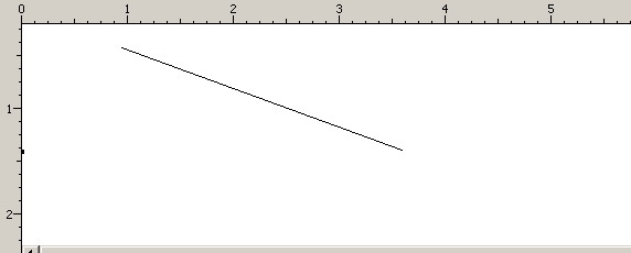

a problem of drawing line [message #173768] Mon, 28 March 2005 03:38 Go to next message
Originally posted by: tranfy.hotmail.com
Hi, all
I draw a line in paintFigure() of my figure that inherited from Figure,
shown as followed:
Rectangle bounds = getBounds().getCopy();
graphics.drawLine(bounds.getTopLeft(),bounds.getBottomRight( ));
I wonder why the line is not straight ,but is curvaceous. It is only
straight when i draw that vertically or horizonally.
Why is the line not straight?
Thanks !

I am using GEF 3.0.1 , SWT 3.0.1 and win2000 platform. I found that in
gef flow example , the line is not straight when drawing is not horizonal
or vertical.
Re: a problem of drawing line [message #174090 is a reply to message #174080] Mon, 28 March 2005 20:50 Go to previous messageGo to next message

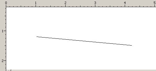

Pls see attachment.
"Pratik Shah" <ppshah@us.ibm.com> д

Are you referring to the "staircase" effect in the lower picture? That is
aliasing, due to the finite pixels of the display.

The good news is that SWT is introducing anti-aliasing in 3.1 and so the =
lines will look better on there.

Yikes, there's still more explaining to do here. It IS a straight line. It
just appears choppy. Like I said, with anti-aliasing in 3.1, it will look
better. Until then, you can't do anything.
