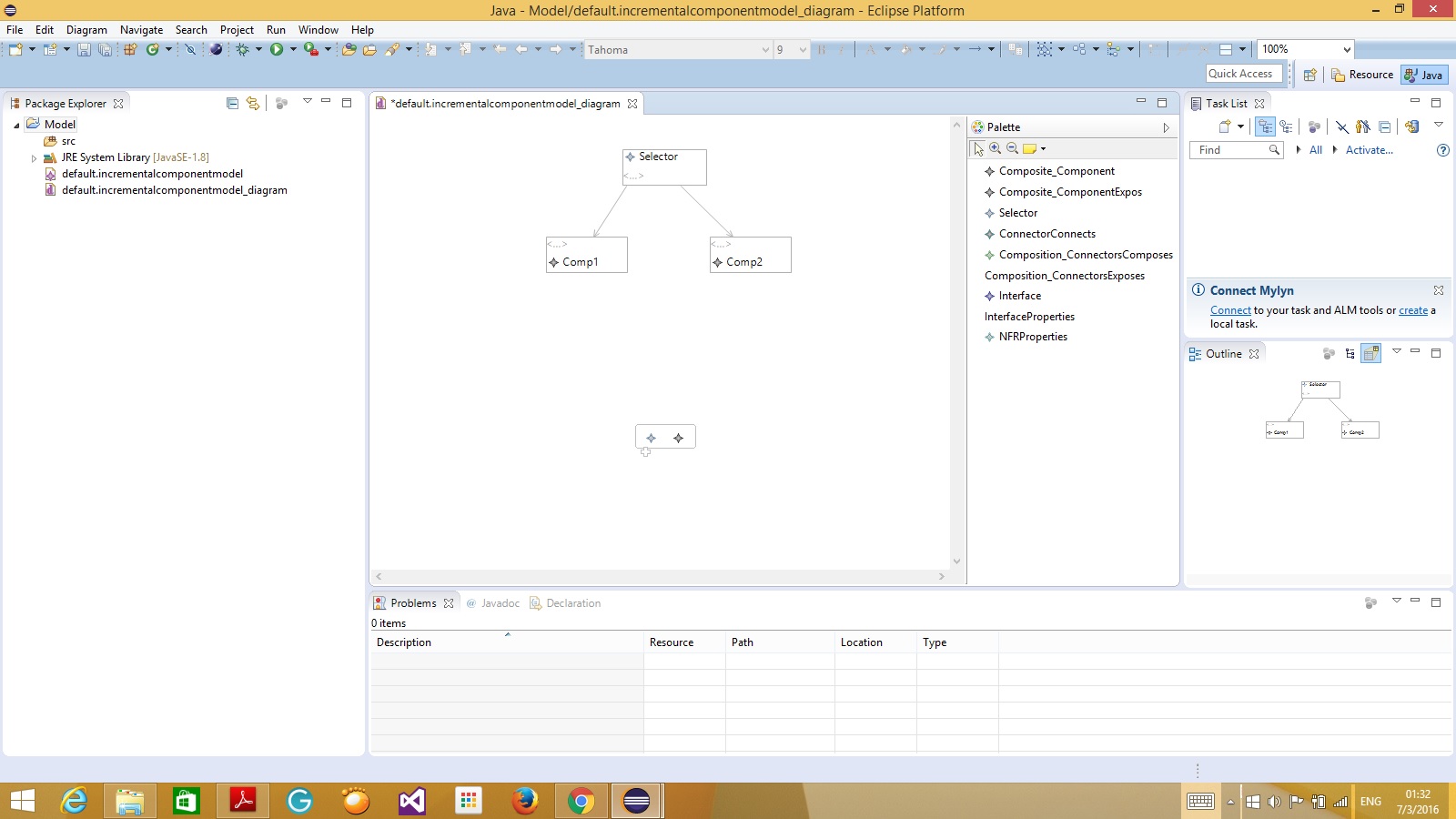

I'm new to both EMF and GMF and I've been assigned a task to create an EMF metamodel then a GMF one based on it to generate graphical diagrams.
Then i need to recreate code or classes from the generated diagram. Take the diagram attachment as an example
What i need to get is code or classes that holds the values and whatever inputs i have in the diagram
is this possible ??? how to accomplish this ???
