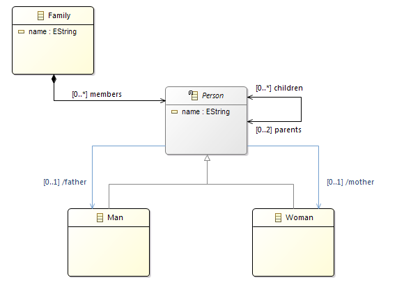

Here is the meta-model diagram:

1: After I import the existing meta-model,the Xtext grammar give a warnning like this:
"The feature 'children' is a bidirectional reference. "
And I can't create a model in instance Eclipse using this meta model.The error like this:
index.php/fa/26384/0/
Is it means that Xtext not support bi-directional reference(EOpposite)? If I want to use this feature, How should I do.

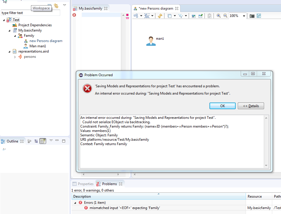

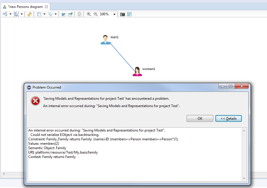

2: When I run a instance Eclipse, and want to use this meta-model to create model with Sirius, there is a problem when the model is created. It seems like the wizard dose not create Family ***{ } grammar. So I cant save the instance model.
index.php/fa/26385/0/
Are there any one who knows if I want use Xtext & Sirius integrate, Where I should be noted?

The edge "/father" & "/mother" is set the 'Derived' property in Ecore.
But this reference is not appearance in Xtext, the grammar as this:
