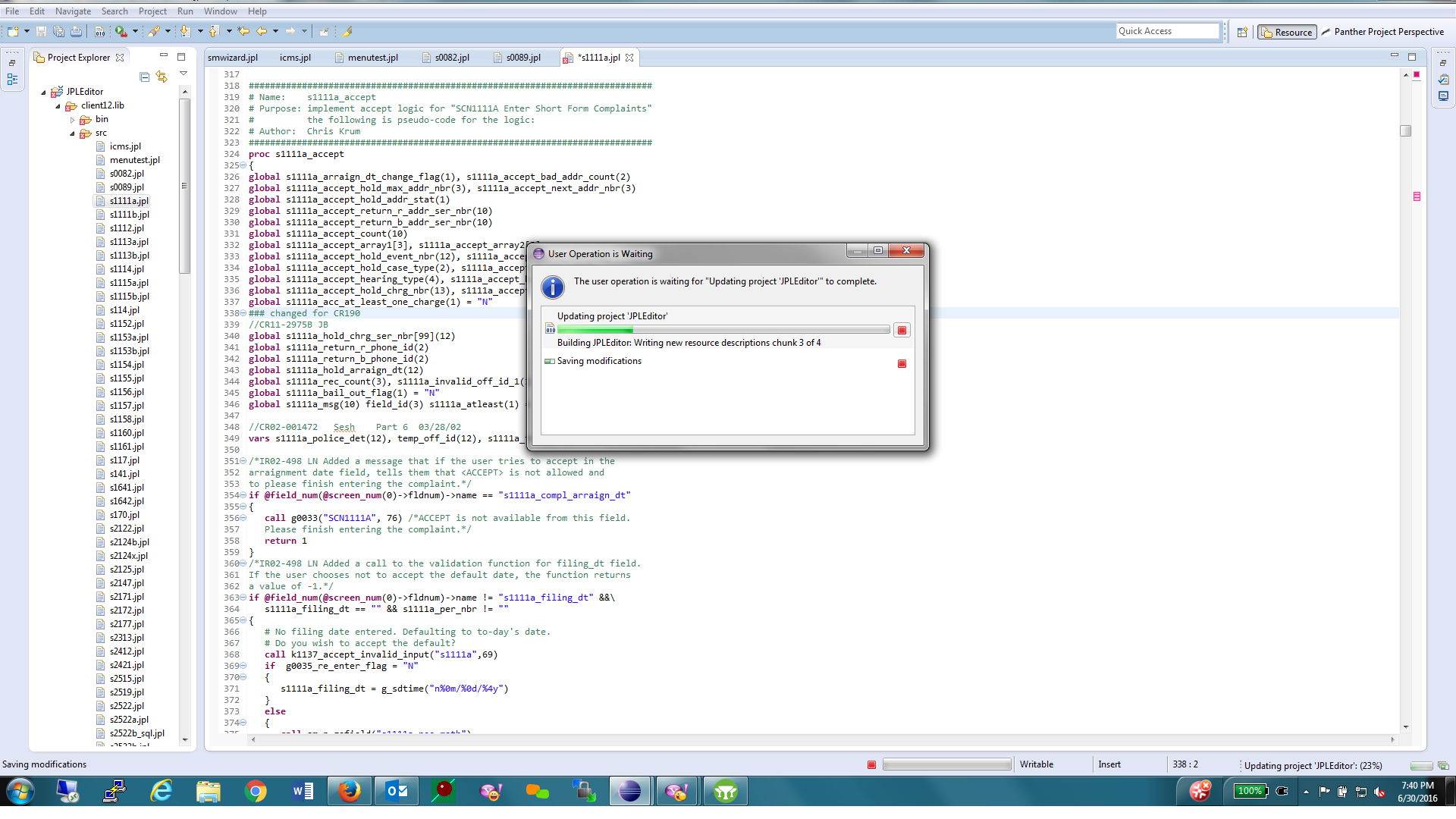

I Did it but no luck. When I edit my dsl file and on saving screen is hanging.
index.php/fa/26309/0/
