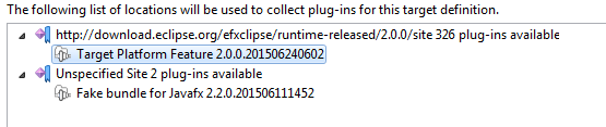

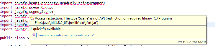

Re: Splash screen [message #1712922 is a reply to message #1712829] Thu, 29 October 2015 07:40 Go to previous messageGo to next message
Hi Tom,
I downloaded nightly build from downloads.efxclipse.bestsolution.at/downloads/nightly/sdk/ and facing some issues in setup.
My default target definition is showing
index.php/fa/23780/0/
I am getting access restriction error for JAVA fx as
index.php/fa/23781/0/

Re: Splash screen [message #1712937 is a reply to message #1712922] Thu, 29 October 2015 09:17 Go to previous messageGo to next message
It looks like the org.eclipse.fx bundles could not be started - try:
diag 260
or some of the other bundles who only got into the INSTALLED state to
see what's going on.
Tom

On 29.10.15 04:40, Milankumar Ardeshana wrote:
> Hi Tom,
> And in new project am not able to see the JAVAFx Projects.
> My OSGI console output is as below
> WARNING: This console is connected to the current running instance of Eclipse!
> osgi> ss org.eclipse.fx
> "Framework is launched."
> id State Bundle
> 2 RESOLVED org.eclipse.fx.osgi_2.1.0.201509090501
> Master=0
> 237 STARTING org.eclipse.fx.code.editor.ldef_2.1.0.201509090602
> 238 STARTING org.eclipse.fx.code.editor.ldef.ui_2.1.0.201509090707
> 239 INSTALLED org.eclipse.fx.core_2.1.0.201509090602
> 240 INSTALLED org.eclipse.fx.core.guice_2.1.0.201509090602
> 241 STARTING org.eclipse.fx.formats.svg_2.1.0.201509090602
> 242 INSTALLED org.eclipse.fx.ide.converter_2.1.0.201509090707
> 243 STARTING org.eclipse.fx.ide.css_2.1.0.201509090707
> 244 INSTALLED org.eclipse.fx.ide.css.cssext_2.1.0.201509090707
> 245 INSTALLED org.eclipse.fx.ide.css.cssext.proposals_2.1.0.201509090707
> 246 INSTALLED org.eclipse.fx.ide.css.cssext.ui_2.1.0.201509090707
> 247 STARTING org.eclipse.fx.ide.css.jfx2_2.1.0.201509090707
> 248 STARTING org.eclipse.fx.ide.css.jfx8_2.1.0.201509090707
> 249 INSTALLED org.eclipse.fx.ide.css.ui_2.1.0.201509090707
> 250 STARTING org.eclipse.fx.ide.fxgraph_2.1.0.201509090707
> 251 STARTING org.eclipse.fx.ide.fxgraph.ui_2.1.0.201509090707
> 252 ACTIVE org.eclipse.fx.ide.fxml_2.1.0.201509090707
> 253 RESOLVED org.eclipse.fx.ide.fxml.compiler_2.1.0.201509090707
> 254 ACTIVE org.eclipse.fx.ide.java6_2.1.0.201509090707
> 255 INSTALLED org.eclipse.fx.ide.jdt.core_2.1.0.201509090707
> 256 INSTALLED org.eclipse.fx.ide.jdt.ui_2.1.0.201509090707
> 257 STARTING org.eclipse.fx.ide.l10n_2.1.0.201509090707
> 258 STARTING org.eclipse.fx.ide.l10n.ui_2.1.0.201509090707
> 259 ACTIVE org.eclipse.fx.ide.model_2.1.0.201509090707
> 260 INSTALLED org.eclipse.fx.ide.pde.core_2.1.0.201509090707
> 261 INSTALLED org.eclipse.fx.ide.pde.ui_2.1.0.201509090707
> 262 INSTALLED org.eclipse.fx.ide.pde.ui.e4_2.1.0.201509090707
> 263 STARTING org.eclipse.fx.ide.rrobot_2.1.0.201509090707
> 264 STARTING org.eclipse.fx.ide.rrobot.dsl_2.1.0.201509090707
> 265 STARTING org.eclipse.fx.ide.rrobot.dsl.ui_2.1.0.201509090707
> 266 STARTING org.eclipse.fx.ide.rrobot.model_2.1.0.201509090707
> 267 STARTING org.eclipse.fx.ide.ui_2.1.0.201509090707
> 268 RESOLVED org.eclipse.fx.ide.ui.mobile.sim.device_2.1.0.201509090707
> 269 INSTALLED org.eclipse.fx.ide.ui.mobile.sim.launch_2.1.0.201509090707
> 270 STARTING org.eclipse.fx.ide.ui.preview_2.1.0.201509090707
> 271 STARTING org.eclipse.fx.javafx_2.2.0.201509090501
> 272 INSTALLED org.eclipse.fx.osgi.util_2.1.0.201509090602
> 273 RESOLVED org.eclipse.fx.ui.animation_2.1.0.201509090602
> 274 INSTALLED org.eclipse.fx.ui.controls_2.1.0.201509090602
> 275 RESOLVED org.eclipse.fx.ui.mobile_2.1.0.201509090602
> 276 RESOLVED org.eclipse.fx.ui.panes_2.1.0.201509090602
> 277 RESOLVED org.eclipse.fx.ui.workbench3_2.1.0.201509090501
icon14.gif  Re: Splash screen [message #1713034 is a reply to message #1712938] Fri, 30 October 2015 01:49 Go to previous messageGo to next message
Ohh Sorry. My bad.
I changed my target definition in my previous setup to : http://download.eclipse.org/efxclipse/runtime-nightly/site
But it was not working as in my launch file org.eclipse.jdt.launching.PROGRAM_ARGUMENTS there was -nosplash.
I removed that and it worked perfectly as expected.
Hope we can have progress bar soon. Smile

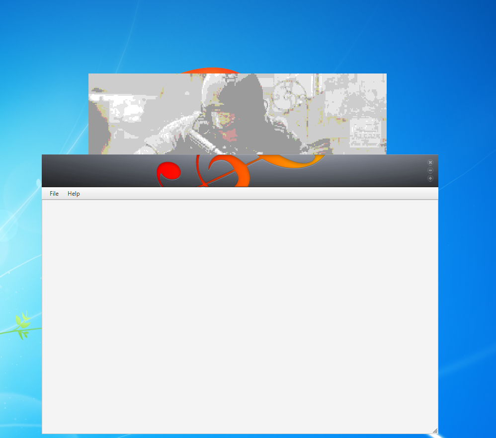

Re: Splash screen [message #1713283 is a reply to message #1713034] Tue, 03 November 2015 00:04 Go to previous messageGo to next message
Hi Tom,
My Splash is visible behind the application.
Is there any solution for this?
index.php/fa/23808/0/
Milan

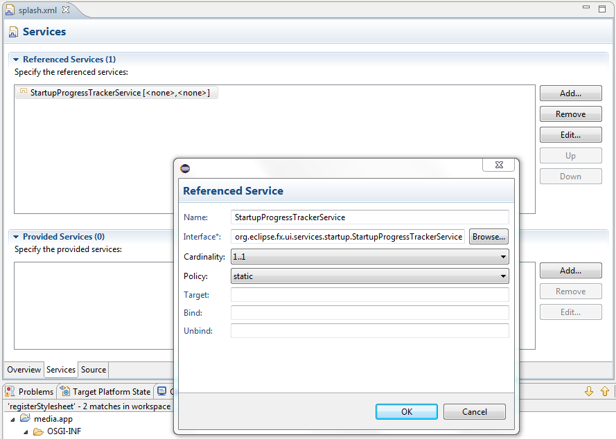

Re: Splash screen [message #1723062 is a reply to message #1722943] Thu, 11 February 2016 05:54 Go to previous messageGo to next message
Hi Bastien / Tom,
I am very curious to use splash. I am trying to use the service StartupProgressTrackerService. But my debug point is not hitting to any of the Sysouts in below code. Here is what i am doing. please correct me. I am really new to osgi service and its usage.
1) create new-->Plugindevelopment--> Component Defintion. Splash.xml
<scr:component xmlns:scr="http://www.osgi.org/xmlns/scr/v1.1.0" configuration-policy="require" immediate="true" name="media.app">
   <implementation class="media.app.splash.Splash"/>
   <reference cardinality="1..1" interface="org.eclipse.fx.ui.services.startup.StartupProgressTrackerService" name="StartupProgressTrackerService" policy="static"/>
</scr:component>
2)Created class Splash as below
import org.eclipse.equinox.app.IApplicationContext;
import org.eclipse.fx.ui.services.startup.StartupProgressTrackerService;
public class Splash implements StartupProgressTrackerService {
	public Splash() {
	public OSGiRV osgiApplicationLaunched(IApplicationContext applicationContext) {
		System.out.println();
		return null;
	public void stateReached(ProgressState state) {
And in logs i am getting four times
!ENTRY media.app 4 0 2016-02-11 16:21:49.345
!MESSAGE [SCR] Component definition XMLs not found in bundle media.app. The component header value is splash.xml
Milan
  • Attachment: 1.PNG
    (Size: 44.99KB, Downloaded 335 times)
Re: Splash screen [message #1723068 is a reply to message #1723062] Thu, 11 February 2016 06:07 Go to previous messageGo to next message
You are defining a reference which is wrong! You are publishing
StartupProgressTrackerService so you need to use
StartupProgressTrackerService in the provided-service section.
Tom

Check if your xml file is selected in the build.properties file / bin.includes
Re: Splash screen [message #1723249 is a reply to message #1723190] Fri, 12 February 2016 12:37 Go to previous messageGo to next message
hi bastien /tom,
Yes its checked in build.properties.
I dont know why its not hitting debug point, Where its hitting for org.eclipse.fx.ui.services.theme.Theme in theme-default.xml of media application in class --> media.app.themes.DefaultTheme
Milan
  • Attachment: media.zip
    (Size: 8.28MB, Downloaded 281 times)

Tom,
do u know if there is a trick for this bug?
https://bugs.eclipse.org/bugs/show_bug.cgi?id=418399
I tried the solution proposed by Pawel Zalejko but it doesnt work for me.
Do u have a solution to make disapear the splash? The target is only Windows 7.
Thx
Re: Splash screen [message #1723257 is a reply to message #1723253] Fri, 12 February 2016 13:34 Go to previous messageGo to next message
You need to call the splash hide from the correct thread ;-)
Steps got easier because we now ship 2 applications:
* org.eclipse.fx.ui.workbench.fx.application => launches on an arbitary
thread
* org.eclipse.fx.ui.workbench.fx.main-thread-application => launches on
the main thread
So first step:
* open the .product and change from .application to .main-thread-
application
* Click synchronize in the testing section (this will modify your
.app/plugin.xml) - as an alternative you could have modified the
plugin.xml yourself
* You already have a StartupProgressTrackerService in the
osgiApplicationLaunched call IApplicationContext#applicationRunning
=> this is the last method called from the launching thread
afterwards you are in the JavaFX thread and the splash won't hide
The current draw backs:
* does not work on OS-X
* there's a short time without a splash (the time between the native
splash is hidden and the JavaFX bootsrapping is done and you show a
FX-Stage)
I've looked in this whole story and whenever I see someone from the
JavaFX-Packager Team I explain them that the current state of not having
a native splash is a none starter. We also looked in to writing our own
launcher because with the FX-Packager restart does not work either we've
not yet managed to find someone sponsoring such a development nor did we
implement such a none-opensource extension yet.
Tom
On 12.02.16 19:15, Bastien Bart wrote:
> Tom,
> Windows 7.
> Thx
