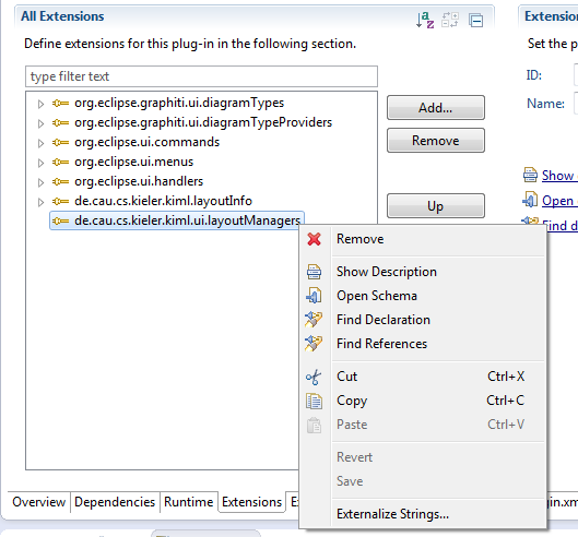

But there are still some problems with the alignment of KIELER to my own datamodel. In the eTrice project I've seen that they've implemented theyr own type of GaphitiDiagramLayoutManager. I've made the same. But when I want to define my own manager in the extension "de.cau.cs.kieler.kiml.ui.layoutManagers" no manager could be defined, like you can see in the picture.
Am I on the right way? Does anyone of you has an idea how to solve the problem?

As you seem to have understood, you need to add an extension for the
extension point de.cau.cs.kieler.kiml.ui.layoutManagers and refer to an
implementation of IDiagramLayoutManager, usually a subclass of
GraphitiDiagramLayoutManager. Here's how the extension is defined in my
plugin.xml:
<extension point="de.cau.cs.kieler.kiml.ui.layoutManagers">
<manager
class="org.ptolemy.graphiti.generic.kieler.ActorDiagramLayoutManager"/>
</extension>
In your subclass you will typically override the supports method, to
make the layout apply to your specific objects.
public boolean supports(Object pictogramElement) { ... }
Note that this method is not called on you domain objects, but on some
graphical object (PictogramElement), so you may need to lookup the
underlying domain object. It may be that the existing implementation
works for you, in case you do not necessarily need to create your own
subclass.
