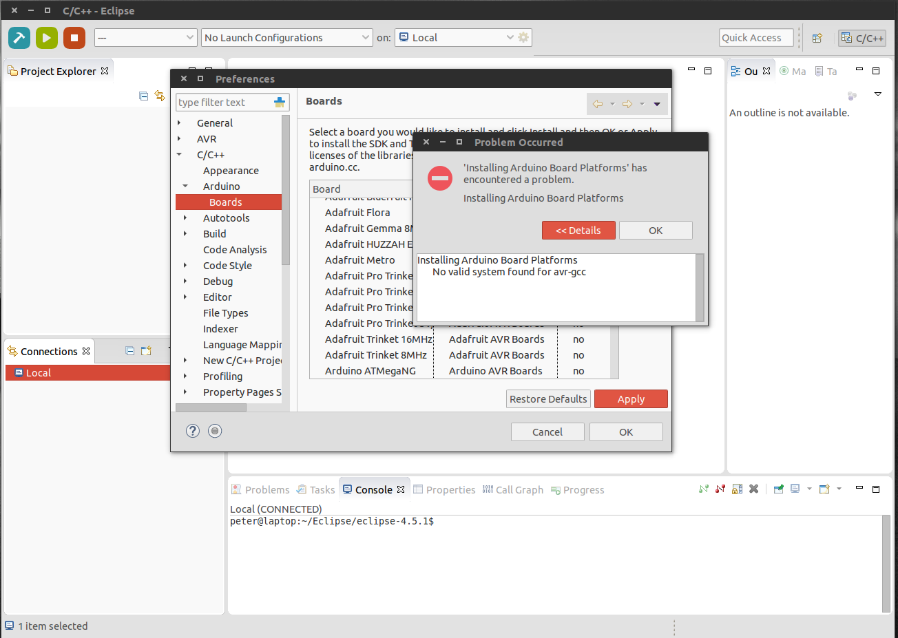

Need some help here. I'm new to Eclipse so bear with me.
I followed your YouTube tutorial using Ubuntu 14.04. When i try to install my board (Arduino Leonardo) i get "No valid system found for avr-gcc". I installed the toolchain using
sudo apt-get install gcc-avr binutils-avr gdb-avr avr-libc avrdude
but the error is still there.

Re: Introducing the Arduino C++ IDE [message #1711775 is a reply to message #1711745] Mon, 19 October 2015 11:03 Go to previous messageGo to next message
@Peter The Arduino C++ doesn't use the avr-gcc found on the system. It installs it's own from the Arduino web site.
I have to admit I haven't tested Linux yet. I'll give it a try and see if I can reproduce this. The error dialog is telling me it can't find a version of avr-gcc to run on your system. Please raise a bug so I don't forget. Thanks!

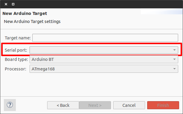

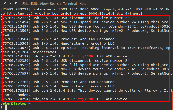

Re: Introducing the Arduino C++ IDE [message #1712378 is a reply to message #1711630] Fri, 23 October 2015 08:23 Go to previous messageGo to next message
Hi again,
I need more help with Eclipse.
My issue now is that Eclipse don't recognize my /dev/ttyACM0 as a serial device. The kernel detects the device when i hook up my Arduino Leonardo through USB:
index.php/fa/23681/0/
Eclipse don't when i try to create a new connection:
index.php/fa/23682/0/
I have tried to add "-Dgnu.io.rxtx.SerialPorts=/dev/ttyACM0" to the eclipse.ini file as they describe in this thread:
https://github.com/jantje/arduino-eclipse-plugin/issues/7
The strange thing is that Arduino IDE finds the device and everything works.
What am I doing wrong?

Re: Introducing the Arduino C++ IDE [message #1712385 is a reply to message #1712378] Fri, 23 October 2015 10:09 Go to previous messageGo to next message
You're doing nothing wrong. Please raise a bug. I don't have support for serial ports of that name pattern. I can easily add it though.
BTW, we're not using rxtx. CDT has it's own native serial support and I'm using that.

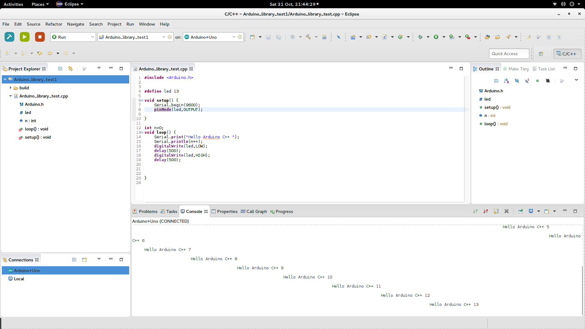

Re: Introducing the Arduino C++ IDE [message #1713120 is a reply to message #1711630] Sat, 31 October 2015 16:15 Go to previous messageGo to next message
Hello ;
I did everything I setup my arduino system and I had two problems so far.
1. How can I add custom library without click properties/library part because when I put the library files (zip file) under .arduinocdt/libraries/ It's not working. Is there any config file I need to know about that.
2 . I have problem with serial monitor because when I type "println" It's still go further and make really ugly screen(It's in attachment)
