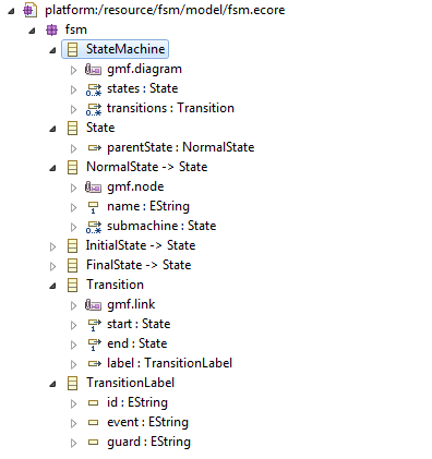

The question is about using aql (Acceleo Query Language) in Sirius. I have meta-model for a simple fsm (as attached in this post index.php/fa/23736/0/).
I am trying to auto-increment the label of a NormalState when I create in on the canvas. My setname() query is:
aql: 'S'+container.states->filter(container.states::NormalState)->size()
I don't see why it doesn't work! However when I use the following query, it works!
aql: 'S'+container.states->size()
The thing is that there are three types of states: Initial,Final and Normal states. I want to count the Normal States and not include initial and final states in the size/count.
Parsa
  • Attachment: fsm.png
    (Size: 14.02KB, Downloaded 2011 times)

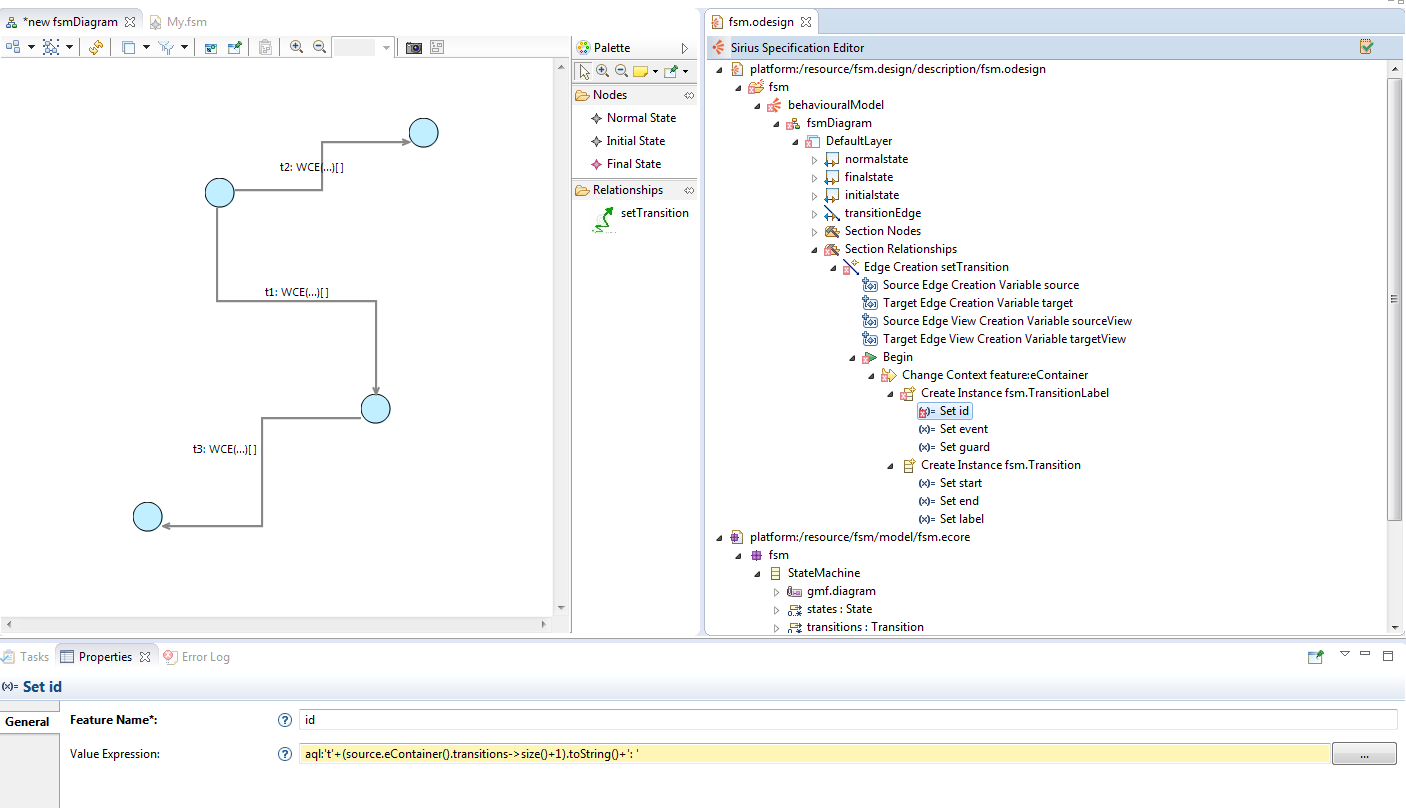

Re: AQL expression for setname() in Sirius [message #1713027 is a reply to message #1712914] Thu, 29 October 2015 18:47 Go to previous messageGo to next message
Hi Maxime,
Thanks, I have added the dependency, still didn't work. but that's ok, I will drop it for now and will wait for new release.
However, I have another query. I want to auto number the transition labels such as t1, t2 , t3 ...
I used the following query:
aql:'t'+(source.eContainer().transitions->size()+1).toString()+': '
the funny part is that it actually works , but when I validate my VSM it throw an error: "Feature transitions not found in EClass NormalState".
Why is it looking for transition in Normal state. I used source.eContainer(), where source is the normal state the transition connects to. And I suppose source.eContainer will be StateMachine ... Just confused, if it is an error then why it works ? Very Happy
index.php/fa/23784/0/
index.php/fa/23785/0/
Parsa
  • Attachment: metamodel.png
    (Size: 12.80KB, Downloaded 1847 times)
  • Attachment: VSM.png
    (Size: 76.42KB, Downloaded 2006 times)
[Updated on: Thu, 29 October 2015 18:48] by Moderator
Re: AQL expression for setname() in Sirius [message #1713048 is a reply to message #1713027] Fri, 30 October 2015 05:53 Go to previous messageGo to next message
Le 29/10/2015 23:47, Parsa Pourali a écrit :
> Hi Maxime,
> Compilation error for expression [eContainer().eGet(transitions)->size()/] : Unrecognized variable: (transitions)
It is "simple" : eContainer() returns an EObject and "transitions" is
not defined for EObject. You must "cast" the result of eContainer() if
you want that the validation is OK.
> It says that "Feature transitions not found in EClass NormalState".
> Why is it looking for transition in Normal state. I used source.eContainer(), where source is the normal state the transition connects to. And I suppose source.eContainer will be StateMachine ... Just confused, if it is an error then why it works ? :d
At runtime the real object returned by eContainer() is a StateMachine,
so at runtime the "eContainer().eGet(transitions)" works.
> Thanks,
> Parsa
Laurent Redor - Obeo
