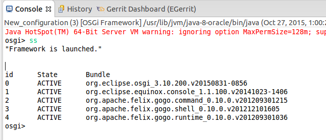

Re: Standard OSGi launch configuration Equinox 3.11 [message #1712722 is a reply to message #1712695] Tue, 27 October 2015 13:03 Go to previous messageGo to next message
I just created a launch configuration with the bundles you mention and I've been able to start the app just fine.
(see screenshot)
Be sure to create a launch configuration of type "OSGi Framework"

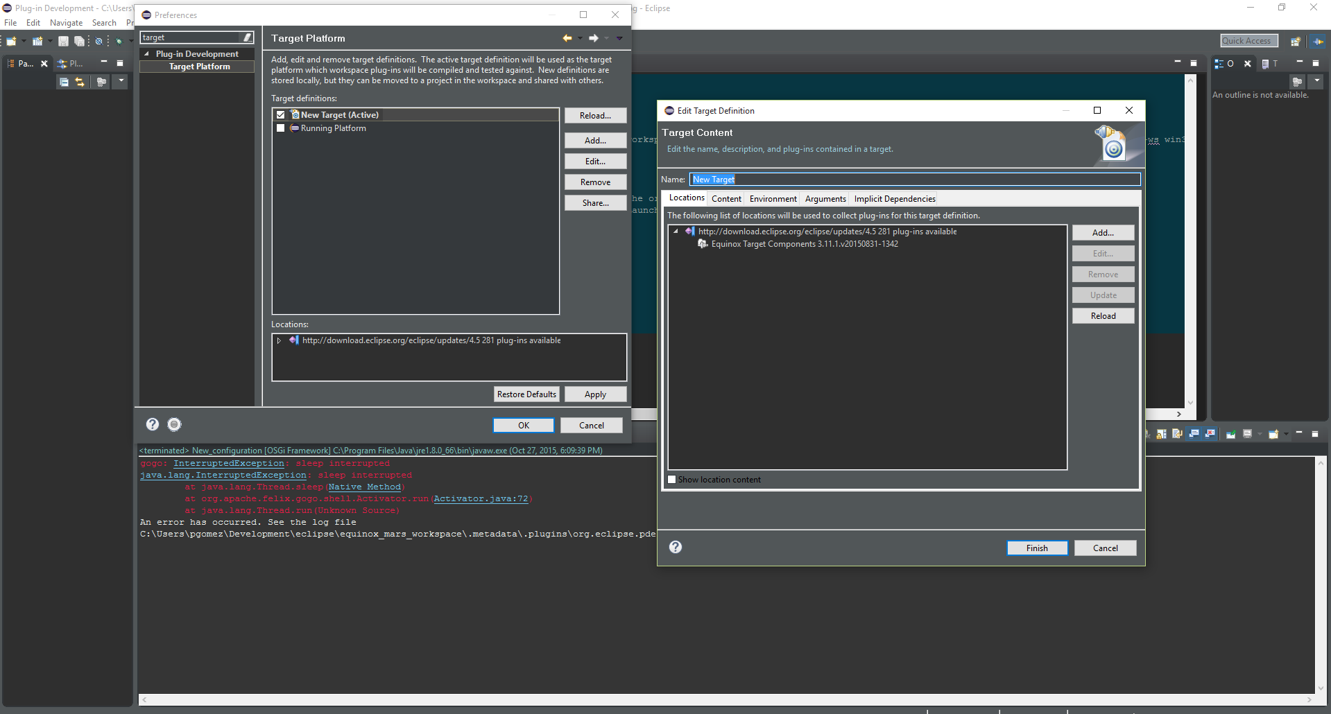

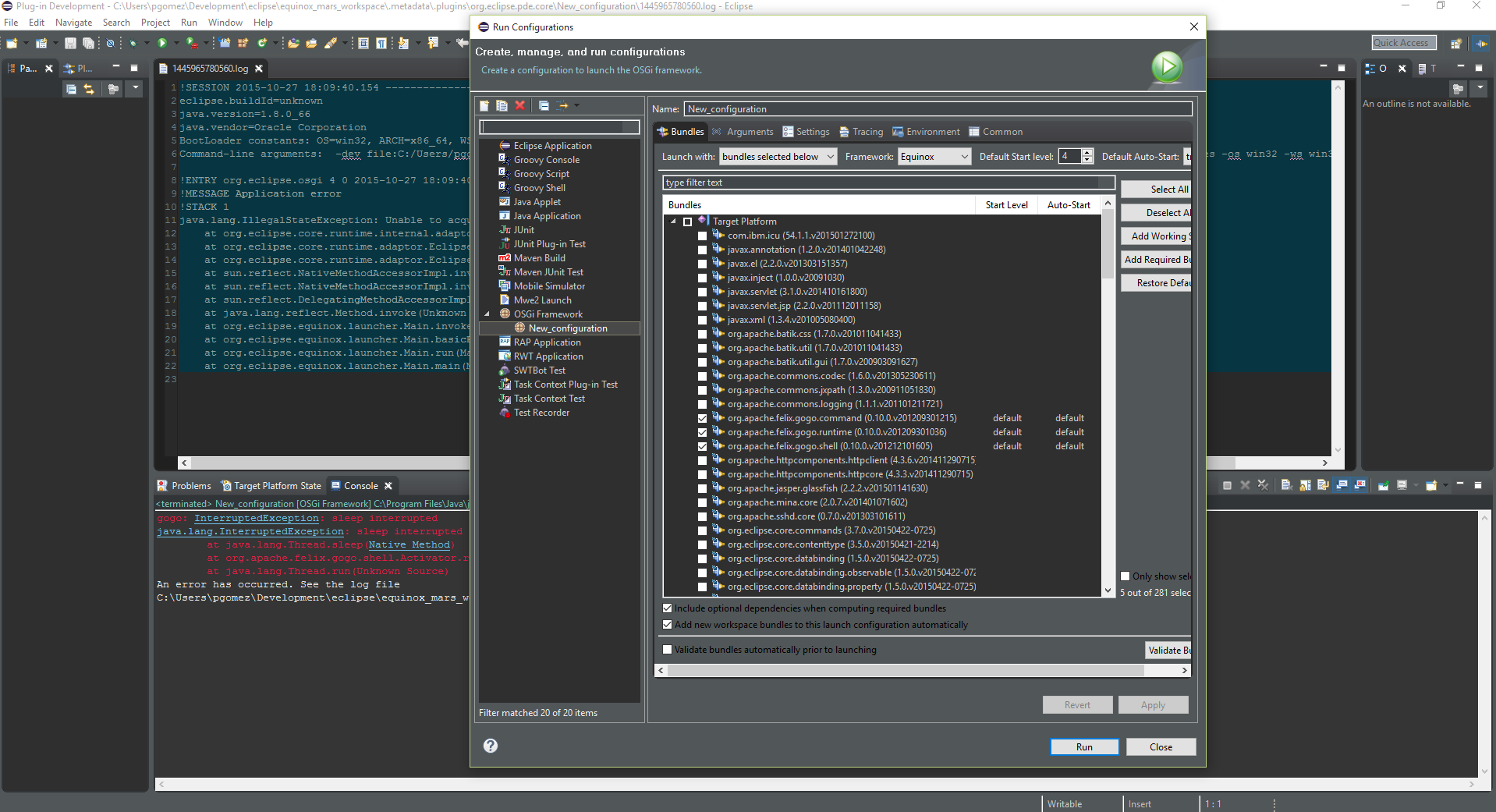

Re: Standard OSGi launch configuration Equinox 3.11 [message #1712726 is a reply to message #1712695] Tue, 27 October 2015 13:17 Go to previous messageGo to next message
I've tried now with only these 4 bundles -no bundle in the workspace-
org.eclipse.osgi
org.apache.felix.gogo.command
org.apache.felix.gogo.runtime
org.apache.felix.gogo.shell
org.eclipse.equinox.console
And no luck. By the way I'm testing on a Windows 10 machine
and Java(TM) SE Runtime Environment (build 1.8.0_66-b17)
see attached pictures
Anyway I will retry with a new workspace with no bundles, just the 5 I've mentioned. I'll try too with a linux machine case that makes a difference
  • Attachment: mars.PNG
    (Size: 216.05KB, Downloaded 574 times)
  • Attachment: target.PNG
    (Size: 111.72KB, Downloaded 675 times)

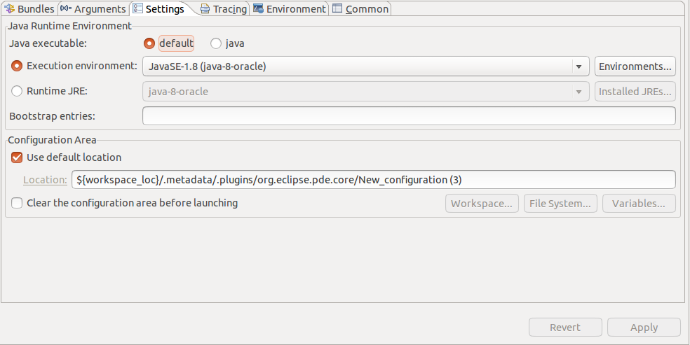

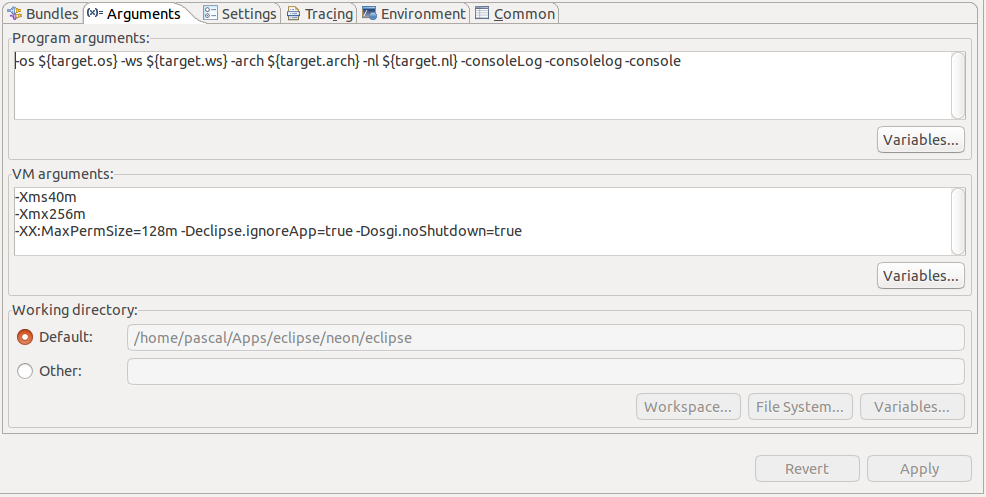

Re: Standard OSGi launch configuration Equinox 3.11 [message #1712728 is a reply to message #1712726] Tue, 27 October 2015 13:29 Go to previous messageGo to next message
I highly suspect that somewhere on the CLI you have -application or something like that.
Here are screenshots of my configuration. Aside from the list of bundles that I have changed to only include the 5 bundles, everything else contains the default parameters. However know that those are generated from the target plaform, and my target platform is different than yours.

Re: Standard OSGi launch configuration Equinox 3.11 [message #1712743 is a reply to message #1712695] Tue, 27 October 2015 16:07 Go to previous message
ok, I found out the problem, the thing was that it seems necessary to provide the following arguments to the VM:
-Declipse.ignoreApp=true -Dosgi.noShutdown=true
and in my case that was missing and I certainly was not aware about the need of such a flags. But now it works Smile
regards
