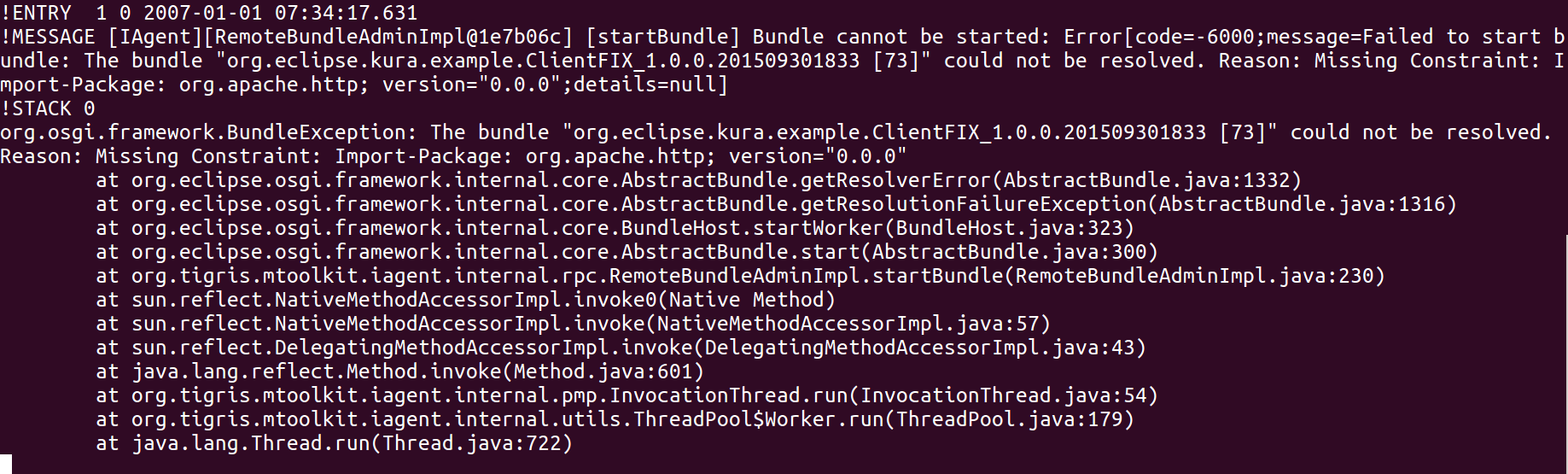

Re: How to import external .jar and use it in a bundle [message #1709288 is a reply to message #1709217] Fri, 25 September 2015 12:07 Go to previous messageGo to next message
Thanks for your answers!
I have used the Amit's option "two" and I have inserted the path of the jar files (about org.apache.httpclient) in bundle's MANIFEST.
During the writing of Java code I haven't any problem, but when I have installed the bundle in Kura, I have had a series of error.
I attach kura-console.log's output about it.
Thanks for your help!
Re: How to import external .jar and use it in a bundle [message #1709292 is a reply to message #1709288] Fri, 25 September 2015 12:27 Go to previous messageGo to next message
Hi Silvio,
I think something went wrong with your OSGi Container and that's why the framework couldn't find the some of the bundles. Would you please check if this does happen only when you try to install your own bundle or it stays same even when you don't install your bundle. If it is happening due to your bundle, I would advise you to host your source code either in Bitbucket or Github so that we can try solving your issue.
Thanks and Regards,

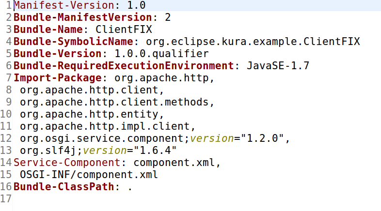

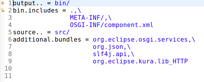

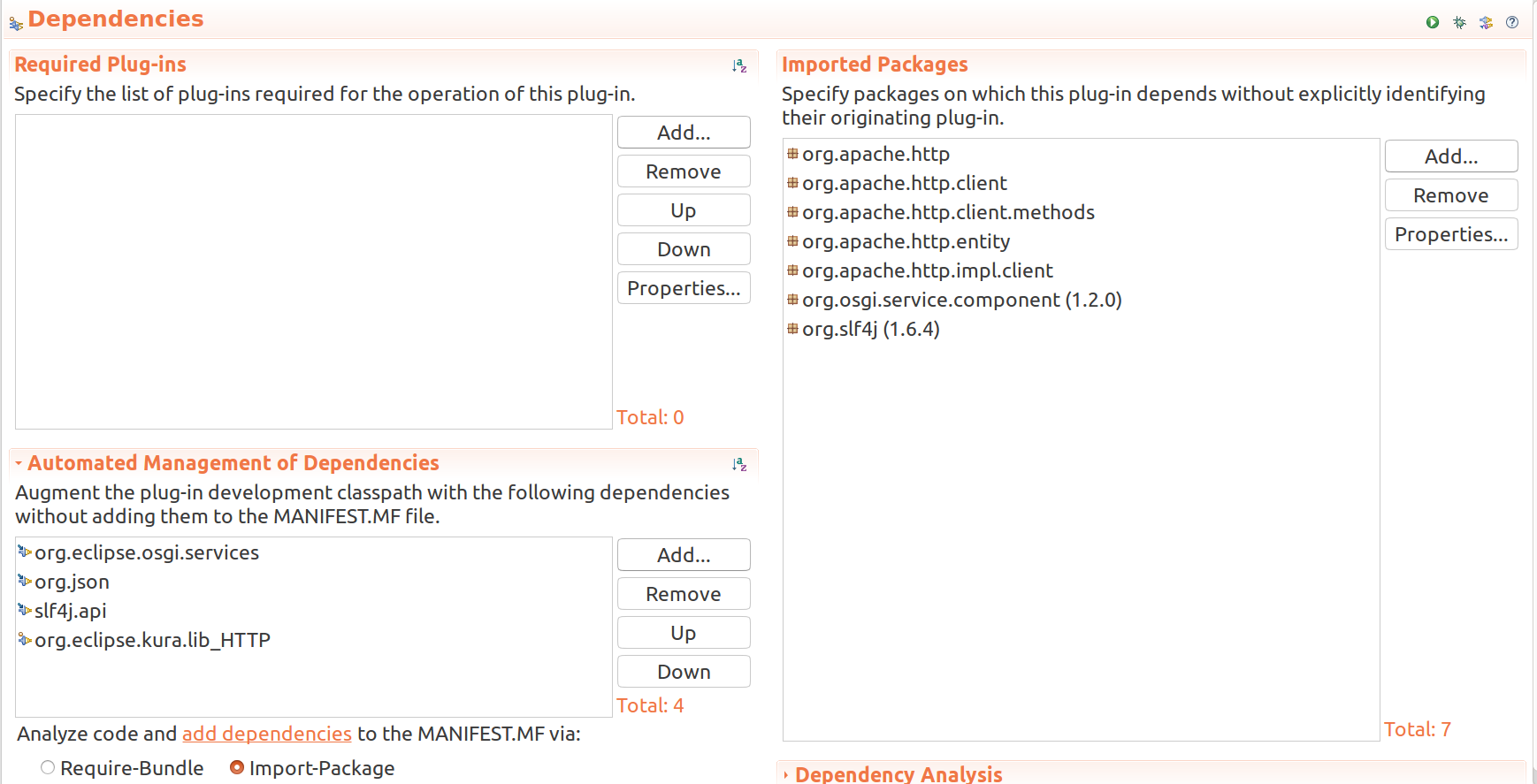

Hi to all.
I'd like to add to this discussion bacause i ran into a similar trouble. i've followed the first advice of Amit and i tried to add more external jars building a new bundle (org.eclipse.kura.lib_HTTP) and adding it to the main bundle (org.eclipse.kura.example.clientFIX). I'm trying to do a simple Http request.
I hope to help you to understand better by posting my screens.
Any advice?
Thanks in advance.

Re: How to import external .jar and use it in a bundle [message #1709784 is a reply to message #1709751] Thu, 01 October 2015 02:13 Go to previous messageGo to next message
Hi Joseph,
As you have already provided all necessary source code, I can see that in your build.properties file there are two warnings. I would advise you to correct them first. Secondly, the exception says that your HTTP Consumer Bundle can't be resolved as it has a missing dependency. It can't find org.apache.http package as it has to import this package to resolve consumer bundle. You have to install the bundle to your OSGi container which exposes the respective package (org.apache.http). After you install the bundle, start it so that your consumer bundle can import its relevant packages for resolution.
N.B: If you have already installed the apache http bundle, make sure it's started. Sometimes you can even confront that dependency bundles are not even started as those might need other dependencies for resolution. In such scenario, you have to install those needed dependencies as well.

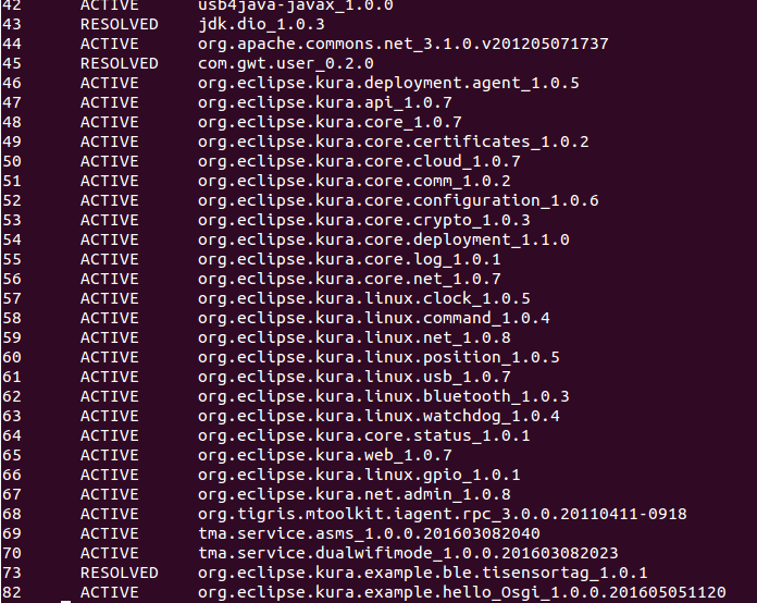

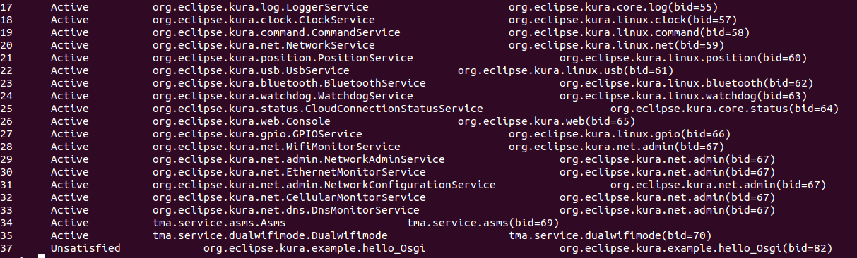

Re: How to import external .jar and use it in a bundle [message #1731415 is a reply to message #1731365] Thu, 05 May 2016 00:42 Go to previous messageGo to next message
Thank David for your reply.
I know Kura has exist paho mqtt through DataService class.
But I don't want to touch deeply to Kura Core.
I just want to write some simple API for my private purpose.
It the reason that I want to call and use independently "paho mqtt".
I also try to use "org.eclipse.paho.client.mqttv3_1.0.1.jar" from "../kura-KURA_1.4.0_RELEASE/kura/target-definition/common/repository/plugins".
But it still not effect.
Please review the output od "ss" & "ls" from my attached file.
Thank a lot.
p/s: My bundle's name is org.eclipse.kura.example.hello_Osgi

Re: How to import external .jar and use it in a bundle [message #1731561 is a reply to message #1731415] Fri, 06 May 2016 15:10 Go to previous messageGo to next message
The service you are trying to register is unsatisfied (output of ls command). From the OSGi console, please provide the output of 'comp 37'. Also, can you please post your bundles MANIFEST.MF file?
--Dave

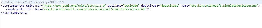

Re: How to import external .jar and use it in a bundle [message #1748394 is a reply to message #1748347] Tue, 22 November 2016 12:29 Go to previous messageGo to next message
Hi Patrick,
I don't think the issue is related to your included JARs, the error I am seeing is that the bundle loader cannot find your class:
java.lang.ClassNotFoundException: com.stihl.example.cloudClient.Client
Can you please post the contents of your component XML file?
--Dave

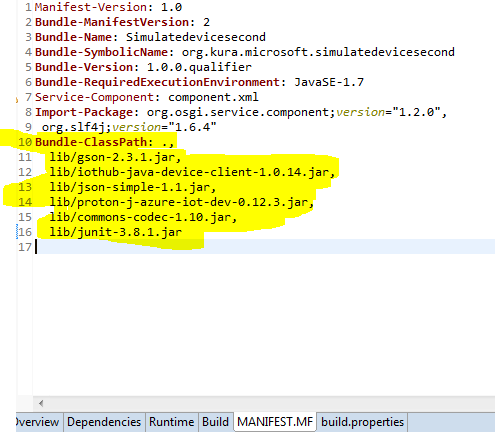

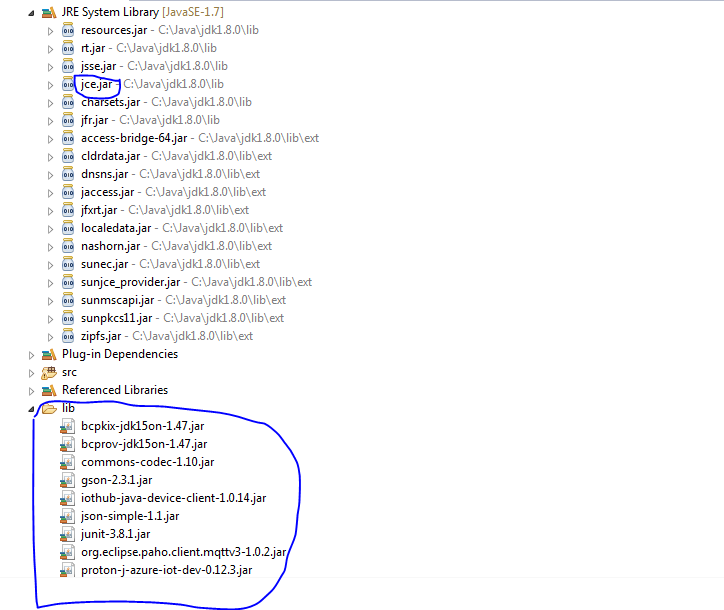

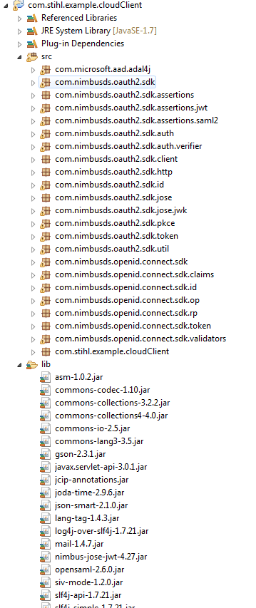

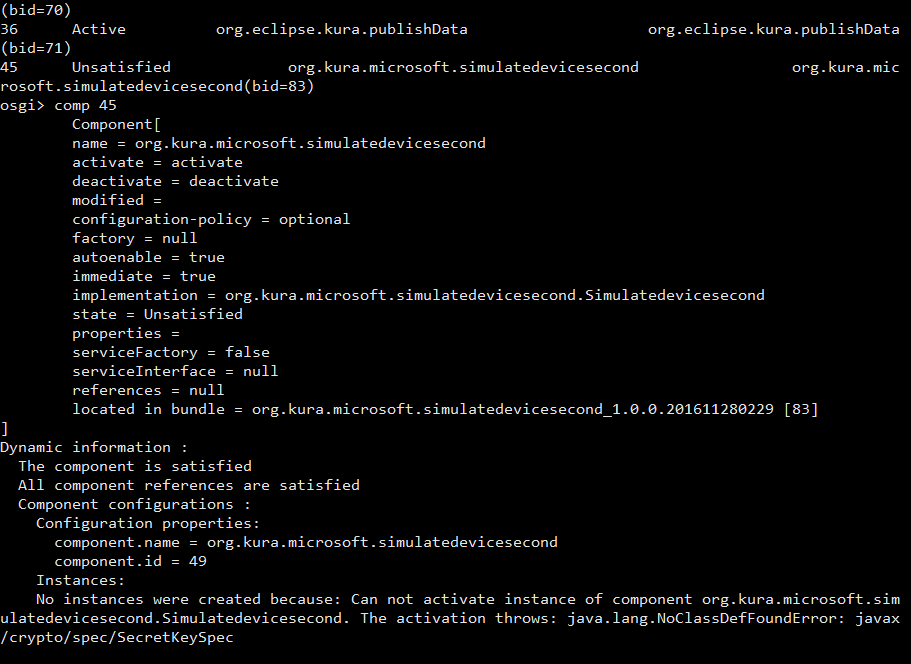

Re: How to import external .jar and use it in a bundle [message #1748719 is a reply to message #1748394] Sun, 27 November 2016 14:52 Go to previous messageGo to next message
Hi David & all,
I also have near problems as Patric.
I try to integrate Kura to Azure IoT Hub.
I inserted all external jar lib folder and add "Bundle-ClassPath" to Manefist.
But I have reached this problem:
 No instances were created because: Can not activate instance of component org.kura.microsoft.simulatedevicesecond.Simulatedevicesecond. The activation throws: java.lang.NoClassDefFoundError: javax/crypto/spec/SecretKeySpec
I try to find and realized that javax/crypto/spec/SecretKeySpec is a class in jce.jar (existed in java jdk).
So i don't know how to fix this error.Please help me
Abel

Re: How to import external .jar and use it in a bundle [message #1748814 is a reply to message #1748719] Mon, 28 November 2016 21:59 Go to previous messageGo to next message
Does any one have any idea to help me?
Please let me know,direction or something useful.
Re: How to import external .jar and use it in a bundle [message #1748890 is a reply to message #1748814] Tue, 29 November 2016 14:39 Go to previous message
I believe you need to add javax.crypto.spec to your MANIFEST.MF import list.
