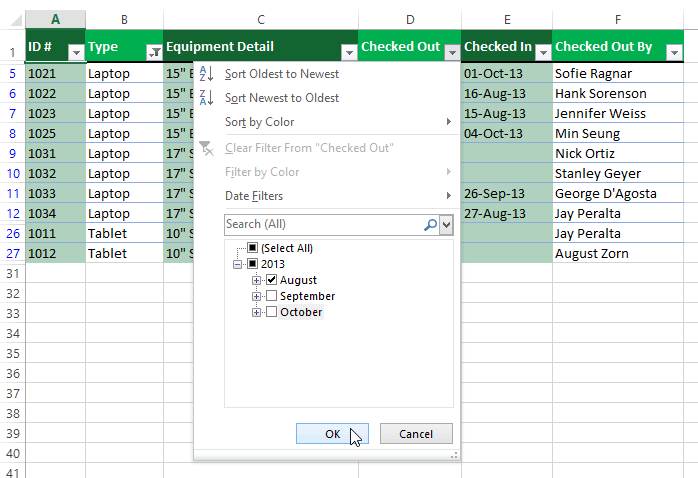

I'm trying to implement a quick search feature in the excel like filters for my nattable. Something like the Excel filters have (See upload).
Can I somehow combine the text filter (FilterRowHeaderComposite) with the combobox filter (ComboBoxFilterRowHeaderComposite) as to have a cell where I can type some text and filter the combobox filter list?
Is there any simple way to do this without using the Painter to create a new UI component that runs like the excel like filter only with the added textbox to filter the comboboxes?
If this doesn't work, can I somehow have two header rows, one for Comboboxes and one for Text filter?
Any ideas?

			if(i>2)
			configRegistry.registerConfigAttribute(
					EditConfigAttributes.CELL_EDITOR,
					new FilterRowTextCellEditor(), DisplayMode.NORMAL,
					FilterRowDataLayer.FILTER_ROW_COLUMN_LABEL_PREFIX + i);
In my custom Configuration I have only the registerConfig or the first column:
				EditConfigAttributes.CELL_EDITOR, this.cellEditor,
				DisplayMode.NORMAL,
				FilterRowDataLayer.FILTER_ROW_COLUMN_LABEL_PREFIX + 0);
This instead, makes for only my first 3 columns being ok and the regular filters glitching out.
How can I add a regular FilterRowLayer on the rest of the columns? I can't seem to mix ComboBox filters and Regular filters on the same FilterRow, whenever I try to add one the other stops working or glitches out.
What I want to achieve basically is:
Table:
(FilterRow) CustomCombo | NormalCombo | NormalCombo | NormalTextFilter | NormalTextFilter | ... | NormalTextFilter
