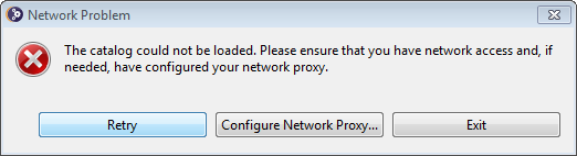

Re: Import custom .setup file into default eclipse-installer [message #1708579 is a reply to message #1708573] Thu, 17 September 2015 12:10 Go to previous messageGo to next message
Thank you Ed for your reply,
This solution is exactly what i want to do.
Now when i append these lines :
-Doomph.redirection.setups=http://git.eclipse.org/c/oomph/org.eclipse.oomph.git/plain/setups/->http://fff-fild7.esy.es/
or
-Doomph.redirection.setups=http://git.eclipse.org/c/oomph/org.eclipse.oomph.git/plain/setups/->file:/C:/Users/EMAKMEL/Desktop/oomphclipse/oomph-master/ws/oomphproj/
or
-Doomph.redirection.setups=http://git.eclipse.org/c/oomph/org.eclipse.oomph.git/plain/setups/->file:///C:/Users/EMAKMEL/Desktop/oomphclipse/oomph-master/ws/oomphproj/
to eclipse-inst.ini then i get an error that i do not have network access to the files.
Am I doing something wrong ?
Cheers,
Maksim Melnik
  • Attachment: Capture.PNG
    (Size: 10.10KB, Downloaded 180 times)
Re: Import custom .setup file into default eclipse-installer [message #1708581 is a reply to message #1708579] Thu, 17 September 2015 12:18 Go to previous messageGo to next message
Maksim,
All the expected files (the ones you see in Oomph's setup projects),
need to be at that location.
