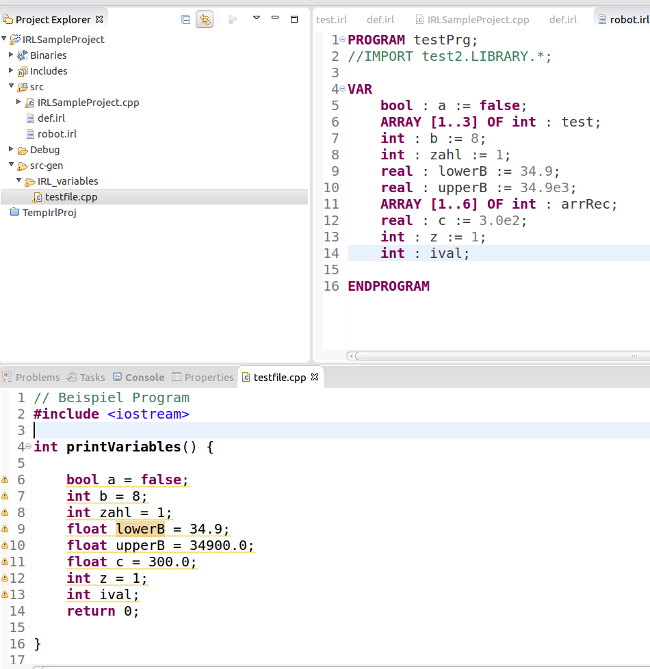

is it possible to (Hyper-)Link the DSL with a generated (C++) file?
After pressing (e.g.) shift+ctrl+ "a DSL object", I want to jump to specific part of the generated file. Is that feasible?
Thank you in advance

Re: Control Variable Assignments [message #1709807 is a reply to message #1709613] Thu, 01 October 2015 05:02 Go to previous messageGo to next message
for hyperlinking I have the URI of another file. Jumping to that file is working with:
>> result.setURI(normalized); (see code above)
But how can I specify also the exact position of that referenced (here) variable with e.g. the offset of that variable in the linked file?
What I have is the IASTFileLocation (= path,offset,length)
Thanks in advance

Re: Control Variable Assignments [message #1709832 is a reply to message #1709814] Thu, 01 October 2015 08:14 Go to previous messageGo to next message
So what I try to do is to tell the XtextHyperlink to consider not only the path of that file as URI (here: curi) but also the position (offset, length) of a sepcific variable (here as IASTFIleLocation location).
The sample project looks like this:

still the question. where does the hyplink point to? xtext cannot know in which line in a non xtext file an object is or not.
so do you use cdt? or what is the stuff you use? the stuff you use can tell you how the links for the stuff you use look like?!?
thus you should not create an xtext hyperlink but an IHyperlink for the tool you use.
thus this is a question on e.g. cdt and not xtext
Re: Control Variable Assignments [message #1709841 is a reply to message #1709837] Thu, 01 October 2015 09:07 Go to previous messageGo to next message
P.S:
i asumes the nodes in cdt provide offset and length. is so you can have your own ihyperlink method
that calls a job that opens the editor and then calls selectandreveal(offset,length) - the same as
LangaugeSpecific/GlobalUriEditorOpener do
Re: Control Variable Assignments [message #1709842 is a reply to message #1709837] Thu, 01 October 2015 09:08 Go to previous messageGo to next message
oh ok. yes you are right... I am using CDT. Then I'll try it with IHyperlink.
Thanks again.
Re: Control Variable Assignments [message #1709959 is a reply to message #1709842] Fri, 02 October 2015 05:12 Go to previous messageGo to next message
I have solved the problem now in a different way. Instead of fighting with IHyperlink...I got the solution in the context of my first approach. What I did is to link still to the cpp-file. When I jump to that file this file gets my active window. With that I focused a variable/object simply with its offset and length:
val XtextHyperlink result = getHyperlinkProvider().get()
result.setHyperlinkRegion(region);
result.setURI(curi);
result.setHyperlinkText(hyperlinkText);
acceptor.accept(result);
if (u != null) {
	val IWorkbenchPage page = PlatformUI.getWorkbench().getActiveWorkbenchWindow().getActivePage();
	val ITextEditor editor = IDE.openEditor(page, _ifile) as ITextEditor;
	editor.selectAndReveal(u.nodeOffset, u.nodeLength);
The problem I have right now is ... that linking/jumping to that generated cpp-file occurs as soon as I click "ctrl" and hover the variable/object. But I want to link when clicking at an object, not during hovering. How can I do this?
Re: Control Variable Assignments [message #1709960 is a reply to message #1709959] Fri, 02 October 2015 05:28 Go to previous messageGo to next message
As i said, you should move that to the open() method of the IHyperlink().
Re: Control Variable Assignments [message #1709962 is a reply to message #1709960] Fri, 02 October 2015 05:37 Go to previous messageGo to next message
That is not the problem. It is working fine. But how can I check if an object is clicked? How can I check a "Clicking" event?
Re: Control Variable Assignments [message #1709963 is a reply to message #1709962] Fri, 02 October 2015 05:40 Go to previous messageGo to next message
no you dont
you simply create the hyperlink
the framework will then call open on it if you click/f3
Re: Control Variable Assignments [message #1709966 is a reply to message #1709963] Fri, 02 October 2015 05:43 Go to previous messageGo to next message
click/f3 is working fine. But is there no event handler for clicking on the editor?
