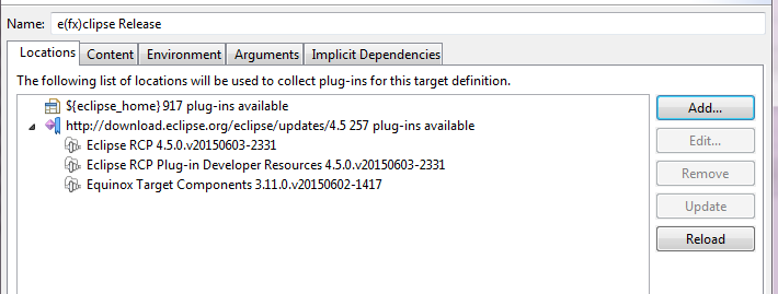

a) you have not setup a target platform
b) you should not click in the product because a valid launch config has already been created
c) you could simply follow http://wiki.eclipse.org/Efxclipse/Tutorials/Tutorial4

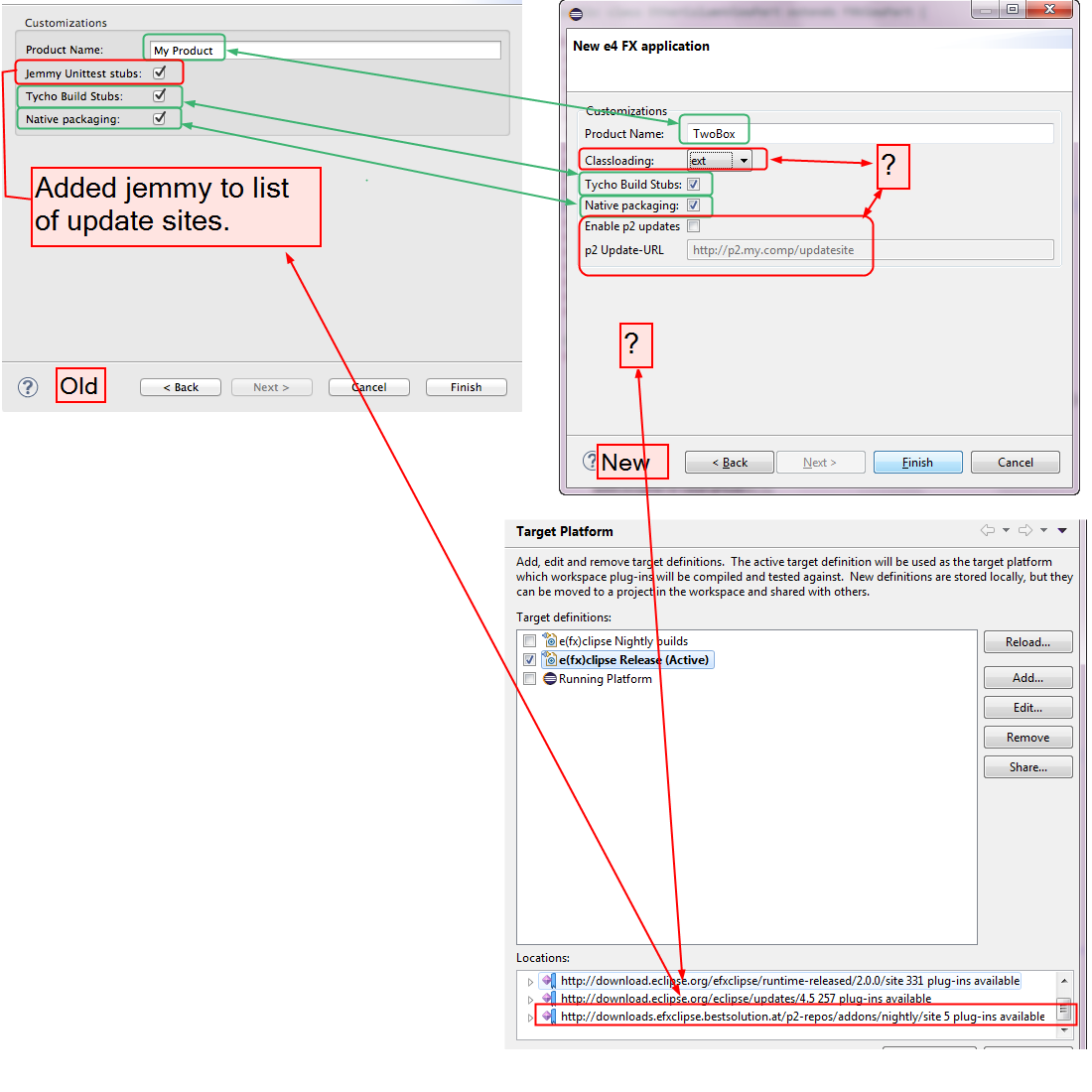

Re: Trying to create an e4 only application with JavaFX [message #1705882 is a reply to message #1705878] Wed, 19 August 2015 15:24 Go to previous messageGo to next message
Been there done that Sad
index.php/fa/22961/0/
Re: Trying to create an e4 only application with JavaFX [message #1705884 is a reply to message #1705882] Wed, 19 August 2015 15:37 Go to previous messageGo to next message
4.5 Update site is wrong and the jemmy stuff is legacy because jemmy is discontinued by Oracle
Re: Trying to create an e4 only application with JavaFX [message #1705885 is a reply to message #1705882] Wed, 19 August 2015 15:58 Go to previous messageGo to next message
Please don't take this the wrong way. I am trying to learn here. Smile Not meant to be criticizing.
See notes in below screen captures.
index.php/fa/22962/0/
index.php/fa/22963/0/

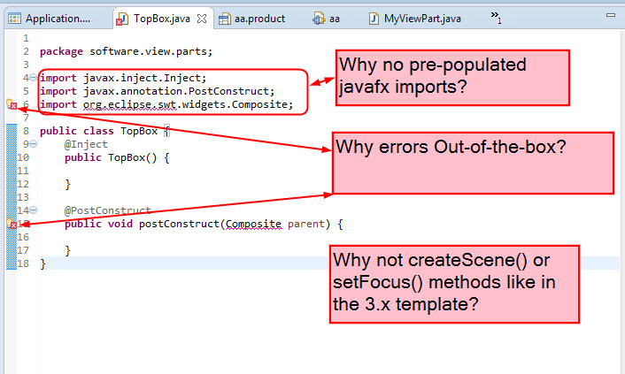

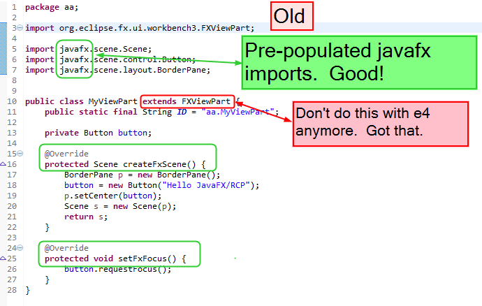

Re: Trying to create an e4 only application with JavaFX [message #1705887 is a reply to message #1705885] Wed, 19 August 2015 16:12 Go to previous messageGo to next message
The e4xmi editor is not from efxclipse and should be improved to eg detect that no swt is on the classpath. In contrast to that is the 3.x wizard we provide an so create an appropriate file
Re: Trying to create an e4 only application with JavaFX [message #1705889 is a reply to message #1705887] Wed, 19 August 2015 16:23 Go to previous messageGo to next message
Cool Very Happy that makes total sense.
If we can continue with the issue I am having. Following the tutorial with a band new project gave me the same errors. Where do I go from here?

Please only keep the first update site from your target definition - remove the others

Re: Trying to create an e4 only application with JavaFX [message #1705905 is a reply to message #1705898] Wed, 19 August 2015 18:38 Go to previous messageGo to next message
The only p2 repo you have to have in your target definition is
http://download.eclipse.org/efxclipse/runtime-released/2.0.0/site - your
target contains SWT.
Please follow the step 1 in the tutorial once more and start with an
*EMPTY* target definition!
Tom
