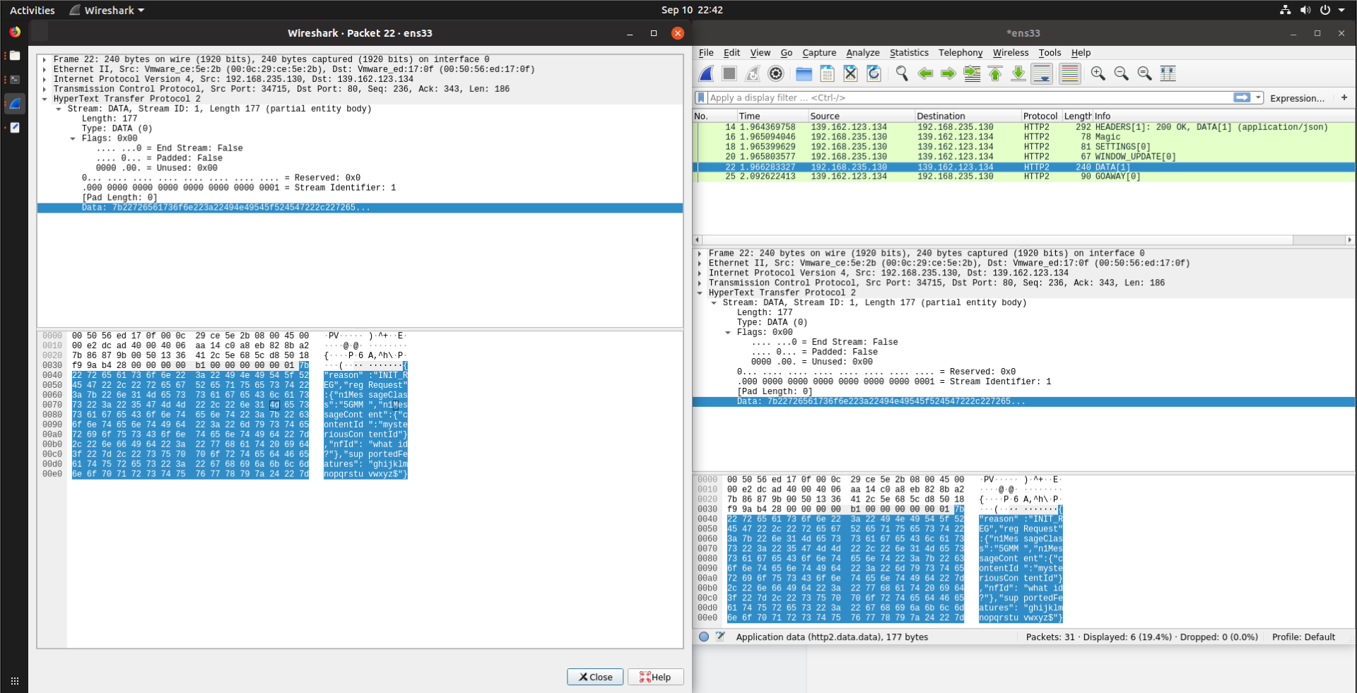

Hi Elemer,
I have deploy a simplified namf JSON protocol module,
and successfully sent it through data frame,
however, this dataframe doesn't recognized as json in wireshark, does that normal...?
index.php/fa/36266/0/
Best regards
Sean
Re: Using JSON in TTCN-3 and Titan Part I: Testing REST / JSON web services: [message #1814413 is a reply to message #1814407] Wed, 11 September 2019 03:17 Go to previous messageGo to next message
Hi Sean,
However I look at it, I see the JSON, see bottom right.
BR
Elemer
[Updated on: Wed, 11 September 2019 03:20] by Moderator
Re: Using JSON in TTCN-3 and Titan Part I: Testing REST / JSON web services: [message #1814503 is a reply to message #1814413] Thu, 12 September 2019 07:57 Go to previous messageGo to next message
Hi Elemer,
I know why wireshark recognized that dataframe frome server is json!
It's because the content-type in the continuation frame!
Best regards
Sean
Re: Using JSON in TTCN-3 and Titan Part I: Testing REST / JSON web services: [message #1814511 is a reply to message #1814503] Thu, 12 September 2019 09:02 Go to previous messageGo to next message
Hi Sean,
Hope you got some sleep :)
Re: Using JSON in TTCN-3 and Titan Part I: Testing REST / JSON web services: [message #1814548 is a reply to message #1814511] Fri, 13 September 2019 00:32 Go to previous messageGo to next message
Ok, I realized that you were missing wireshark to identify
Explicitly the payload of the data frame as JSON.
Right, content-type is the indicator here. Good work.
