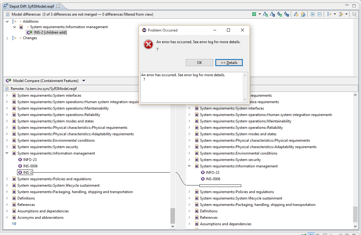

Re: Requirement-Diff [message #1724354 is a reply to message #1722867] Tue, 23 February 2016 05:35 Go to previous messageGo to next message
Hi, thanks for the answer. I didn't notice my e-mail notification when you answered.
OK, I then it seems I got this jface problem mentioned in one of the replies on this topic. The problem seems to be related to the property view... I would guess when it is trying to split the view up or something. That is what is supposed to happen I guess, i.e. property view for each object that shows the changes to the object.
The exception is thrown whenever I select an object in the diff view (like can be seen in the attached image). Could you shed some light to this? We are putting some effort in using ProR for our requirement engineering work and this is one of the things that would be really good if would work properly.
I attach an image that shows when the exception is thrown as well as the exception itself in a text file.
best regards
Axel
