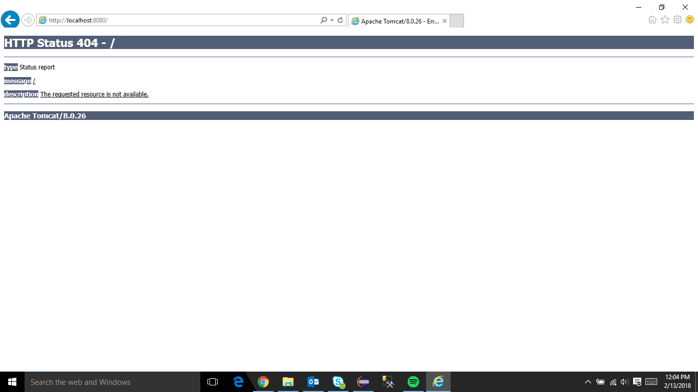

Re: Tomcat embedded in Eclipse doesn't work when launched from Eclipse. What have I done wrong? [message #1781755 is a reply to message #1698155] Mon, 12 February 2018 23:07 Go to previous messageGo to next message
i have this issues. When i run the eclipse it shows no error but i cannot open localhost. is there any that you can guide me with.
thank you
  • Attachment: localhost.png
    (Size: 31.19KB, Downloaded 311 times)
Re: Tomcat embedded in Eclipse doesn't work when launched from Eclipse. What have I done wrong? [message #1781916 is a reply to message #1781755] Wed, 14 February 2018 10:47 Go to previous messageGo to next message
See if this link answers your question:
https://wiki.eclipse.org/WTP_Tomcat_FAQ#If_I_start_my_Tomcat_server_and_try_to_display_Tomcat.27s_default_page.2C_why_do_I_see_a_directory_listing_or_404_error_page.3F
Cheers,
Larry
