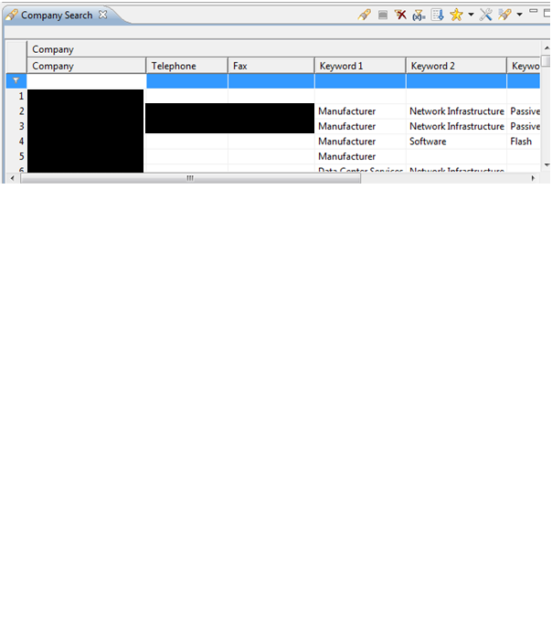

I'm trying to edit (enter text) into the cell of a nebula grid (org.eclipse.nebula.widgets.grid.Grid).
Attaching screenshot of what the result should look like: edit-cell.png.
RCPTT records the example test as follows. When I run it the test passes but nothing is actually written into the grid's cell -- it remains blank.

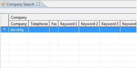

I tried adding get-item-cell and a wait period and see that the cell is being selected (screenshot attached) but after the wait it's immediately deselected again without writing anything into it.
