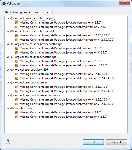

I have checked with a test application (simple 'Application with a single form') called sandbox.
If I check the production server product:
/{your app}.server/products/production/{your app}-server.product
It does not validate, because "javax.servlet" is missing.
index.php/fa/21595/0/
This does not prevent to build and export the application.

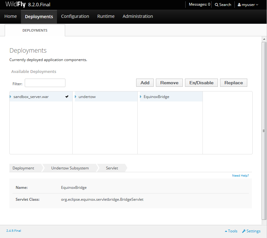

And in the administration console, I see:
http://localhost:9990/console/App.html#deployments
index.php/fa/21596/0/
But when I try to open the URL:
http://localhost:8080/sandbox_server
I get:
BridgeServlet: /sandbox_server
I could not found any application log.
