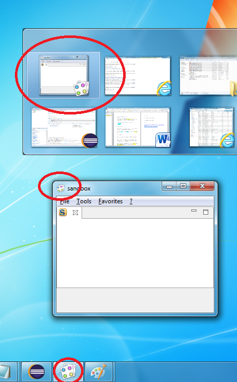

I just tried it with Luna SR2 and I am not able to reproduce your problem. The Icons defined in my product are used:
index.php/fa/21226/0/
<windowImages i16="/sandbox.ui.swt/resources/icons/icon16.png" i32="/sandbox.ui.swt/resources/icons/icon32.png" i48="/sandbox.ui.swt/resources/icons/icon48.png" i64="/sandbox.ui.swt/resources/icons/icon64.png" i128="/sandbox.ui.swt/resources/icons/icon128.png"/>
This is not a Scout Feature at all but a "Eclipse RCP" or "PDE" Feature. Nobody is complaining about some broken Feature after a Luna Update.
(Icon source)
