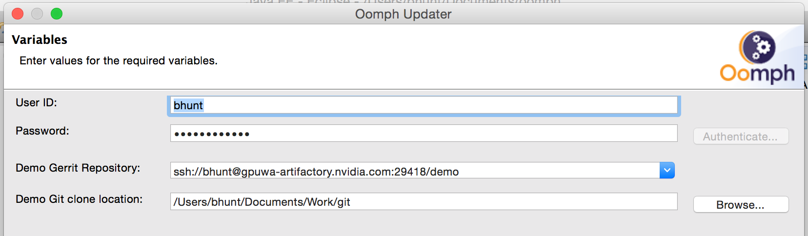

I'm trying to set up my model to clone a Git repo from our Gerrit server, and it's not working. Here my model based on hacking an eclipse setup:
  <setupTask
      xsi:type="setup:VariableTask"
      name="nvidia.gerrit.uri.pattern"
      value="(https|ssh)://([^@/]+@)?(gpuwa-artifactory.nvidia.com:29418/.*)"/>
  <setupTask
      name="nvidia.gerrit.remoteURIs"
      label="Nvidia Gerrit Repository">
    <choice
        value="ssh://${nvidia.id}@gpuwa-artifactory.nvidia.com:29418/@{remoteURI}"
        label="SSH (read-write, Gerrit)"/>
    <choice
        value="https://${nvidia.id}@gpuwa-artifactory.nvidia.com/@{remoteURI}"
        label="HTTPS (read-write, Gerrit)"/>
    <description>Choose from the available remote Gerrit URIs</description>
  </setupTask>
  <setupTask
      name="nvidia.git.gerrit.remoteURIs"
    <annotation
        source="http://www.eclipse.org/oomph/setup/InheritedChoices">
      <detail
          key="inherit">
        <value>nvidia.gerrit.remoteURIs</value>
      </detail>
    </annotation>
    <description>Choose from the available Gerrit URIs</description>
  </setupTask>
When I run the task, I get:
Performing Git Clone demo  (master)
Cloning Git repo demo to
java.lang.Exception: org.eclipse.jgit.api.errors.JGitInternalException: Creating directories for /.git failed
  at org.eclipse.oomph.setup.git.impl.GitCloneTaskImpl.perform(GitCloneTaskImpl.java:649)
  at org.eclipse.oomph.setup.internal.core.SetupTaskPerformer.doPerformNeededSetupTasks(SetupTaskPerformer.java:2756)
  at org.eclipse.oomph.setup.internal.core.SetupTaskPerformer.access$1(SetupTaskPerformer.java:2715)
  at org.eclipse.oomph.setup.internal.core.SetupTaskPerformer$WorkspaceUtil$1.run(SetupTaskPerformer.java:3790)
  at org.eclipse.core.internal.resources.Workspace.run(Workspace.java:2313)
  at org.eclipse.oomph.setup.internal.core.SetupTaskPerformer$WorkspaceUtil.performNeededSetupTasks(SetupTaskPerformer.java:3784)
  at org.eclipse.oomph.setup.internal.core.SetupTaskPerformer$WorkspaceUtil.access$0(SetupTaskPerformer.java:3782)
  at org.eclipse.oomph.setup.internal.core.SetupTaskPerformer.performNeededSetupTasks(SetupTaskPerformer.java:2706)
  at org.eclipse.oomph.setup.internal.core.SetupTaskPerformer.performTriggeredSetupTasks(SetupTaskPerformer.java:2681)
  at org.eclipse.oomph.setup.internal.core.SetupTaskPerformer.perform(SetupTaskPerformer.java:2620)
  at org.eclipse.oomph.setup.ui.wizards.ProgressPage$9.run(ProgressPage.java:523)
  at org.eclipse.oomph.setup.ui.wizards.ProgressPage$11$1.run(ProgressPage.java:608)
Caused by: org.eclipse.jgit.api.errors.JGitInternalException: Creating directories for /.git failed
  at org.eclipse.jgit.api.InitCommand.call(InitCommand.java:118)
  at org.eclipse.jgit.api.CloneCommand.init(CloneCommand.java:161)
  at org.eclipse.jgit.api.CloneCommand.call(CloneCommand.java:132)
  at org.eclipse.oomph.setup.git.impl.GitCloneTaskImpl.cloneRepository(GitCloneTaskImpl.java:705)
  at org.eclipse.oomph.setup.git.impl.GitCloneTaskImpl.perform(GitCloneTaskImpl.java:594)
  ... 1 more
Caused by: java.io.IOException: Creating directories for /.git failed
  at org.eclipse.jgit.util.FileUtils.mkdirs(FileUtils.java:316)
  at org.eclipse.jgit.internal.storage.file.FileRepository.create(FileRepository.java:271)
  at org.eclipse.jgit.api.InitCommand.call(InitCommand.java:115)
  ... 2 more

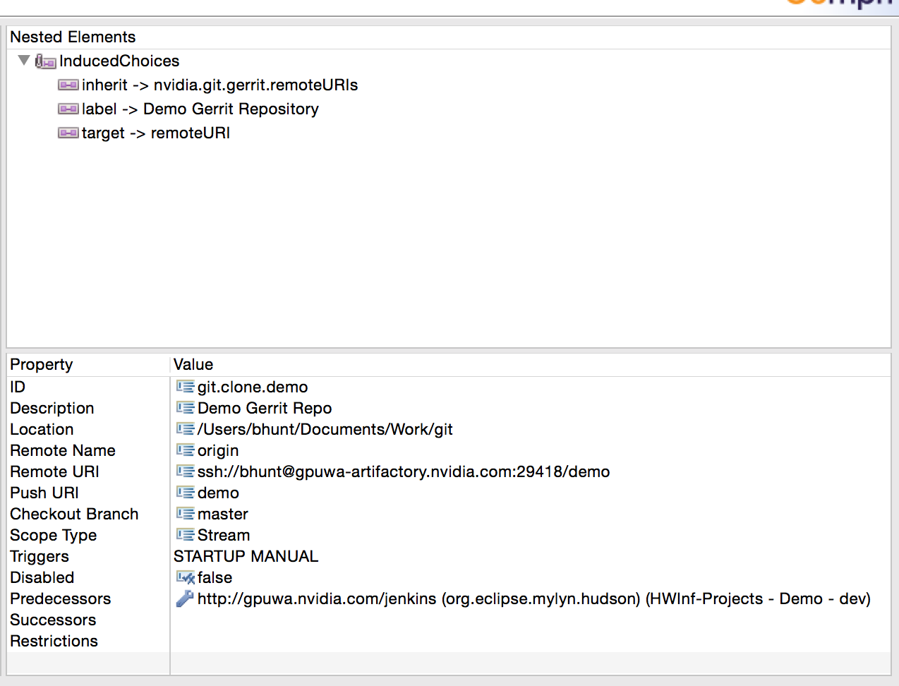

Re: Help cloning git repo [message #1649314 is a reply to message #1648305] Wed, 04 March 2015 04:03 Go to previous messageGo to next message
Bryan,
What does the clone task itself look like? Can you paste it here? Note
that in the confirmation page you can examine the model to see how all
the variables have been expanded to produce the final concrete values
for the clone task.

Bryan,
The one for Oomph looks like this:
<setupTask
xsi:type="git:GitCloneTask"
id="git.clone.oomph"
remoteURI="oomph/org.eclipse.oomph"
checkoutBranch="master"
userID="">
<annotation
source="http://www.eclipse.org/oomph/setup/InducedChoices">
<detail
key="inherit">
<value>eclipse.git.gerrit.remoteURIs</value>
</detail>
<detail
key="label">
<value>Oomph Git or Gerrit Repository</value>
</detail>
<detail
key="target">
<value>remoteURI</value>
</detail>
</annotation>
<description>Oomph</description>
</setupTask>
Be sure to set proper id on the task, not the empty string; no doubt you
need this anyway so that other tasks can refer to the location, e.g.,
${git.clone.oomph.location} for the case of Oomph's clone location.
Also, the empty string for the pushURI is probably a bad idea as well.
And again, be sure to inspect this in the confirmation page, in
particular look at how all these values are expanded, especially the
location value (which I don't think will be expanded unless the task has
an ID) to which the clone location rule can be applied.

Re: Help cloning git repo [message #1651853 is a reply to message #1651815] Thu, 05 March 2015 09:54 Go to previous messageGo to next message
Bryan,
What do the expanded location and remoteURI attributes look like in the
task you are executing? Is it possible that there is a corrupt clone at
that location?
On 05/03/2015 3:28 PM, Bryan Hunt wrote:

Re: Help cloning git repo [message #1652069 is a reply to message #1651853] Thu, 05 March 2015 12:29 Go to previous messageGo to next message
Hi Ed,
The Confirmation page does not display the git clone task. I think this is because of the exception thrown. I'm setting the location to the place I want the repository to be cloned. It seems that the code is checking for an existing repository at that location which does not exist. Which is why I'm doing the clone in the first place. Maybe I'm not understanding the purpose of the location. Attached is a screenshot of what I see on the variables page.
index.php/fa/21081/0/
Re: Help cloning git repo [message #1653103 is a reply to message #1652069] Thu, 05 March 2015 23:47 Go to previous messageGo to next message
Bryan,
That's the variables page. The next page is the confirmation page.

Re: Help cloning git repo [message #1654241 is a reply to message #1653103] Fri, 06 March 2015 10:53 Go to previous messageGo to next message
Hi Ed,
Here is what I'm seeing...
index.php/fa/21089/0/
Re: Help cloning git repo [message #1654352 is a reply to message #1654241] Fri, 06 March 2015 11:57 Go to previous messageGo to next message
Am 06.03.2015 um 16:53 schrieb Bryan Hunt:
> Hi Ed,
Ed is already on his way to the EclipseCon and I'm packing...
The PushURI doesn't look like a URI but I would expect this to become a problem only at push time. Haven't tried, though.
Your location path looks a little bit more like a container folder for clones, not a a typical path name for a clone
itself. The location should point to a folder that either doesn't exist, or is empty, or contains a valid clone of the
right repo.
Cheers
/Eike
http://www.esc-net.de
Re: Help cloning git repo [message #1661422 is a reply to message #1654352] Mon, 09 March 2015 12:21 Go to previous messageGo to next message
Ok, I got it to work. For the location, I had selected a directory that already existed which was a natural thing to do with the file dialog. To get it to work, I had to append a subdirectory that did not exist after using the file dialog. I would submit that this is not intuitive.
Re: Help cloning git repo [message #1661543 is a reply to message #1661422] Mon, 09 March 2015 13:30 Go to previous messageGo to next message
Bryan,
Normally the location is assigned by rules, i.e., so the user only
specifies a root/home folder where all the git clones are located and
then the name of the subfolder within this folder is derived from the
remoteURI. In other words, you could author the model in a way that
would make it more intuitive for the user...
> not intuitive.
Re: Help cloning git repo [message #1661613 is a reply to message #1661543] Mon, 09 March 2015 14:13 Go to previous message
Lightbulb! Thanks Ed. I wish I were at EclipseCon to buy you a beer Very Happy
