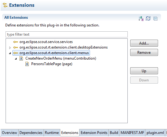

The binding is done in the plugin.xml file: You can define an extension to the extension point "org.eclipse.scout.rt.extension.client.menus". Define an menuContribution (the menu) for the PersonsTablePage.
index.php/fa/20964/0/
If you open plugin.xml, the XML looks like this:
