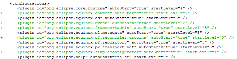

Fixed it by adjusting start levels:
index.php/fa/19101/0/

I had to add "org.eclipse.osgi.compatibility.state" to my feature and the following lines to my product:
   <configurations>
      <plugin id="org.eclipse.core.runtime" autoStart="true" startLevel="0" />
      <plugin id="org.eclipse.equinox.common" autoStart="true" startLevel="2" />
      <plugin id="org.eclipse.equinox.ds" autoStart="true" startLevel="2" />
      <plugin id="org.eclipse.equinox.event" autoStart="true" startLevel="2" />
      <plugin id="org.eclipse.equinox.simpleconfigurator" autoStart="true" startLevel="1" />
      <plugin id="org.eclipse.osgi" autoStart="true" startLevel="-1" />
   </configurations>
