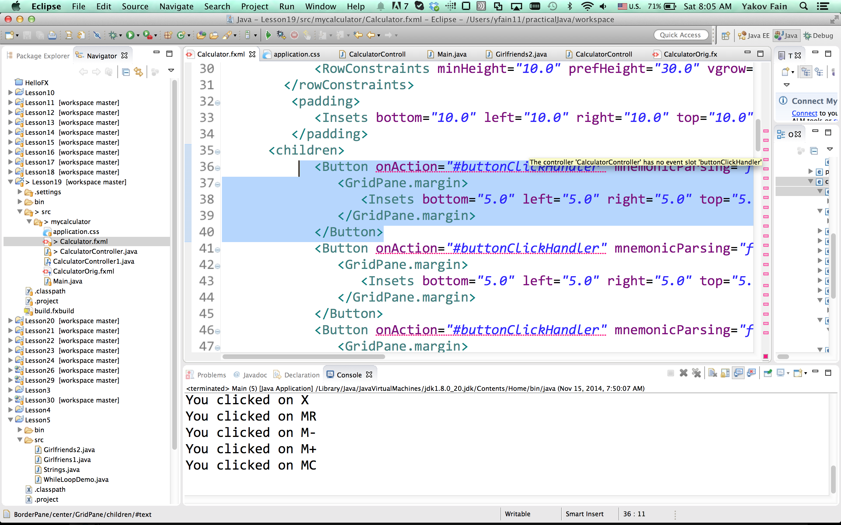

I have an FXML file that includes <Button> tags generated by Scene Builder. The name of the controller class is properly set in FXML and has the following code:
public class CalculatorController {
public void buttonClickHandler(ActionEvent evt){
Button clickedButton = (Button) evt.getTarget();
System.out.println("You clicked on " + clickedButton.getText());
When I add onAction="#buttonClickHandler" to FXML Button controls the program works fine, but Eclipse marks it red displaying the "error" as "The CalculatorController has no event slot 'buttonClickHandler'". The sample FXML button is shown next:
<Button onAction="#buttonClickHandler" mnemonicParsing="false" prefHeight="37.0" prefWidth="132.0" text="MC">
<GridPane.margin>
<Insets bottom="5.0" left="5.0" right="5.0" top="5.0" />
</GridPane.margin>
</Button>

IIRC we mark it as an error because it we only honor @FXML - please file a bug requesting that we also treat public methods/fields as if the where annotated with @FXML and until fixed simply add the none mandatory annotation
