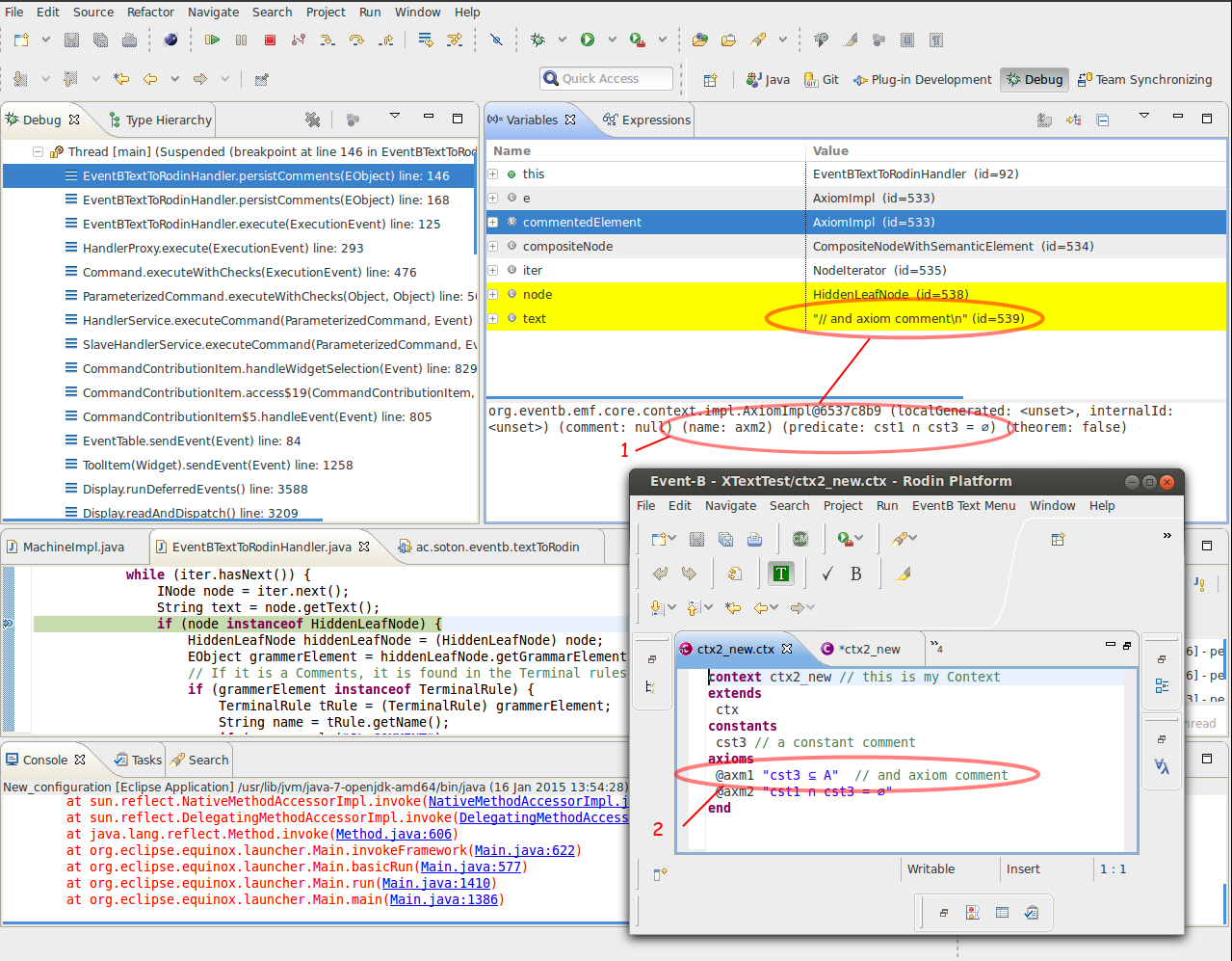

I've been trying to get comments from a node model, so that I can inject them into an EMF model for separate persistence. But, it is not working as I expected. I assumed that the node associated with an EObject (representing a keyword in the text, for instance) would contain a tree (or some graph) of sub elements, related to the DSL spec.
To illustrate, I have a problem with comments on an axiom,
Axiom returns context::Axiom:
'@'name=EString
predicate=EString?
(theorem?='theorem')?
('//' comment=EString)?
When trying to obtain comments from the node model, if you can see the graphic attached, the comment associated with axm2 (note 1) using node.getText() is incorrect. In the xtext it is associated with axm1 (note 2). In some cases the comments are lost, so I am obviously doing something wrong.
In my code I use NodeModelUtils.getNode(eobj) to get a composite node, and ICompositeNode.getChildren() method to get an iterator. Is my assumption correct, that the comment should be navigable through an iterator obtained from the Axiom EObject?
Any hints would be appreciated.

Hi Andy,
in the node model, comments almost always precede the following semantic
text. The semantic association of comments to EObject can be done by
means of the org.eclipse.xtext.parsetree.reconstr.ICommentAssociater.
Hope that helps,
Sebastian

Hi, my query is about serialising an EMF model for use by another tool. Sebastian's comment, above, suggests that I use ICommentAssociater to link semantic text with comments. Presumably I can then retrieve a comment, given a node object, so that I can insert it in the correct place in my EMF model. In my DSL, comments follow the semantic text. I am just looking for the 'best way' to insert the comments, after text rather than before.

Ok, this works, but seems a bit messy since some of the comments (those on the first line of the my file) appear lower in the node model's tree than the semantic text they are associated with; most other comments appear higher in the tree than the associated text. I also seem to have spurious newline characters and text, when I get comment text from the node using INode.getText(), which is rather strange.
