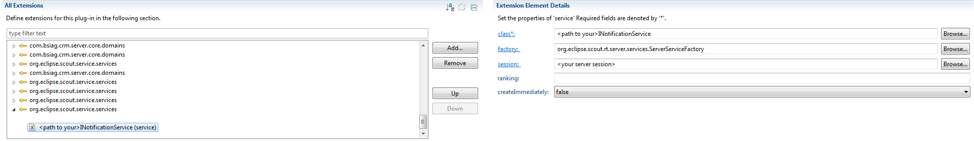

are you sure you registered the INotificationService in the server's plugin.xml ?
When you open the server's plugin.xml with the Plug-in Manifest Editor, there should be an entry which references your INotificationService.
index.php/fa/19878/0/
  • Attachment: plugin.png
    (Size: 35.78KB, Downloaded 1015 times)

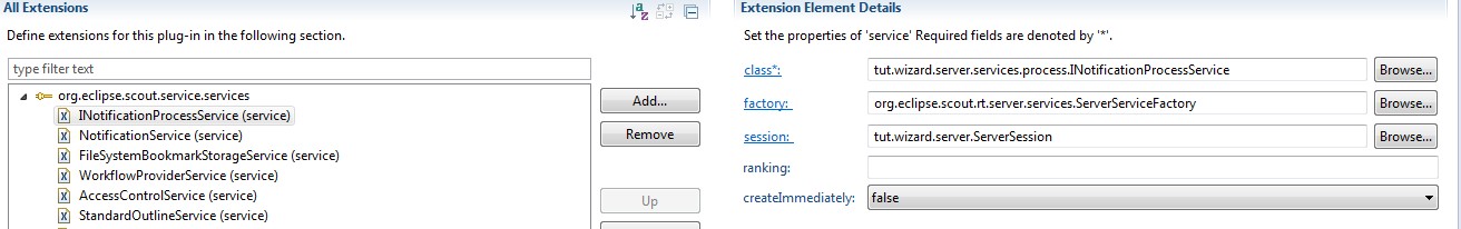

Hi and thanks for the help, attached is a picture with my server extensions, I have an INotificationProccessService, but still getting the same error.

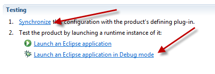

hm... another think you can try is: open your server-dev.product, click synchronize and start again:
index.php/fa/19892/0/
However I am not sure if it helps
  • Attachment: synch.png
    (Size: 13.06KB, Downloaded 966 times)
Re: Client Notifications Tutorial [message #1472026 is a reply to message #1471969] Thu, 13 November 2014 09:35 Go to previous messageGo to next message
Ah kike,
in your server_extensions.jpg it says:
class*: ...INotificationProcessService
Do you reference the Interface here? I think the Implementation should be referenced here. I guess your Implementation looks like this:
public class NotificationProcessService extends AbstractService implements INotificationProcessService
Now, try to reference
instead.
Re: Client Notifications Tutorial [message #1476958 is a reply to message #1472026] Mon, 17 November 2014 08:54 Go to previous messageGo to next message
Thanks for all the help. I did everything again from scratch and now it works, I noticed there are a couple of bad spelled names in the tutorial, but not very hard to avoid.
I guess I also did something wrong registering INotificationService but now I did it your way and it works fine, thank you very much.

Oh sorry, I did not expect somone to use this ancient release... You are right, this annotation does not exist until Scout 5.2. Please not that Scout 3.9 is very outdated and is not maintained anymore. It might not run on modern versions of application servers or the Java platform and many libraries are probably not compatible any more. We strongly recommend migrating to a more recent release!
If I remember correctly, the equivalent of @TunnelToServer would be to correctly register the service:
  • In your.project.server/plugin.xml register the service itself using the <service> tag.
  • In your.project.client/plugin.xml register the service proxy (i.e. the interface) using the <proxy> tag.
Since your other services work fine, you should be able to find the relevant places by searching all files in your workspace for their names and then just copy the entries accordingly.
Beat
Re: Client Notifications Tutorial [message #1837904 is a reply to message #1837655] Wed, 10 February 2021 02:58 Go to previous message
I know that I use an ancient release and I need to migrate to new one.
By the way, I check your suggestions and everything in the plugin.xml is defined accorded with the HowTo page and the path is consistent with my workspace, but still not work.
