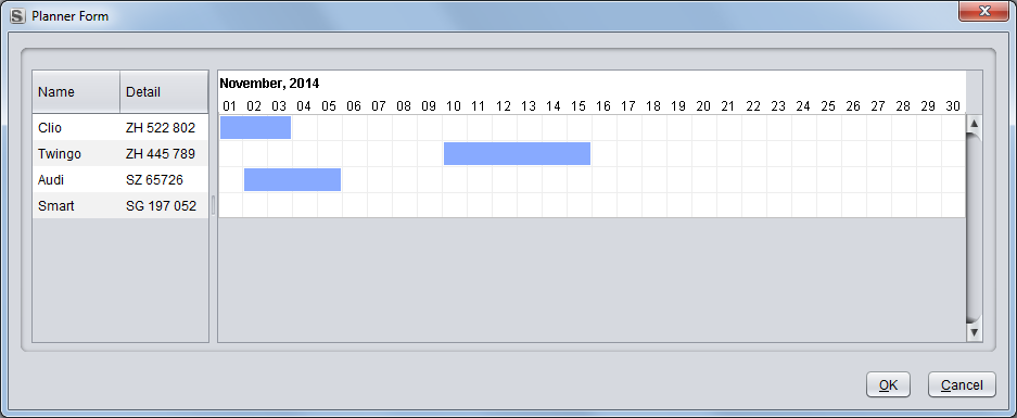

Example:
index.php/fa/19879/0/
The Grid displays a set of ActivityCells. Each ActivityCell contains:
* resourceId (Generic Type: RI)
* activityId (Generic Type: AI)
* startTime (Date)
* endTime (Date)
* text (String)
* tooltipText (String)
* iconId (String)
* majorValue (float)
* minorValue (float)
Resources are listed in the Table: ResourceTable an inner-class of the planner field.
* This Table contains a column (primary key, same type of RI) to store the resourceId.
* And additional columns (Name and Detail in this case).
To populate the table, add some logic in YourPlannerField.execLoadResourceTableData(). Return an array Object[][] that will some data for the RessourceTable.
To populate initial data in the field, add some logic in the method: YourPlannerField.execLoadActivityMapData(..) The method should return a bi dimensional array: Object[][]: first dimension is the quantity of ActivityCells you want to display. Second dimension is 9: it corresponds to the properties of the ActivityCell (resourceId, activityId, startTime, endTime, text, tooltipText, iconId, majorValue, minorValue)

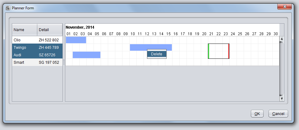

Menus:
There are two types of menus that you can put in the activity map.
ActivityMapMenuType.Activity
This type of menu is displayed when an ActivityCell is selected (Delete menu in this example):
index.php/fa/19880/0/
You can access the selected activity cell with getSelectedActivityCell()

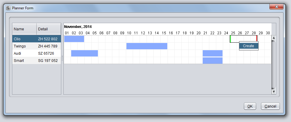

ActivityMapMenuType.Selection
This type of menu is displayed when a selection is made in the grid (Create menu in this example)
index.php/fa/19881/0/
You can access the selection with the methods: getSelectedResourceIds(), getSelectedBeginTime(), getSelectedEndTime()
