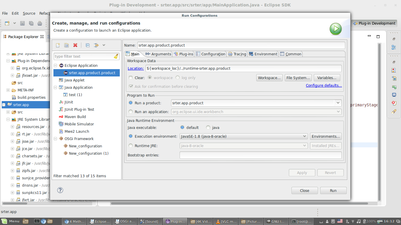

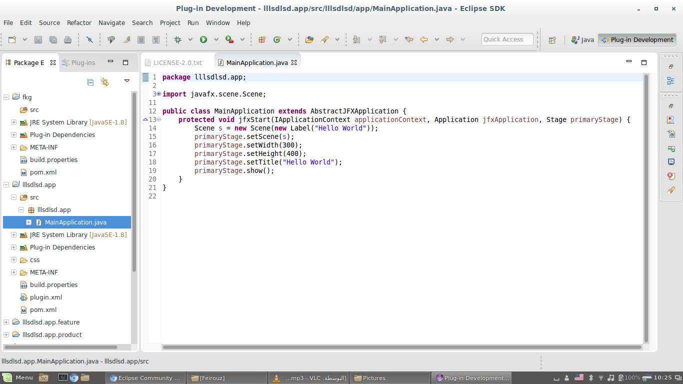

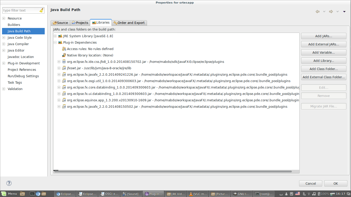

1- for the first wizard it is generating four projects which MR. Tom Schindl had explained in his blog http://tomsondev.bestsolution.at/2012/12/10/my-recommended-project-structure-for-javafx-e4-projects/, but when i looked at the Run Configuration of the launch i realized that it is running as an Eclipse Application index.php/fa/19585/0/, (and i need to start my system as an OSGI Framework), and notice this, there is a plug-in dependencies which looks like this index.php/fa/19586/0/, and the main class is extending an AbstractJFXApplication class and using an jfxStart method (not a standard JavaFX App)!!!! index.php/fa/19587/0/.

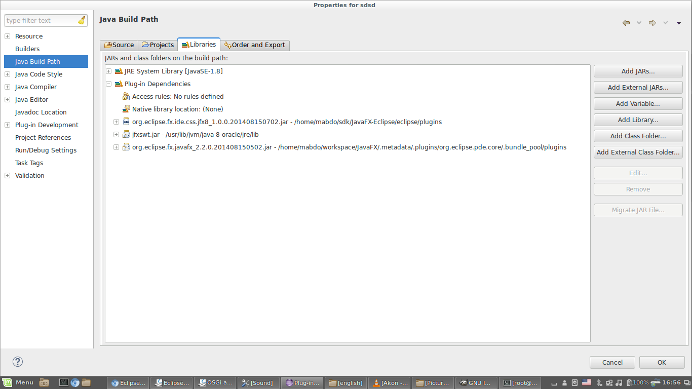

2- for the second wizard the generated project has the same structure as an plug-in development project (I SUPPOSE) adding the plug-in dependencies that looks like this index.php/fa/19588/0/.

> 1- for the first wizard it is generating four projects which MR. Tom Schindl had explained in his blog http://tomsondev.bestsolution.at/2012/12/10/my-recommended-project-structure-for-javafx-e4-projects/, but when i looked at the Run Configuration of the launch i realized that it is running as an Eclipse Application , (and i need to start my system as an OSGI Framework),
I don't see what your heading to? You want to run on OSGi so why is it a
problem to start you need to start on OSGi-Framework?
and notice this, there is a plug-in dependencies which looks like this ,
using an jfxStart method (not a standard JavaFX App)!!!! .
Right. We define an IApplication which can be launched:
a) through a command line param
b) interactively through the Console or Equinox APIs

> and i need to develop Plug-in projects (Bundles) and have JavaFx Code in some of them, so the Questions that arises are:
> Do i need to add the same Plug-in dependencies as in the first wizard? and HOW?
You need at least the above 2 bundles.
Or as alternative *none of them* and *no* package imports for javafx
(this important! I repeat no package imports!) but launch Equinox with
-Dorg.osgi.framework.bundle.parent=ext which forces Equinox to NOT strip
the ext-classloader from the lookup hiearchy.
