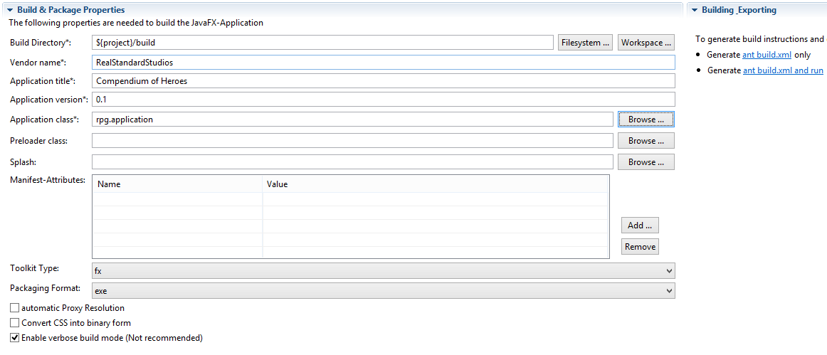

I have attempted to create a native windows exe for my program, however I have been held up at this screen for some reason.
When I press the "Generate ant build.xml only" link a dialog seems to flash before me but nothing happens afterwards, no new directories or anything.

Ok I see the problem how did you get the build.fxbuild file - it is
corrupted? You notice that when you enter e.g. an Application versio it
does not get dirty!
Overwrite it with the version attached but it would be interesting to
know how you get the fxbuild file in this state?

Re: Building a native executable with Eclipse 4.4 and e(fx)clispe [message #1451540 is a reply to message #1450990] Thu, 23 October 2014 20:46 Go to previous messageGo to next message
poor understanding of egit probably caused it, I barely understand what I'm doing with the plugin enough to fix merge conflicts and my team mates blindly follow my instructions to use it :S

Exception running application rpg.MainApp
this says to me that its not seeing any of the fxml files properly right?
EDIT:
I fixed it... so when I am getting all of my FXML files through this.getClass().getResource() that works fine BUT if you go this.getClass().getResource("").getPath() + "/data" it goes haywire outside of the development env.
Also if a class extends one in another project it seems to want to look at the superclasses dir rather than the extended one but it didn't happen every time so slightly confused there.
Anyway stopped using getResource.getPath()+"other string" and when applicable used System.getProperty("user.dir") and things are now back on the road.
[Updated on: Sat, 01 November 2014 21:31] by Moderator
That's correct how does the code look like where you are loading the FXML?
Tom
Re: Building a native executable with Eclipse 4.4 and e(fx)clispe [message #1461928 is a reply to message #1459429] Tue, 04 November 2014 22:18 Go to previous messageGo to next message
Anyway stopped using getResource.getPath()+"other string", just using a direct getResource.getPath("FXMLFILE") and when applicable used System.getProperty("user.dir") and things are now back on the road.
Re: Building a native executable with Eclipse 4.4 and e(fx)clispe [message #1462107 is a reply to message #1461928] Wed, 05 November 2014 02:58 Go to previous message
Why are you using getResource("FXMLFILE").getPath() at all? The
FXMLLoader-API always wants an URL! Your useage of System.getProperty()
stuff also does not really make sense to me but maybe there is.
The problem with your getPath() call is that in the exported version you
are inside the JAR-Filesystem which is different to host filesystem in
many ways where the most prominent are:
* no relative parent paths e.g. ../bla.fxml does not work!
* cases sensitiveness where it is different to the windows-filesystem
Tom
