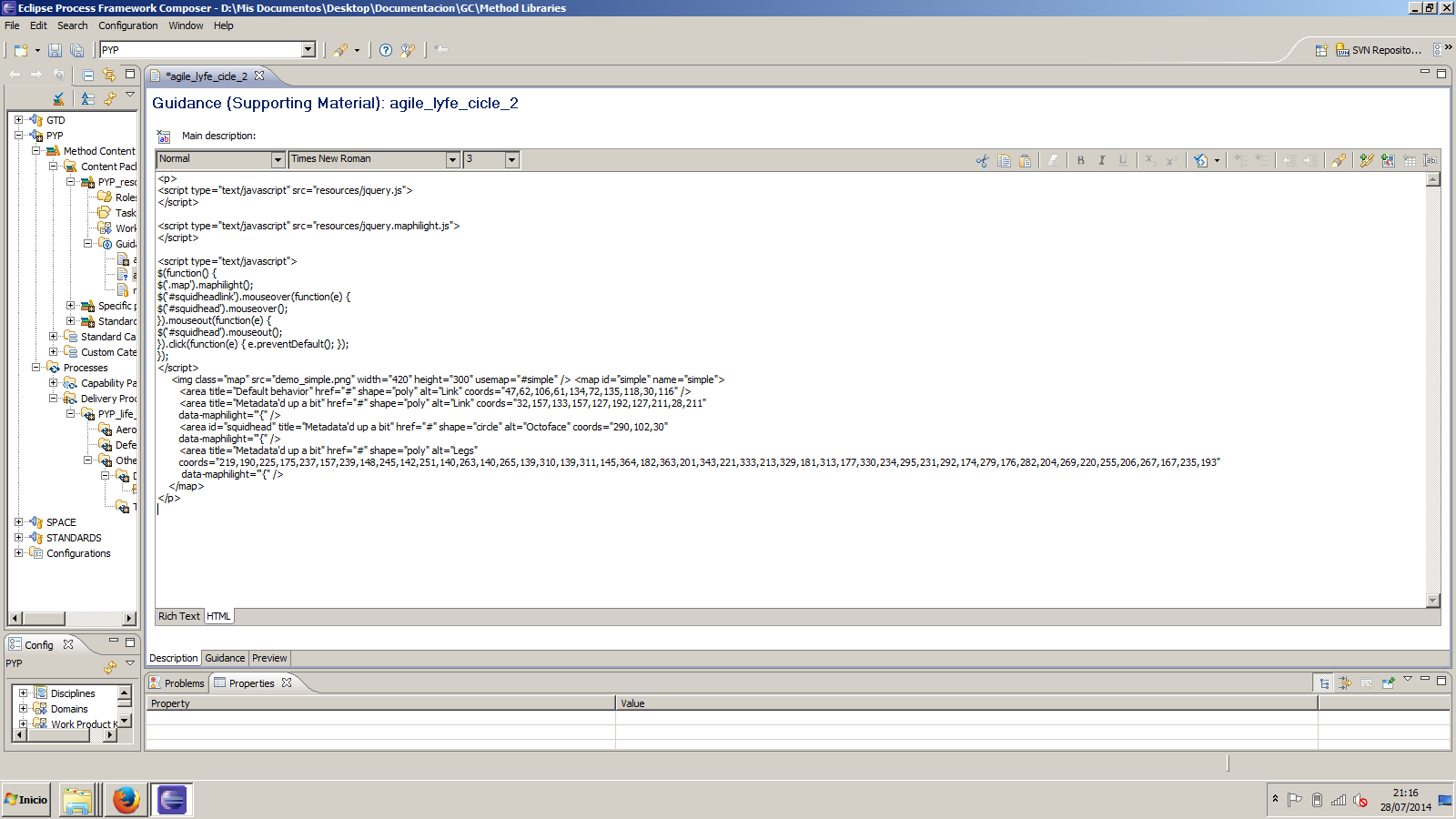

Hi, i am trying to highlight some hotspots defined in a picture using jquery and maphighlight function as it can be seen in "source_code" file (also attached):
index.php/fa/18656/0/

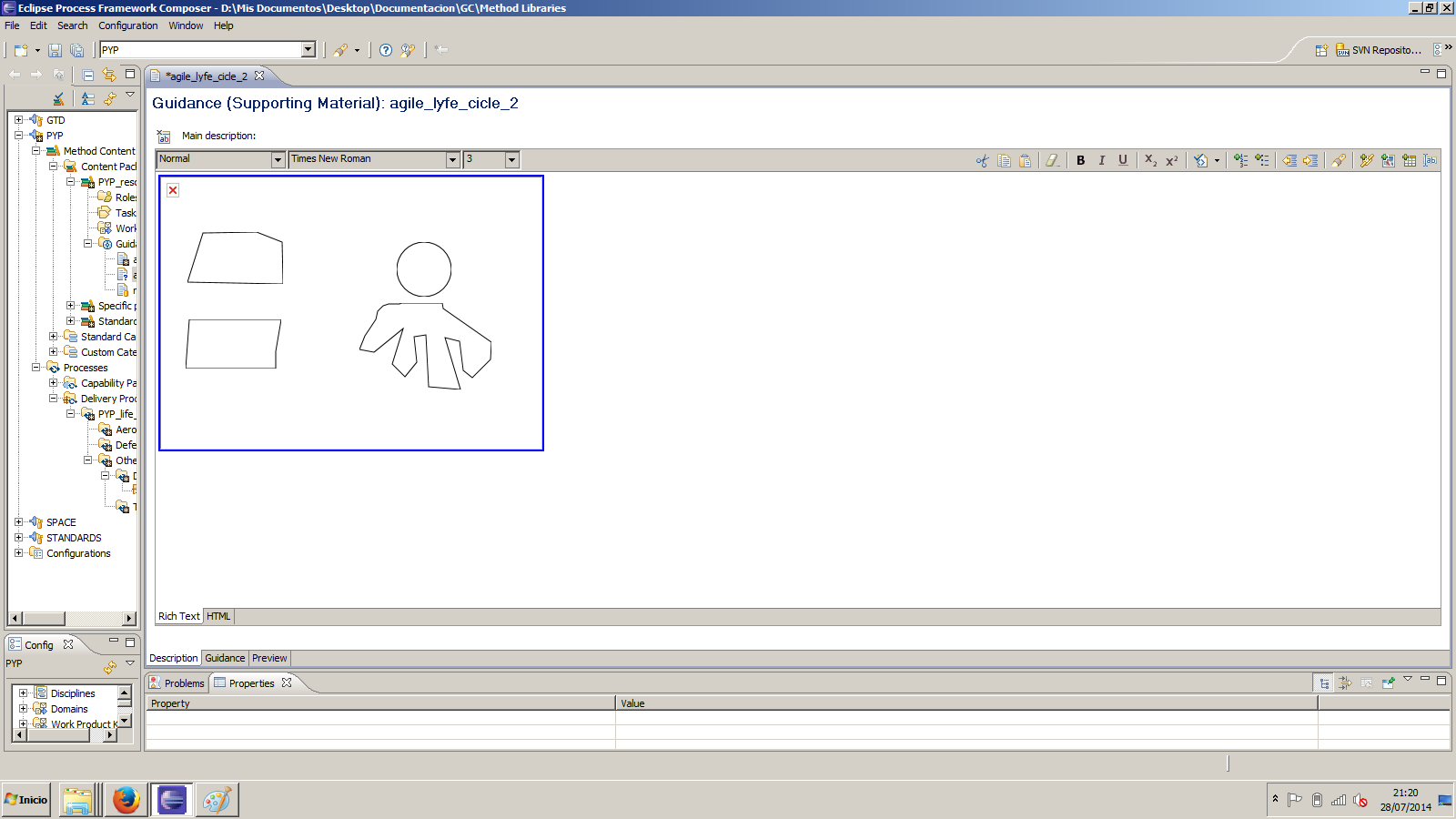

This code is seen in the "rich text" view as follows:
index.php/fa/18657/0/
so the definition of hotspots works fone.
It is supposed, and in google there are a lot of working examples, that once generated the html, the graphic area of the hotspot is highlighted when the mouse is over the figure.
However, in the "preview" view it can be see that the mouse changes from the arrow to a finger when it is on some of the hotspots but the hotspost it is not highlighted.

The problem lies in the "tidy" feature of the RMC rich text editor. When you "save", the tidy feature changes the javascript, sometimes introducing errors.
I've also observed issues with publishing as well.
There are a few solutions to try:
1. You can change the javascript so that tidy and publishing doesn't change it.
For example, I noticed that some characters, like "<" were not handled correctly, so I did the following:
var left=String.fromCharCode(60)
Then I used "left" in strings where I needed a left angle bracket.
It takes some trial and error to get this approach to work.
2. Use an external javascript file, e.g.
<SCRIPT SRC="filename.js">
But if only it was so easy. Unlike graphic files, which RMC recognizes as being associated with the page, javascript files are not copied at publishing time.
The workaround is to add a template, or some other element that supports file attachments, and attach the file to that element. Now the javascript file will be copied over at publication time.
However, you will have to use a relative path to refer to it.
For example, to reference a filename.js script attached to a template but referenced from a concept, the path would be ../templates/resources/filename.js
