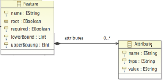

Dear all,
I got a meta-model like the picture that I've attached
I want to get the "value" from that meta-model with this code
[for (it : Feature | aFeatureModel.eAllContents(Feature))]
	[if (it.attributes->notEmpty())]
		[i/]. [it.name/] with attributes [it.attributes.name/] and value [it.attributes/]
 		[else]
		[i/]. [it.name/]
	[/if]
[/for]
I hope the output will be like this
1. [Feature_name] with attributes [name of feature's attribute] and value [value of attribute]
but instead of that result, I got
org.hyperflex.featuremodels.impl.SimpleAttributeImpl@6e486976 (name: amount) (type: Int, value: in [0..5])
I think my problem is I can not get the contained items in second round bracket (type: Int, value: in [0..5]). So, I change the code to
[it.attributes.value/]
but I got an error message "Unrecognized variable: (value)"
I hope someone can help me solve this problem Surprised
Thank you
Irfan

Re: [Acceleo] How to get attributes from this meta-model [message #1272378 is a reply to message #1272264] Mon, 17 March 2014 15:53 Go to previous messageGo to next message
attributes is a Collection so you should probably iterate over it, but
if really want just one attributes->any(true).value should work.
Ed Willink

Re: [Acceleo] How to get attributes from this meta-model [message #1272483 is a reply to message #1272378] Mon, 17 March 2014 22:30 Go to previous messageGo to next message
Ed Willink wrote on Tue, 18 March 2014 02:53
Ed Willink
Hello Ed,
thank you for your reply. Yes it's true that attributes is a collection.
I've tried your code but I still get the error message "Unrecognized variable: (value)"
I think I cannot do direct access to value since it's in the second round bracket in this result (I make it red) -> org.hyperflex.featuremodels.impl.SimpleAttributeImpl@6e486976 (name: amount) (type: Int, value: in [0..5])
I can do a direct access like attributes->any(true).name and I get "amount" as a result since it's in first round bracket.
Irfan

Re: [Acceleo] How to get attributes from this meta-model [message #1272630 is a reply to message #1272576] Tue, 18 March 2014 07:20 Go to previous messageGo to next message
I am sorry if I made you a little bit confused.
I just want to get the value of my model's attribute. I have provided the meta-model and I think I can get that value just by using this code
I have put your code and I get an error message like in the picture I've attached in this reply
Hope it helps you see my problem
Thank you
Irfan
