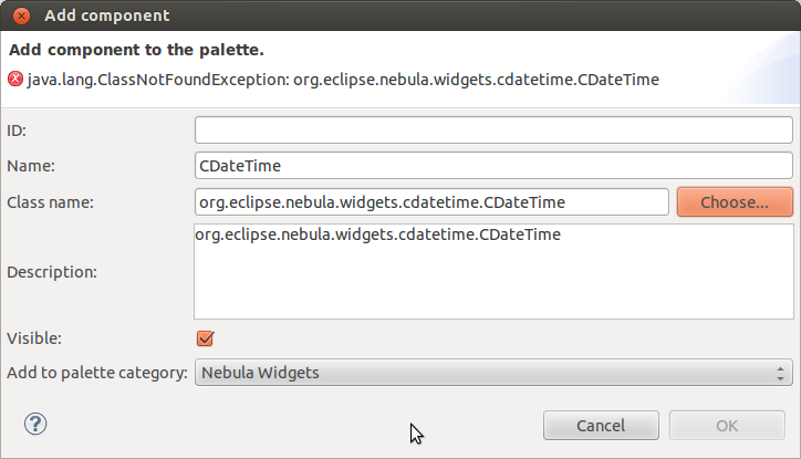

I have installed Nebula widgets http://www.eclipse.org/nebula/ to my Kepler.
I have added them (both class files and the source) to the build path, so that when I use them in the code, the CDateTime class is found and the code compiles.
F3 also finds and displays the source code. (For some reason I do not understand, the tab header says CDateTime.class and CDT.class, not CDateTime.java and CDT.java as other classes, even though the tab contains the source code. However, this is not my problem.)
When I try to add CDateTime to the Palette, the Palette manager finds the class but reports that it cannot load it:
index.php/fa/17399/0/
When I replace my DateTime widget in the source by CDateTime and try to switch to the Design tab, it cannot find the AST. (I found that it means Abstract Syntax Tree but no more helpful info.)
I would very much appreciate any help.

I have found out myself what my problem was: I was missing another library in my class path, org.eclipse.nebula.cwt_0.9.0.201401291008.jar, that contains the class BaseCombo which is the superclass of CDateTime.

Makes sense. The ClassNotFoundException is consistent with a classpath issue.
I doubt that WB knows anything specific about any special Nebula data binding stuff. It would need to be taught about that.
