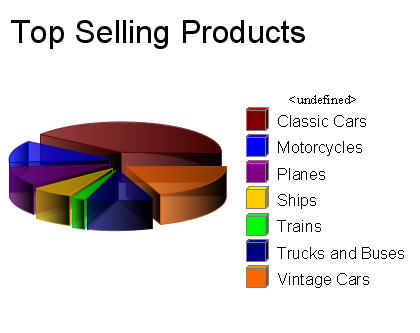

Pie Chart support 2D with depth, which has a 3D look, but is not "real" 3D
in a sense where there is no lighting computations or Z-sorting done. Please
take a look at some 2D with depth pie charts, I think it should be enough
for what you need. Otherwise please let me know exactly what you're looking
for.
I'm attaching one 2D with depth Pie Chart here for you, so you can see.
David Michonneau

For instance you can also change the pie ratio and series depth to give more
3D effect:
Is that what are you're trying to do?
David

Is there a way to change only the series depth color? I want to make it
gray for all. Changing the pie ratio and series depth did make it look
closer to the 3D one.
Chandrika
Re: 3-D pie Charts [message #122548 is a reply to message #122304] Wed, 01 February 2006 04:40 Go to previous message
Yes, you can force the depth color to be grey by using gradients in your
palette instead of plain colors. I sent you a screenshot at your email
address.
David
