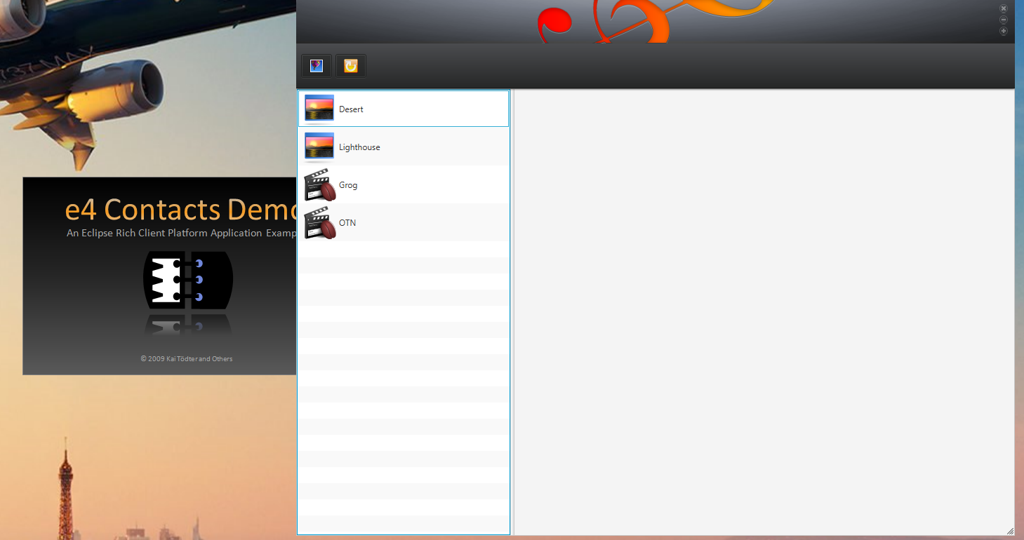

Re: Specifying Splashscreen location [message #1807861 is a reply to message #1744863] Tue, 11 June 2019 03:56 Go to previous messageGo to next message
Is there any new development in this issue? It still appears on the 3.5.x version
Re: Specifying Splashscreen location [message #1807863 is a reply to message #1807861] Tue, 11 June 2019 04:01 Go to previous messageGo to next message
you mean that it does not disappear - yes this should work now
Re: Specifying Splashscreen location [message #1807873 is a reply to message #1807863] Tue, 11 June 2019 05:04 Go to previous message
Yes, as you understand, but I still have this problem on the target platform of 3.5.0, Windows 10, jdk 1.8.
Did I miss something?
Sorry, I temporarily borrowed your splash.bmp in the contact demo project.
