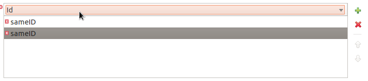

I have a custom validation service that proofs for uniqueness against other dependent properties.
index.php/fa/15757/0/
If I change the content of the second element, my custom validation service will notice that the first element also has the same content and return Status.createErrorStatus(....). The transparent row icon will be replaced with the error icon.
index.php/fa/15758/0/
My custom validation service is also performed on the first element then I specified @DependsOn on this. It recognizes that the second element also has the same content and also returns Status.createErrorStatus(....). Unfortunately the transparent icon is still shown.

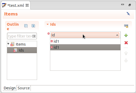

And this is actually what I'm trying to achieve. I clicked on the column header, it apparently triggers the row icon to be redrawn.

How can I trigger a refresh on the first element? Thank you! Smile

I attached my sample project as zip file and made a further screen shot showing the refreshed list after clicking the column header:

This appears to be a bug in the list property editor. It provides the row-level validation marker, but doesn't actually listen for validation events. The image is only updated when the content of one of the column properties changes.
Re: Trigger ValueImageService programmatically [message #1076218 is a reply to message #1076106] Tue, 30 July 2013 20:38 Go to previous messageGo to next message
Thanks for the repro. I have fixed the issue. Please verify.

now it is working. Thank you for the fix.
